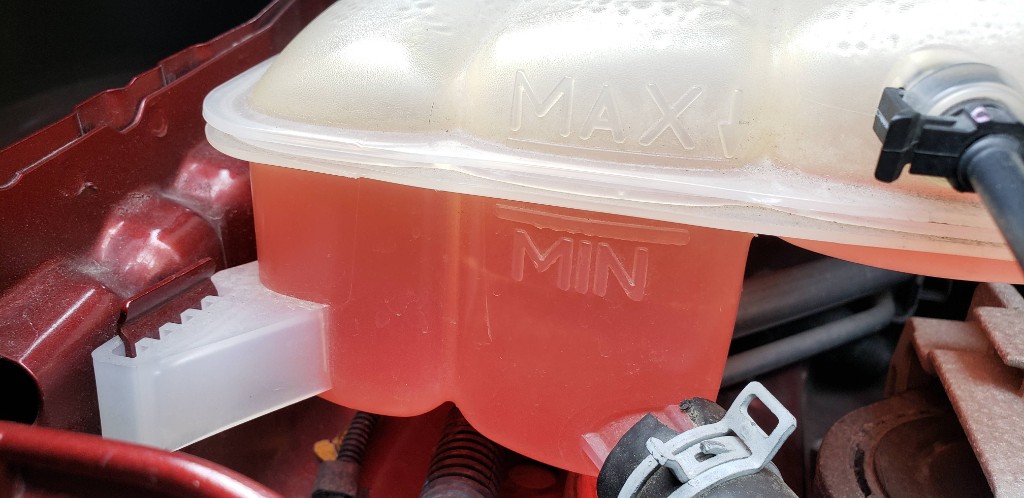

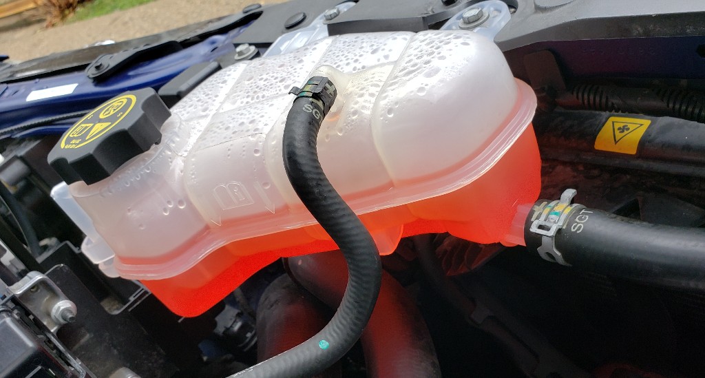

That is true in my experience with the two vehicles we own that have this coolant. The coolant starts out orange, but changes to a reddish/pinkish color over time. From what I gather, that is the result of the dye breaking down after all those heat cycles.
This is the Ford's "Motorcraft Orange" factory fill (which is essentially Dexcool) after almost 5 years.
Here's the Dexcool in my Sonic.
I have zero experience with the Toyota pink coolant, but from what I've seen in the pics the fresh stuff is a different shade than what I've seen Dexcool change into. No idea what that stuff looks like after some age compared to Dexcool.

Mine is definitely more pink than that, just compared it to a Toyota in person and it is a closer match to that.
