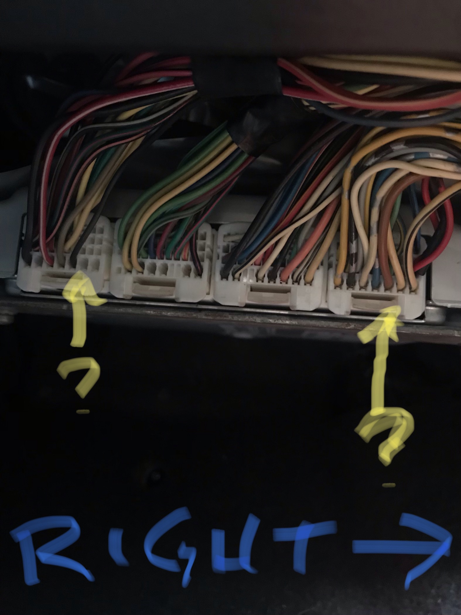

Yeah unfortunately that info doesn’t jive with what im seeing like i said. If im reading the plug/connector correctly, when it’s plugged into the computer the first pin is on the bottom left of the connector. Reading to the right five spaces gives me a brown wire.
If i look at the plug all the way to the LEFT I have a black in pin 5, but that gives me 6.6volts at about 800 rpm and maxes out at 7.3volts when rpms are increased. This is the only wire I can actually get some sort of change off from, however which makes me wonder if the “plug all the way to the right” doesn’t mean how it sits under the dash but rather with the label on the ECM facing up??
There’s another plug with a black pin 5 but that gives no signal I’m looking for.
I attached a pic to show what i have here.
Am I confused here or something?

Since only one black wire is in pin 5 on either direction, I would think that would be the one to use.

Did you get it figured out? I tapped into a black wire on the instrument cluster. The (incorrect) instructions I followed stated to connect to the leftmost black wire on the instrument cluster plug. That one didn't work but there was another black wire that did. forgive me for forgetting the position, and I didn't take pictures of the install.
