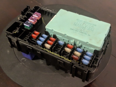

A lot of the relays in these cars are interchangeable, which can be a useful diagnostic, swap relays and see if the problem moves or stays, but unfortunately, the relays associated with the power door locks are not that type. They use something toyota calls an "integration relay", GM calls a m"multifunction module". Its a plastic box snapped into the bottom of the under dash fuse block. On mine, it's white, and is a toyota part, says relay integration on the box. I've never taken it out or apart, don't know if there's any easily replaceable parts inside.
Here's a pic I stole from an ebay listing for a pontiac vibe fuse box and integration relay. Mine's white, the one in this pic is a light blue color.
with a name of relay integration, or integration relay, I assume it has relays in it, and maybe one of those is causing the buzzing sound you're hearing. It could be a relay in that module, or it could be some signal from outside the box that is borderline or intermittent, causing the relay to cycle rapidly.
A replacement integration relay is more expensive than most of the other relays int he car, it would be nice to be able to positively troubleshoot it as the culprit before spending the money, but I'm not sure what to offer on how to test things and make sure

Thanks very much for the detailed reply! We pulled the relay integration module you described and discovered a short in the circuit board. Soldered the break, then popped the module back in place and it was fixed! Hopefully this will be a permanent repair now. Now if I could figure out a way to add a FOB to activate the power door locks! I don't think the base model ever came equipped with a FOB in that early generation (at least my car didn't)....but maybe that's asking too much and I should be content with the locks working again, albeit via the "manual" way I've always had to rely on... Ideas?
