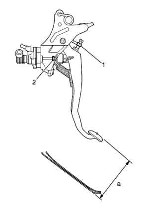

Since this is a hydraulic clutch, if an adjustment is needed, it is a good indication that something is bad with the system or worn out. That is why most people do not just adjust the clutch pedal. That being said, here is the procedure for the pedal adjustment.
Clutch Pedal Stop.jpg (22.36 KiB) Viewed 5485 times
1. Turn back the floor carpet.
2. Check that the pedal height is correct (a.
3. Loosen the lock nut and turn the stopper bolt (1) until the correct height is obtained.
4. Install the lock nut and tighten to 25 N·m (18 lb ft).

5. Check that pedal free play and push rod play are correct (a, b).
6. Depress the pedal until clutch resistance begins to be felt.
Specification
Pedal free play: 5.0 to 15.0 mm (0.197 to 0.591 in)
7. Gently depress the pedal until resistance begins to increase a little.
Specification
Push rod play at pedal top: 1.0 to 5.0 mm (0.039 to 0.197 in)
8. If necessary, adjust the pedal free play and push rod play.
9. Loosen the lock nut and turn the push rod until the correct free play and push rod play are
obtained.
10. Tighten the lock nut to 12 N·m (106 lb in).
11. After adjusting the pedal free play, check the pedal height.
