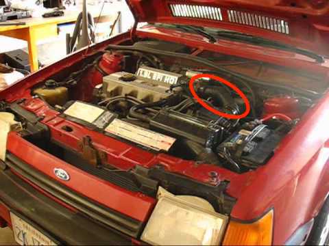

kostby
Posts: 2422
Re: P0171 turning into a witch hunt 07Vibe
Post by kostby »
OK. GenVibe somehow swallowed my original, much wordier post.
So here's the condensed version of what sounds like a similar problem from decades ago:
1988 1/2 Ford Escort GT, manual trans.
One winter it began driving very erratically. Started and ran fine at idle, but press the accelerator and it was either FULL THROTTLE, or none at all.
It drove OK on the highway, and most of my commute was highway, so I lived with it for a few weeks.
Engine computers weren't as sophisticated then, far fewer sensors, and far less diagnostic feedback.
Took the car to the dealer (under warranty) multiple times, but mechanic could never isolate and fix the problem.
Only showed a 'lean condition'.
After a couple of scary weeks, I parked the car at the dealership overnight, and told them to try it when cold the next morning.
Mechanic nearly crashed the car getting it out of the parking lot and into the service bay!
So that time, he kept looking!
It was an unseen tear on the underside of a molded seam of the 'hose' between the MAF (of that era) and the throttle body.
The tear admitted huge amounts of unmetered air into the intake when the throttle was pressed, causing a lean condition.
Throttle body compensated with much more fuel. Let off the throttle, tear closes, engine returns to idle.
On the highway, the tear and the air admitted was relatively constant, so the engine adjusted and ran reasonably well.
Bottom line: Have you checked the condition of the similar 'hose' on the Vibe?

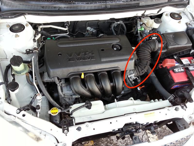

Excellent advise Kostby!
In Mazda 323 and Protégé that intake hose is cracking as well. To check it you take the hose out and bend it so it will show the cracks. They were always in the ribbed area. In my son's Protégé I fixed it with duct tape preventatively. Duct tape is a totally acceptable repair in this case.
However, I never heard of that in our engines. Nevertheless it bares checking.
If it is not the intake hose I would plug all the vacuum lines that go into that hose. It should run perfectly then. Then you can add one line after the other to find the conduit for the unmetered air.

Hi all. I apologize for the delay, I gave up a while back and just now got back to working on the vibe.
The intake hose did have some small cracks but nothing that looks anything like a tear going through the entire piece of rubber.
