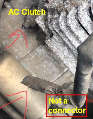

In prowling around some more, I noticed it looks like a broken wire on the AC motor? And maybe broken wires on alternator? On the alternator it’s like that bundle of wires is attached to the alternator but then just snipped off at the end?

In the picture, the stub of the wire sticking out from the one connector is for the AC compressor clutch. With that wire broken, you will never be able to turn on the AC. I mean, you can hit the button, but AC won't happen. That wire shown at the end your arrow is should be connected to the top arrow, there is only one wire in there. I don't see how that one wire being broken would pop the AM2 fuse. If the broken wire shorted to ground with the AC "on" it would take out the AC fuse, not the AM2
The other thing in your picture that looks like it could be an electrical connector is not a connector, it is just a mechanical piece of plastic that pushes on to a metal tab on the alternator, and is only there to provide an anchor/tie down point for the AC clutch wire

Oh and I also wanted to ask: is it possible to just splice a new wire onto the broken AC wire and get it going?

I would repair it and see what happens, and see if it looks as if someone cut it on purpose to disable the AC. Maybe the compressor was destroying itself internally and this was a quick fix to stop the noise... Just a theory.
