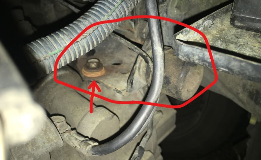

I think I am missing a bolt in this bracket/mount on the top of my transmission. It sits behind the battery. I am not sure what the bracket is called so I can't find out what hardware is missing. Does anyone know that this piece is called?

I think this is the right page in the parts catalog: http://www.japan-parts.eu/toyota/us/200 ... ing#12351A. Plug in your VIN to be sure.
It looks like the bracket at the bottom of the page, part number 12325-22200, and there are three bolts shown.
If a bolt has been missing for some time, you'll need to remove the mount and clean out the hole.

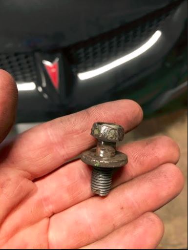

Thank you so much! I only had one of the 3 bolts in the bracket. It had worked its way about halfway out, and was showing some serious wear. Thanks for saving me from a serious problem later on.
Bolts: M10x1.25x22
