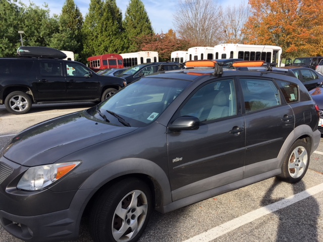

vibenvy wrote:Welcome to GenVibe! Congrats on the "new" Vibe! Post some pictures of it when you get a chance ;)!
Here's one I took after putting the rack on yesterday...
Got underneath to properly look around this morning (chasing a rattle described in another thread) and found a bit more rust / corrosion than I'd like to see (particularly on the lower ball joints and around the wheel bearing covers / control arm / sub frame - the passenger side dust shield was pretty much crumbling away as well). I decided to try and wire brush away as much as I could and get a couple coats of rattle can Rustoleum on it before the winter to try and offer a bit of protection (shielding the brake drum, of course). Maybe in the spring I'll try to replace the lower ball joints (castle nut looks pretty rough) and try to rust-bust a bit more thoroughly and get some proper undercoating on there.

Lookin' good!
