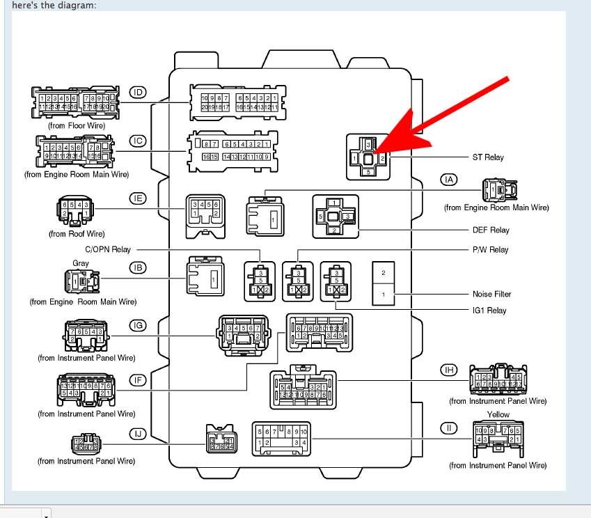

Hey all. So. . . i want to check my starter relay. I see this here diagram that shows it, but it makes no sense to me. I removed the little door to the left of the steering wheel and I see all the plugs and such - tons of them.
It seems to bear no resemblance whatsoever to this diagram which claims to be what I'm looking at. .
can anyone help? thanks!

Your picture appears to be a view of the back of the fuse panel where the wiring cables plug into the fuse panel. When you remove the cover, you are looking at the front of the fuse panel where all the fuses are. The relay is plugged into the back of the fuse panel from the information you have provided here.

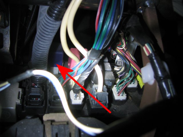

Might be easier to see if you pull the trim panel with the air outlet and mirror controls. Just stick you finger in the vent and pull.
In the diagram you posted, the right side of the diagram is towards the front of the car.
Here is a picture of my 03 through the hole when that vent and mirror control trim panel is removed. On mine , the starter relay is the blue one, marked by the red arrow.

Thank you Joatman! That was so easy! Woo hoo! And thank you Jolt! Ya'll are awesome!!!
