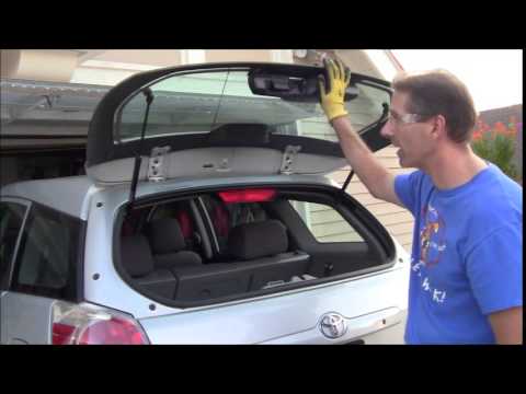

Hey all. anyone know what Torx screw size for removing hydraulic lifts / struts on rear hatch? My lifts don't hold up the hatch anymore and I need to replace them...but it's the torx (star) pattern..any idea what size. Also ...any other oddball torx sizes i may need to cover the repair? thank you
ps..yes i know the image is a matrix lol
