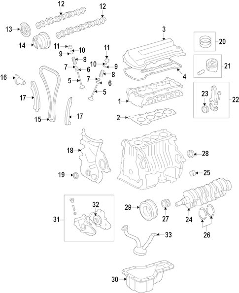

Here is what I am thinking: the estimate is for the replacement of the entire timing set. However, there is the possibility that only the tensioner is malfunctioning while the rest is in good shape. Look at the diagram: the entire timing set includes the parts 13, 14, 15, 16, 17 and a lot of stuff has to be removed to get to them. Of these 16 is the tensioner and it can be purchased and replaced separately and easily. There is a chance that this will cure your problem. If this does not work you can still replace the entire timing set.
Vibe 1.8L engine.jpg (53.77 KiB) Viewed 4022 times
I found this picture here: http://www.gmpartscenter.net/#
Find a mechanic that works with you. The Toyota service may not be willing to do this because they want to be sure the repair is perfect the first time. They do not want any come-backs. However you look at a huge savings if it works.
