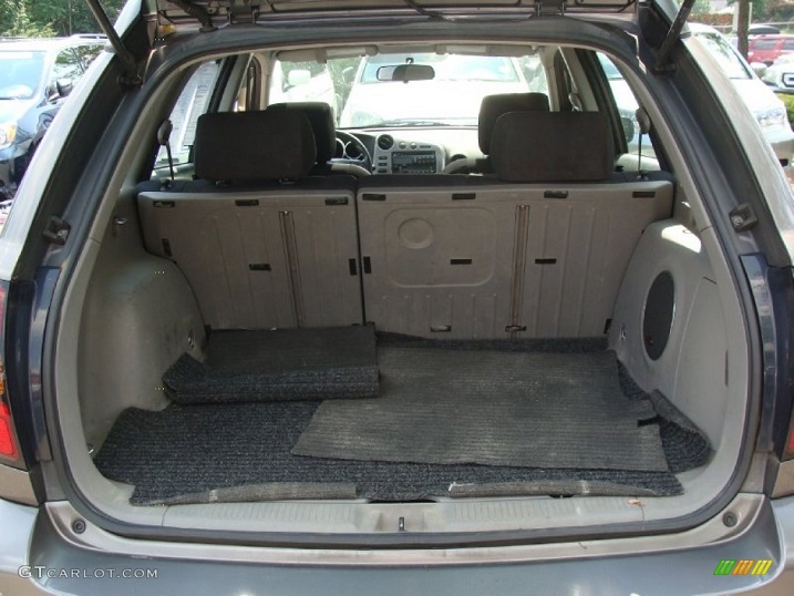

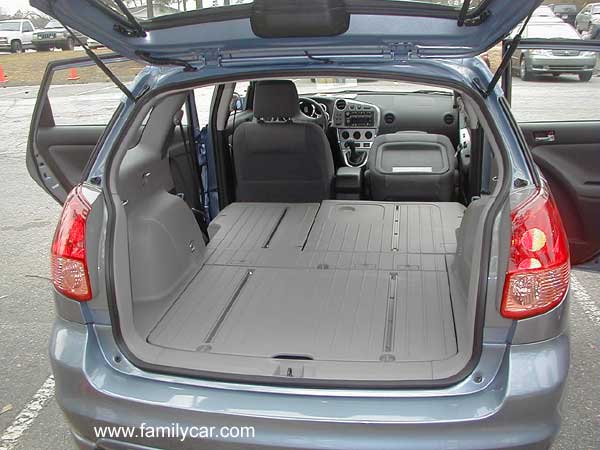

Consider securing the hatch with a cord through the window frame to the roof rack.
I cannot identify any difference between the Matrix hinges and the Vibe hinges when looking at pictures on google.
Matrix:
loadspace Matrix.jpg (40.21 KiB) Viewed 2660 times
Vibe:
Vibe cargo 2 small.jpg (121.67 KiB) Viewed 2660 times
