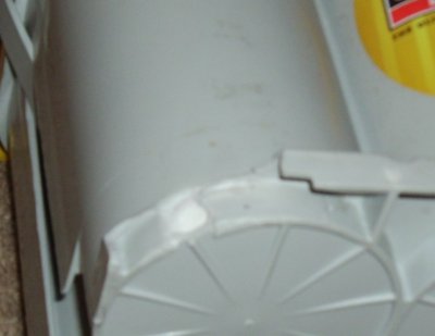

Ugh, Fedex ruined the battery. I missed the FedEx delivery on Friday, so had it held for pickup, which I did today. The box has big red and white stickers all over it saying "FRAGILE please handle with care" but... they didn't. They dropped it. 39lb "fragile" box and they dropped it. Looks like they slide it far on it's side too based on the box. The tape on the bottom is torn some too. The box has brass staples too though so it stayed sealed.
It had NO padding under the battery, only on the top. The battery's casing is so badly broken, you can see the AGM inside! :shock:
It was ordered from 4WheelParts but the packing slip says it was drop shipped. Doesn't matter since I ordered it through 4WheelParts, I can return it to a local store for exchange. I hope they have them in stock so I don't have to deal with another shipment that may end up damaged too.
Plus I need it within 10 days. If they can't do that, I guess I'll just return it and go get a Walmart (or Sears) battery after all. Ugh. That or go pay $50 more (than 4WP) at O'Reilly or AutoZone.
