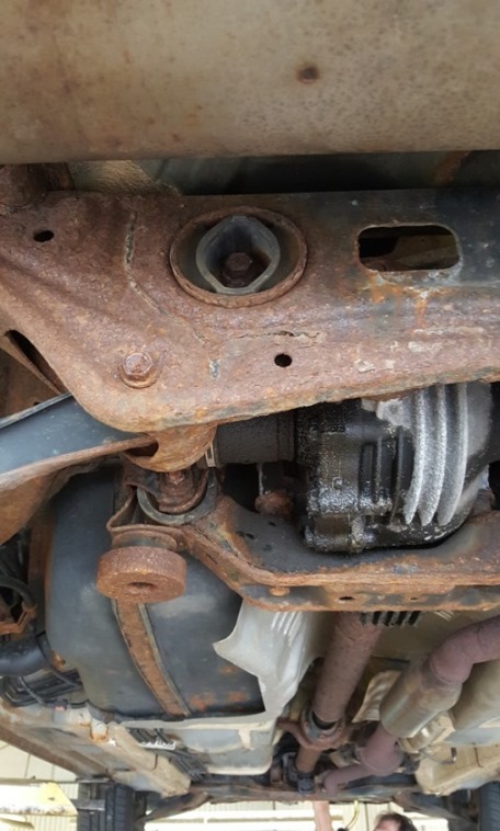

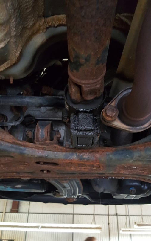

I didn't think that I could better with an AWD. I may have some remedy sine I paid for it with PayPal. I do have a lot of pictures of the undercarriage but I have 2 that I would like to post but, they won't load for some reason. I've reduced them down to 20% but they still won't load. Any suggestions?
Vibe Undercarriage1.jpg (100.51 KiB) Viewed 16138 times
Vibe Undercarriage2.jpg (99.52 KiB) Viewed 16138 times

Thanks Vibrolgist! I'm not sure what to look for in that link. On http://www.gmpartsdirect.com/auto-parts ... nsion-scat ,it looks like parts 88973231 Suspension Cross-member 88971294 Lower Control Arm, RIGHT and 88971295 Lower Control Arm. I actually took it into AAMCO to repair the transfercase leak and the pinion leak as indicated by the safety inspection.
They wouldn't touch it because they felt that if they unscrewed any of the bolts that the whole thing would break apart. So they just topped up the leaks for me and promised to top up the fluid every month. I may have another issue with moisture under the carpet both in the front and rear of the driver's side. I hate sunroofs for that reason, drain channel blockage may be the culprit. The vehicle drives well for the most part but doesn't idle as smoothly as I would like and choke is crazy at first start after hours of sitting.

Thats just enough rust in the wrong places. Removing the bolts would be hard enough, but having to knock the members loose could cause other damage.
Moisture under the carpet could be from a few other sources, blocked AC drain on passenger side, spilled beverages (the paddingacts like a sponge that almost never dries. Water that came in from the subframe, there is an open channel under the Vibe, water can get into the carpet even if it is not high enough to come over the door sill. Some have also reported that dealerships failed to install OEM plugs in the transport tie downs, this can also let water into the bottom of the vehicle.

But before you order something I suggest you find a body shop to have a look if the rust on the body itself needs repairs. I also suggest that the order is done through the body shop and that they specify "rust free" and good quality pictures of the assembly all before purchase. You have learned that you need to verify BEFORE a purchase.

I just hate to see an otherwise well maintained vehicle taken out by rust. In your case the repair is going to be more expensive due to replacing rusted parts.
Under the car, to slow down the rust you could use the following http://www.ebay.com/sch/i.html?_nkw=fluid+film two spray cans is usually enough to treat most of the underside and lines/mounts in the engine bay. You have to apply every year, usually in the fall. Over time the product will soak in, making it easier to remove rusted hardware. The only downside is needing to wear gloves to work on coated parts.

Have the body shop look at the bottom of the radiator support. If this piece is rusted out and needs replacing you are looking into a $3000 bill. If this piece is rusting but still in decent shape structurally I suggest you use the liquid film that Derf is talking about on that piece. Find or make an access hole so you can treat the inside of it.

tpollauf, thanks for your suggestion. My initial plan was to use Rust Check Rust Converter http://www.canadiantire.ca/en/pdp/rust- ... p.html#srp to arrest the progress of the rust. My next plan was to treat the rusted areas and then have Line X http://www.linex.com/ applied to the undercarriage and the floorpan.. Hopefully, that is a good idea. Derf, suggested a liquid to treat the rusted areas that I like even though I had originally considered Corroseal https://www.amazon.com/Corroseal-82331- ... +converter but I'm not comfortable doing the application myself but that may change. Both Krown https://www.krown.com/process/ and Rust Check http://www.rustcheck.com/what-is-coat-protect/ are headquartered in Ontario, Canada. I'm not against driving the vehicle to Rust Check in Mississauga if I have to, but Schomberg is a little too far even though Krown has a place Pennsylvania. All suggestions AND critiques are welcome.
Re: RUST!!!
Posted: Mon Nov 21, 2016 7:45 am
by vibrologist
Make sure you read all the details of these products.
Rust converters generally are acids. They do convert the rust at first, then they promote rust. I did not read all the details of the rust check rust converter. It's up to you to find out how it works chemically.
Liquid Film is available at some auto parts stores etc. That's a big plus in my books. So far I am aware of only 2 downsides: the need to wear gloves when working on parts that have been treated and the fact that they can weaken rubber that is not oil resistant. That means you have to be careful where you spray it. I suppose the rubber boots on ball joints are oil resistant because they contain the grease inside.
