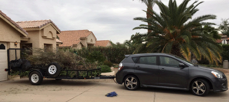

Well, I got it installed without a hitch. Er...the installation went smoothly. I did have to tap the holes but had no trouble doing it.The wiring to the battery took awhile, but I'm happy with the result.
Now I'm finally ready to start my own landscaping company! :D
