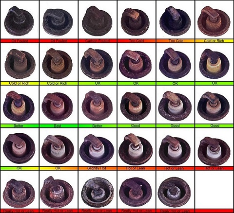

I think I would first have a look at the the spark plugs. The way they look can tell you a lot.
https://images.search.yahoo.com/images/ ... rt=mozilla

If you still have the old plugs could you post a picture of the electrodes?

vibrologist wrote:If you still have the old plugs could you post a picture of the electrodes?
I hear you on the Dart. http://www.curbsideclassic.com/curbside ... tal-mopar/
Image20160214_233115 by LodeCreative, on Flickr
Image20160214_233129 by LodeCreative, on Flickr
They don't look terrible (to me), but they are less than 6 months old.

Thanks for the pictures.
These plugs were running a little too hot. The insulators should not look white but slightly tan.
