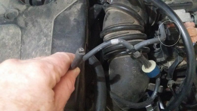

Was driving the other day and at some point when I let off the accelerator the engine continued to run at about 5K+. Got it home, turned it off and left it. Been sitting a few days and I just turned the key and it reved up just like as if I floored the gas pedal. Opened the hood just now to look to see what might be the problem and I notice these lines flopping around and wonder if that has something to do with it. The first pic shows a connection but nothing is attached. That may have been that way a while for all I know. The second show a hose with a broken connection but I can't find where that may have been attached to. Now I thought it may have been the spring at the connection of the throttle cable but that has tension and looks fine. Any ideas appreciated.

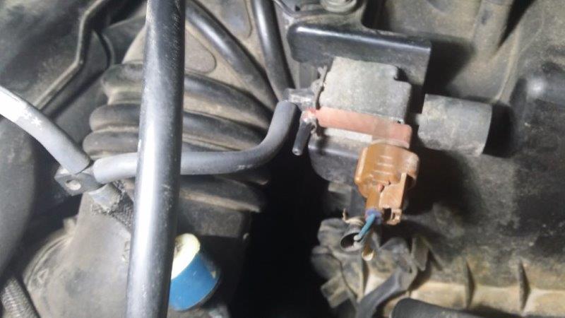

I snapped a pic of mine, and it looks like the end in your left hand goes to something under the intake ducting. There is another tube that goes from under the intake duct back to the open port on the solenoid.
I can remove the intake ducting and take a pic of the vacuum routing if you want.

Are you missing the diagram of your vacuum routing that's underneath your hood? Should be there and tell you exactly what goes where.
That vacuum switching valve with the exposed nipple, heheh, is for the airbox flapper. I can't recall the diagram/routing offhand, though. And, it's 115am, sooo.... :oops:

ImUrOBGYN wrote:Are you missing the diagram of your vacuum routing that's underneath your hood? Should be there and tell you exactly what goes where.
Ok. So I found the hose that attaches to the exposed "nipple". It was just lying disconnected. Probably knocked out by the NTB tech looking for stuff he could charge me for last month. The "mystery" hose with the broken nipple I see connects to the back of the airbox lid. Apparently the previous owner had applied a fix that failed.
Thanks for pointing out the hose diagram that was on the hood of the VIbe. I'd never even noticed that until you mentioned it!
When I get this back together I'll be surprised if this solves the idle issue. I'll look at the idle air control next, I guess. I will say that this occurred right after I attempted to see if "lift" was still working. So I had the engine running between 6-7k rpm. If that is any clue.
