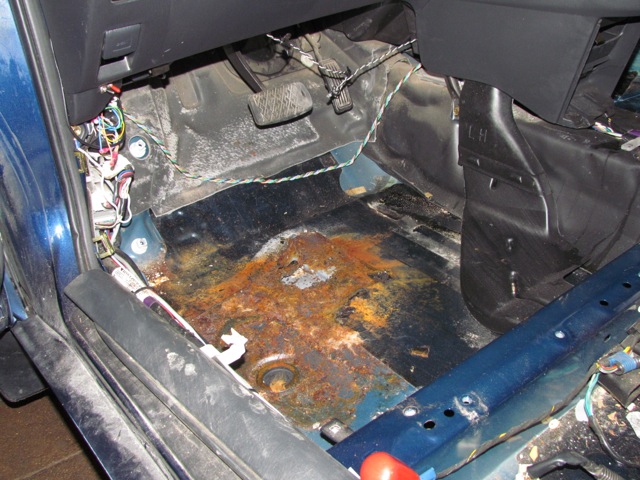

Today planned project took a big turn for the worse. Upon removing the interior to clean it, found the front driver floor board rusted through. The bottom sub frame is still intact.
The rust is the thin top metal floor board, the gray in the image is the sub frame / frame rail.
Not sure what do at this point, floor pans are probably the worst thing to work on, odd shapes, double layered, hard to stop rust. Guess I will remove what I can, put the driver seat back in and take it in for an estimate.
If the estimate comes comes back high, might JB weld a piece on top of the floor pan. Although welding would be better, I know it would burn off the protective finish and create a bigger rust mess down the road

I would like to weld a new piece in, the layered metal creates an issue. At the factory the Vibe frame was dipped to coat in between the various metal pieces. Once I weld on a new top piece, I would not be able to access the bare metal left from welding, creating a point between panels for rust. Welds in themselves promote rust due to tension and chemical changes left in the metal, which over time causes stress cracks in the finish. Once I get the rusted spot out, will have body shop give some repair ideas.
A great reminder to check under your flooring carpet, just because you take care of the vehicle, does not mean the previous owner did not leave a few surprises. Talking to the previous owner, appears this spot was likely caused by either spilled coffee or tea, with copious amounts of sugar. I can see the spill marks from the console to the driver area. Sunroof was not an issue, no other water damage found, drain lines are working fine. The carpet is dry on top, the factory padding under the carpet acted like a sponge, over the past few years it never totally dried, the sugar acted as a desiccant, soaking up moisture and keeping it against the metal floor. I am sure the Ohio Salt/Brine only added fuel to the fire. These new brine formulations especially with beet juice (sugar), stick to vehicles turning average rust into holes.

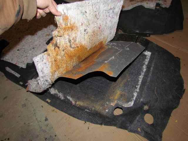

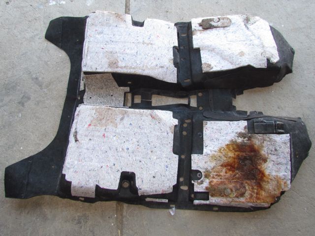

This is what the bottom of the carpet looked like once removed. Their were chunks of rust bonded to the carpet padding

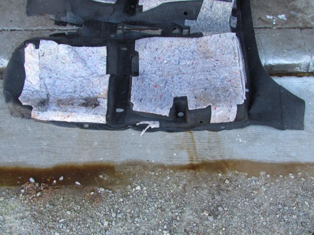

Upon pressure washing the carpet, the brown line at the bottom of the carpet was all the coffee/tea that came out. It truly looked like a tea party!
Before putting the carpet back in, going to get rid of all the OEM water absorbing padding, and replace it with encapsulated foam. It is a bit stiffer, does not hold moisture, and as a bonus is quieter!

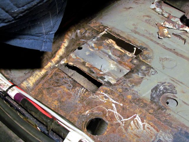

Cut out the worst of the floorboard, now have the Flintstone mobile

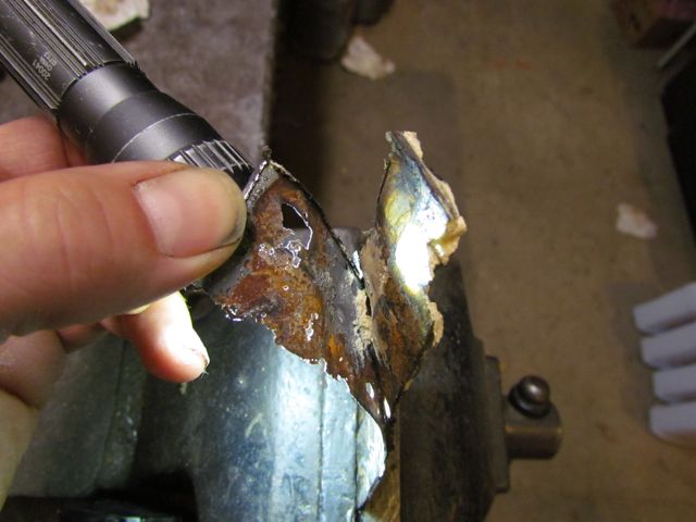

Checked with calipers, appears to be 20 gauage metal. Indications still point to rusting from top down. In this picture the exposed metal was facing the ground. I pulled back the undercoating to show the holes.
Working on way to treat the inside of the subframe before putting the floorpan over top. Thinking I will just make my own drain plug in the top.
Now to finalize plans. Getting two options, goo and pop rivet new oversize panel in place, or cut to size and weld. Both have drawbacks, any ideas or tips?

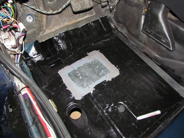

Talking around, for the given location, decided pop riveting would be the better option. Working the old metal appears their were a variety of factors at play.
-Spilled beverage collecting under carpeting, soaking into fiber padding creating a cycle of rust
-Undercoating that came free or did not seal the joint between the sub frame and floor pan.
-Bad spot weld that rusted through quickly
-Poor metal that was easy to rust
-Stamping that created thin spots in the floor pan

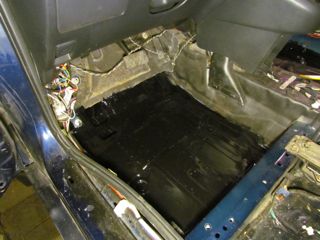

Picture of the patch in place, still have some clean up work and painting to complete.

Floor is finished.... now to reinstall the interior. Posted the repair video and updated notes in the original posting

Posted: Sun Nov 01, 2015 9:35 am
by Derf
Working on the carpeting, discovered they put a liner between the carpet and padding. This prevented earlier detection of the rust, plus once the water was in the padding kept it from evaporating. Good at keeping spills on top, but once spills travel below they get trapped.
