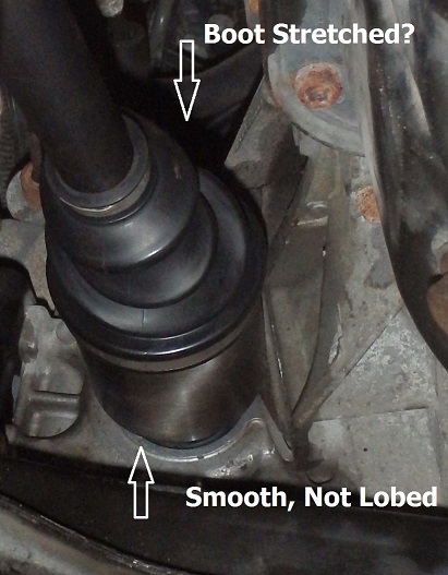

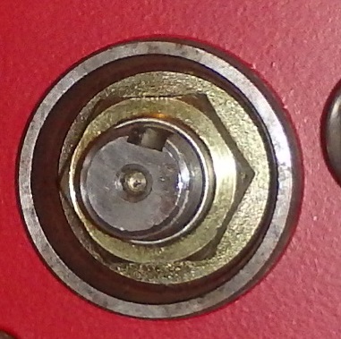

My old CV Axle had a 30mm star axle nut, and the inner boot was attached to a 3 lobed bearing cage (not sure if that's the correct term).
The replacement axle from O'Reilly has a 32mm hex axle nut and a smooth bearing cage.
I've installed it, but not reassembled everything because it seems like the inner boot is stretched a bit. Could be because I haven't tightened everything down and put the wheel back on and taken it off the jacks.

It doesn't seem right to me. Is your cat an auto? That may be a manual CV. Not sure if it matters, though.
EDIT:
I think that boot is too stretched and would replace it with a better brand.

Well, it failed. Search for "Scary Noise", got a replacement axle from O'Reillys under warantee, but it fits the same. I'm ordering another axle this time from Parts Geek. Anyone have experience/advise for where to get a better quality Axle?
