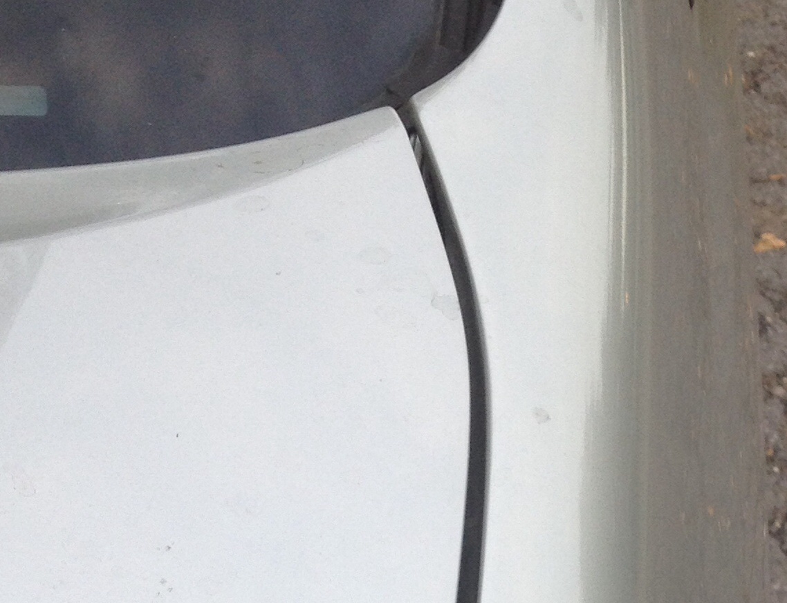

Thanks all! Have an appointment on Tuesday. Have photos and all documentation thus far, and calling my insurer in the AM. I'm so pissed off, what with the greenish fender and non-functional suspension..... Also, pics of the paint: pretty hard to tell in the photo, but it's definitely off....
The "new" paint job......can you see it?
