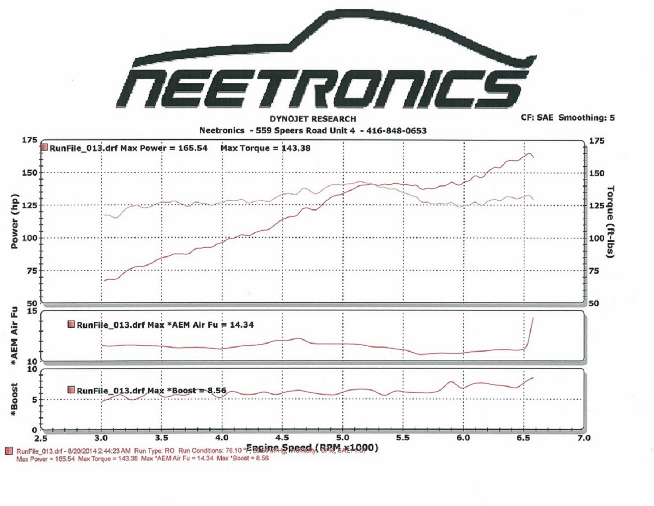

So tuning was done last week and it's been driving fine.
No the wideband was not hooked up to the EMU during tuning, we unplugged the stock O2 sensor, and he hooked up a boost line to the system he was using so he could have it for display/reference.
But a couple of things, he said no matter what he tried to do at WOT at below 3000 rpm it's actually too rich so he advised below 3000 only to do up to half-throttle and then I could floor it. He recommended to also get water/meth kit hooked up to help with my too rich problem.
Any remedies or other things I should add to help solve this problem so I can do WOT whenever I want?
And here's the final dyno btw
