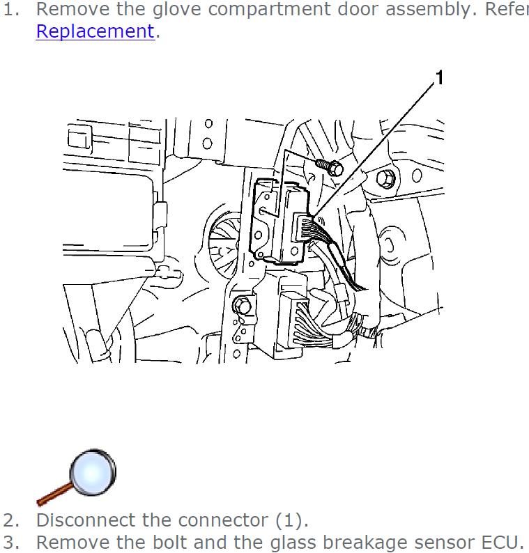

Here are two links that may help you or at least give you some info about the system and adjusting it if possible:
GLASS BREAKAGE SENSOR (GBS) OWNER’S GUIDE
http://www.toyota.com/t3Portal/document ... 0289-D.pdf
Adjustment for Toyota, which is what the Vibe basically is.
http://www.toyotanation.com/forum/61-2n ... tment.html
The module is behind the glove box. The right hand side top module with the smaller plug from the picture in my manual. You will need to unbolt and remove the module to find the adjustment hole from the info in the above link. My Vibe does not have this so I have no first hand knowledge about it. The system in the Vibe is a Toyota system so Google for more info about adjusting the glass breakage sensor. When noise is setting it off, it is most likely this system. You can do the test in the first link to check.
