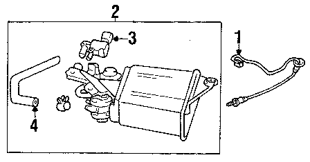

This link is to a pretty good troubleshooting guide for those sensors... too bad is not for the matrix/vibe.

I don't know what that diagram shows. Is it the heater core? We are talking about the heaters inside the HO2 sensors, not the heater for the cabin.
First check the harness connectors for the HO2 sensors. Pull them apart and inspect them for corrosion and stuff, reconnect them.

I realize an O2 sensor is an O2 sensor, but fuse# and location, pcm pinouts are probably not the same.
I'll just clear the code with my code reader.
One of the o2 wires threads into the body of the car from the passenger floor. This one looked clean when I did the interior of the car, but I can check it again.
I'm suspecting it's not an issue with the individual sensors.
The diagram is not of the heater core. That is the emissions system of the xrs. #2 is the vapor canister. #1 is the O2 sensor.

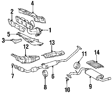

Ok, I welded the exhaust back together. The flange bolts have become fused with the little nut and when I hit it with the impact, exploded! That's OK, I just used new bolts and scraped off the remnants of the nut and used a new nut. I only had one donut and couldn't figure out if it was the top or the bottom gasket... the originals didn't look too too too bad, so I just sprayed them with cooper spray and clamped them back down. Not the best idea. It sounds better now, but at least the front one leaks still. Suck!
Does anyone know the fel-pro #'s for the two exhaust gaskets for the mid pipe? 03 GT.

So I don't smoke or have incense to make smoke, but it kinda looks and feels like the leak is chiming from under the exhaust manifold heat shield. There doesn't seem to be too much leaking from the donut by the cat.
Is making a tap tap tap sound as I accelerate from a stop. Does that sounds like manifold or the donut?
Is already much better, I'm thinking I'll leave it alone and move on to the heater circuit codes. At some point, I'll have to change all the exhaust gaskets.
