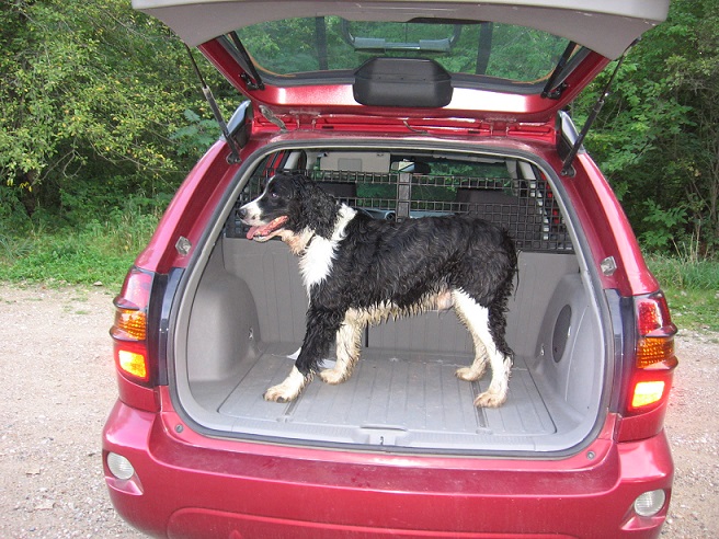

As first modification I made and installed a pet barrier to keep Yogi, the English Springer, in the trunk area. He was the reason why I looked for a wagon rather than a sedan. I was so close to buying a Kia Amanti but I could not imagine having the dog messing up the interior. The dog needs to be confined to his area for safety and cleanliness.
First I looked for a kennel and could not find one that would offer the correct size and convenience features. Then I looked for a universal fit pet barrier in the store and found nothing but junk for too much money. Finally, I found Vers-A-pad panels in a Theisen's farm supply store. I cut one to size and strapped it to the headrests of the rear seats. Bingo! it was cheap, about $20 + some straps. It looks great and is completely rattle free! The dog got used to it in only 2 trips to his favorite run-free areas.
Pontiac Vibe 048.JPG (95.49 KiB) Viewed 88908 times
You find the details here: viewtopic.php?f=28&t=43345" onclick="window.open(this.href);return false;

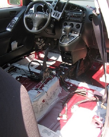

In July I completed the interior clean up and sound deadening. I pulled the carpet out and washed it with the garden hose, Bissell carpet and upholstery cleaner, a scrub brush and the Bissell wet vacuum cleaner. I am very happy with the results. There was a lot of dog hair in the carpet and the floor mats and sand everywhere. The waste water was black. I put more brush on sound deadener on the floor and after everything was dry I put it back together.
the grey material is sound deadener.

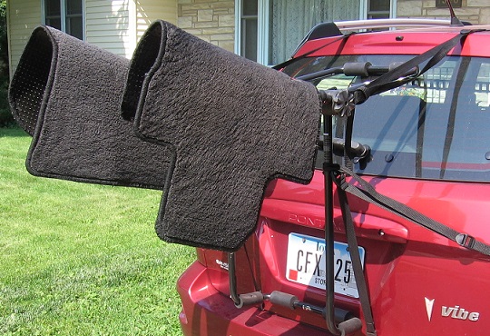

by vibrologist

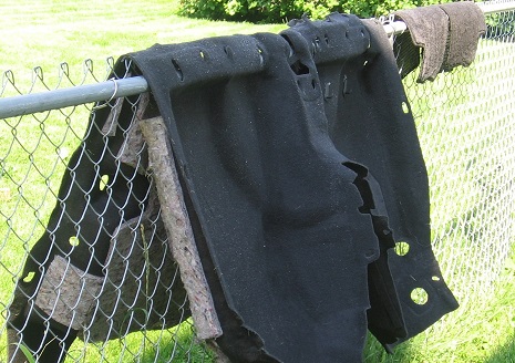

The carpet is hanging out to dry.
05 Vibe Carpet drying (2).jpg (99.17 KiB) Viewed 88848 times
Re: Vibrologist's '05 Vibe
Posted: Mon Aug 11, 2014 12:08 pm
by vibrologist
and the floor mats too:
05 Vibe floor mats drying.jpg (131.2 KiB) Viewed 88852 times

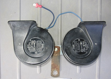

The original horn is too weak to demand respect. I replaced it with a FIAMM 2 tone set.
vibe 2-tone horn front (4).jpg (73.34 KiB) Viewed 88812 times

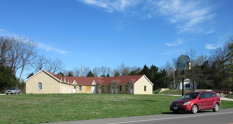

We made a labor day weekend trip to Kansas City.
This picture was taken on Norledge Avenue at the back side of the Kansas City Museum.
labor day trip to Kansas City 2014 005, cropped small.jpg (166.85 KiB) Viewed 88769 times

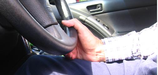

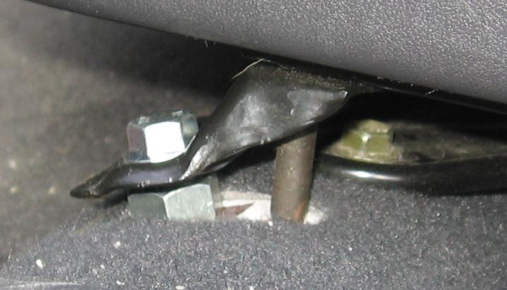

In an old Car and Driver article it was pointed out that the seat was 2" too low in respect to the steering wheel. This prompted me to try shimming the seat in order to achieve a more comfortable position. I purchased 2 bolts 10mmx1.25(fine)-40mm and 2 nuts 1/2-13. These nuts are too large for the bolts so the threads will not catch.
I loosened the bolts in the back and and removed the bolts at the front of the seat. I placed a nut under the seat bracket and inserted the new, longer bolt and tightened everything down.
This is how it looks like:
seat shim.jpg (53.15 KiB) Viewed 88689 times
You can see that the locating pin just behind the bolt is no longer in it's proper position. It could mean that in an accident the seat bolts may shear. I have to assume that a seat shimmed in this way is less safe than the properly mounted seat.
The result is a much more relaxed driving position because the hands can rest on the thighs while they hold the steering wheel:
Vibe after shimming the seat.jpg (32.87 KiB) Viewed 88689 times
Car and Driver exaggerated. Raising the seat by 10mm at the front is all it took. Not only is this more comfortable for the hands and arms,it also added 10mm in distance to the pedals. You cannot achieve the same effect by simply jacking up the seat with the lever. This will raise the rear of the seat and lower the front!

Thanks for the seat info. I bought two 50mm bolts and was able to put one nut and 3 washers under each seat bracket to raise the front of the seat in my 03 GT a good bit. It is now MUCH better. I don't feel like I'm sliding down under the dash as I drive! :lol:

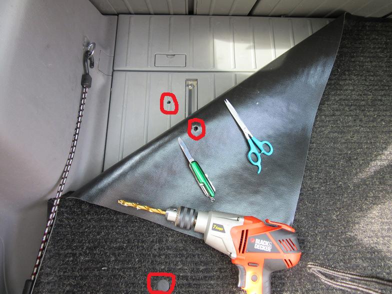

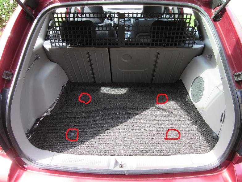

I copied nerdydaddyo's idea for adding a cargo mat that does not slide around. I bought a 3'x5' mat at Lowe's for about $15 and trimmed it with scissors to fit. I also bought 2 packs of 2 GM trim retainers for about $5. After lifting the cargo floor I drilled 4 holes of 3/8" diameter, laid down the mat and located each hole to make a matching hole through the mat. I pushed a retainer in each and was done.
cargo carpet job details.jpg (104.99 KiB) Viewed 87635 times
GM trim panel retainers.jpg (108.21 KiB) Viewed 87635 times
Now that's better:
cargo carpet and pet barrier.jpg (102.94 KiB) Viewed 87635 times

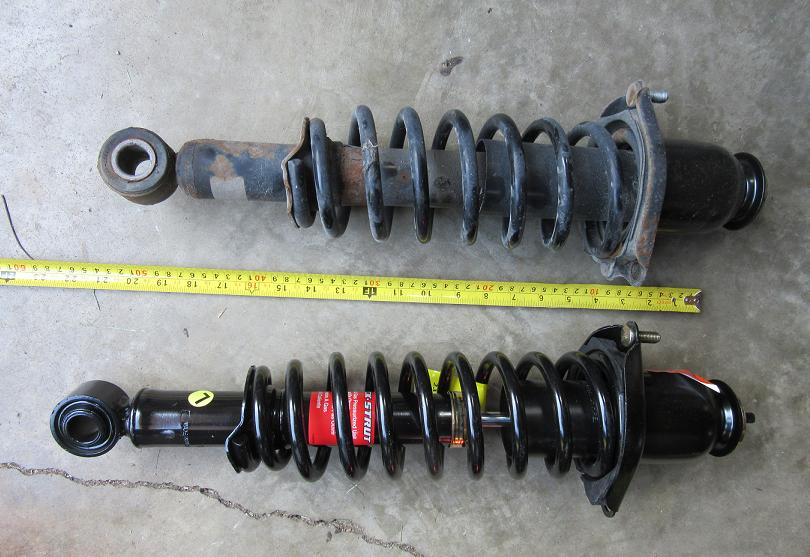

Recently my vibe received a new rear wiper, wash and wax, new spark plugs and -just today -a fresh fill of Toyota ATF T-IV. It needed it.
The old stuff came out black. The job was very easy because it does not require removing any splash guards. Everything is very accessible. I jacked up the car and supported it with 2 jack stands. I drained the fluid using the drain plug (14mm), then I removed the bolts (10mm) except for one in the front. That allowed more old fluid to drain as I turned the one bolt out a bit. Finally, I removed that as well. I hardly spilled a drop! I cleaned the magnets with a rag and the pan with a non chlorinated brake cleaner. Then I put it all back with a new pan gasket and tightened it down with a torque wrench (47inch-pound for the FWD Vibe). I filled in 3 and 1/2 qts of fresh type T-IV ATF. I drove it to warm up and checked the level. All is good. I will do a drain and fill again in a few weeks.
The Toyota dealer gave me 2 different gaskets to save me a way. I will return the other tomorrow.
old vs. new after at 107000 miles

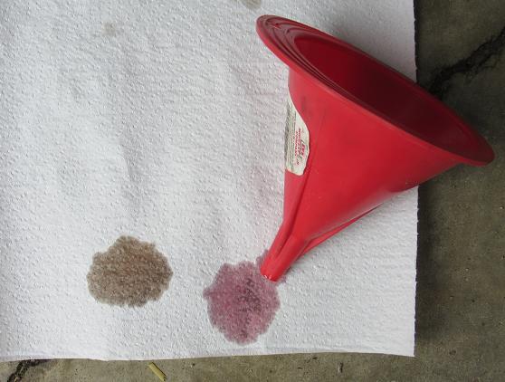

T-4 ATF, old and new.jpg (52.07 KiB) Viewed 87326 times

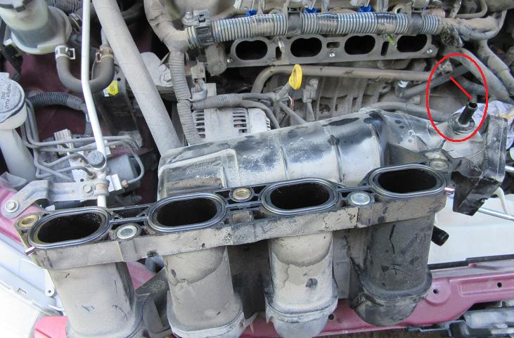

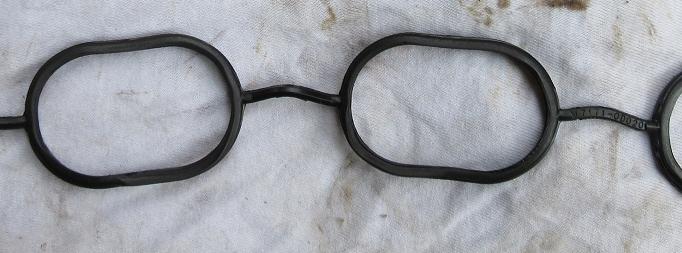

The Vibe recieved an new intake manifold gasket. Last winter I experienced some rough idle in really cold weather while the engine was warming up. It went away when the engine was at operating temperature. I got the gasket from Toyota and I expected it to be orange. It was black, though.
The old gasket was deformed. I am sure it leaked.
Intake manifold gasket.jpg (46.7 KiB) Viewed 87087 times
Here is the new gasket in it's channel. You see the intake with cleaned up mounting surface. In the red circle you see the brake booster hose and the nipple for it on the IM. I forgot to reconnect it on assembly. It makes for really rough idle, lousy brakes and a CEL.
clean intake and brake booster hose.jpg (89.05 KiB) Viewed 87087 times
I also cleaned the throttle body. I re-used the throttle body gasket as I could not get a new one today. I added a bit of blue sensor proof silicone.
The car idles smoother as a result of this maintenance.

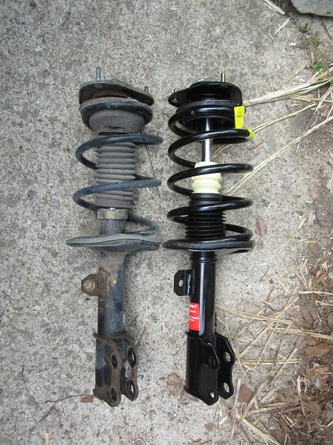

My Vibe received new struts. After much research I decided to get Monroe Quick-Struts for the Vibe. I wanted more comfort. The front Quick-Strut's spring has 5-1/2 turns compared to 4-1/2 turns of the old strut. The rear Quick-Strut's spring has 10 turns compared to 8 turns of the old strut. The rear struts are 1-1/2" taller than the old ones. They will settle. The first driving impression is that these struts ride less harsh than the originals. I still call them short of comfortable. I expect some softening will still occur.
front old and new
front old and new
New Quick-Struts (3).JPG (101.31 KiB) Viewed 86122 times
rear old and new
rear old and new
New Quick-Struts.JPG (90.74 KiB) Viewed 86122 times

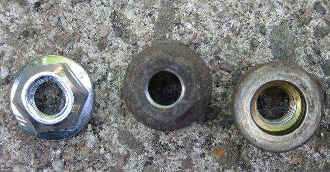

There have been reports that the studs of the front Quick-Struts are braking way before the specified torque has been achieved. I had a close look at the new nuts in the package and found them severely ovalized. Tightening these nuts will twist the studs. Apparently this twisting is too much for them. I used the old nuts that looked much better designed.
new ovalized nut and 2 original nuts
New Quick-Struts (2).JPG (81.15 KiB) Viewed 86122 times
The job was not too hard. It took me 3 hours for the rears and only 90 minutes for the fronts. The car runs straight but I will have the alignment checked anyway.
Posted: Fri May 27, 2016 6:00 am
by lannvouivre
Ew, look at those nuts. (removed) were they thinking? Why didn't they do the OEM design?
Posted: Fri May 27, 2016 6:27 am
by vibrologist
lannvouivre wrote:Ew, look at those nuts. (removed) were they thinking? Why didn't they do the OEM design?
Ovalized nuts are self- locking. In principle it is not a bad idea. But the amount of squeeze has to be just right.
Posted: Fri May 27, 2016 7:00 am
by lannvouivre
I prefer the nylon insert ones, but I've also never seen anyone but Monroe used locking nuts on the strut mounts.
Posted: Fri May 27, 2016 7:09 am
by vibrologist
Agreed. Nylon does the job better. When you tighten an ovalized nut you won't know where the torque was going to: is it friction and twisting the stud or is it stretching the stud? Ideally you only want stretching force in the stud. With nylon you get a little friction and mostly stretch of the stud.

Great pics the Vibe is a awesome lil car 8-) Question....did you have to remove ALL the hatch panels to access the top mounting bolts for the rear struts ? Did you discover any shortcuts ? I just did my fronts struts and ready to install the rears, I THOUGHT there was a access panel for the top mount bolts to find there are none...after that I said to myself MEHHH...i will wait till fall to do it :lol: I hate to do that because I dont like unfinished projects. After replacing headlight lenses, inner/outer tie rods, sway bar links, serpentine belt, AC compressor & dryer receiver Im MORE than ready to put down the tools for a couple of months. What a improvement after new struts though, and I installed cheapies :lol:
Posted: Fri May 27, 2016 8:28 am
by vibrologist
I removed all the panels. It's really not that much. There are small tabs but they give you only access to the central nut of the struts. The ones you suppose not to touch anyway.
Remove (4) 10mm hex bolts for the D-rings on each side. Fold the backseats forward, wiggle the panels out.
Remove the cover of the narrow tray. Remove the child seat anchors and hinge bolts (14mm, I think). Remove the cargo floor, remove the narrow tray.
Under the car, in front of the spare wheel well there is a pylon shaped lift point. Block the front wheels, loosen the rear wheel lug nuts and lift the rear of the car at that pylon. Put jack stands under the lift points in front of the rear wheels.
Don't miss the chance to check the spare wheel tire pressure.
