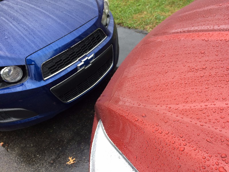

I've read quite a bit about Collinite 845 over the years but never tried it until this spring. Wow - wish I would have started using it years ago!
The Vibe's paint is long gone, so it (or anything else) doesn't do a lot of good there. But on the other two with good paint, it's been amazing. Easy to put on, easy to take off, and it lasts and lasts...
Both the Sonic and Escape are ready for their first winters with Collinite 845. Looking forward to seeing how things turn out!
- rain.jpg (165.82 KiB) Viewed 90143 times
