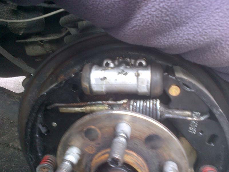

Well, I had the cylinders installed. The good thing about it is that the old cylinders had the same part numbers on their rubbers as the new ones. Also, the "Aisin" printing was also on both old and new cylinders. They were both identical. That made me feel more relaxed. :D

I am glad that I got what I was looking for the right price! :D

Oh god you did that outside? You are the man!

Salsa Guy wrote:Oh god you did that outside? You are the man!
;) The garage is in the back of the Vibe. I had it full with my cousin's K24 engine and transmission and his 98 Civic ready for a swap.. My cousin and I installed them cylinders in about one hour. I needed my brakes asap!
