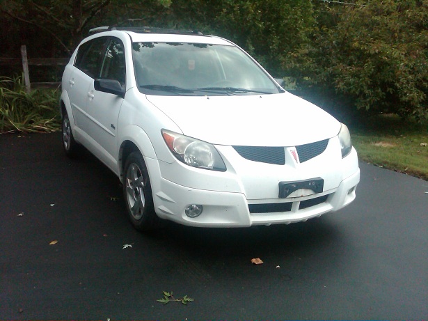

The transplant patient.
Ghost of Dirk1.jpg (93.08 KiB) Viewed 36751 times

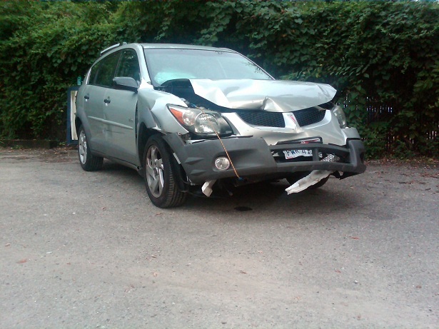

The donor car.
The donor car.
Dirk the Doner1.jpg (113.96 KiB) Viewed 36751 times
Thanks all! So far I have begun the process of taking the donor car apart. Unfortunately the photos of my progress didn't come out. But here are two pictures of the donor and the new car.
