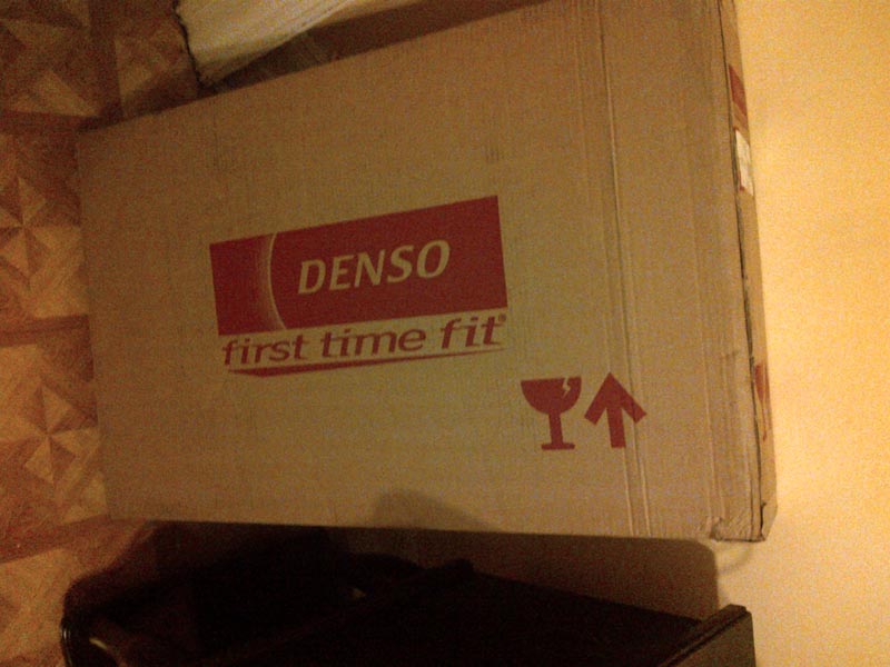

Great Joatmon. Thank you for the piece of advice. I am going for the DENSO 221-0514 ($58.50 on eBay). Denso makes radiators for Honda. I think that is a good choice. I will keep you updated!
Re: I Need to Replace My Radiator,Which is The Best Replacem
Posted: Mon Jul 01, 2013 5:08 pm
by Reaccion
I got my radiator in the mail today. I can not wait to put it on already.
