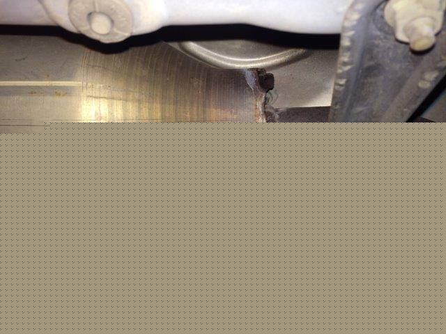

the exhaust popped off the cat and i'm looking for options. any suggestions. I'm looking to spend around $200 total. Thanks!
