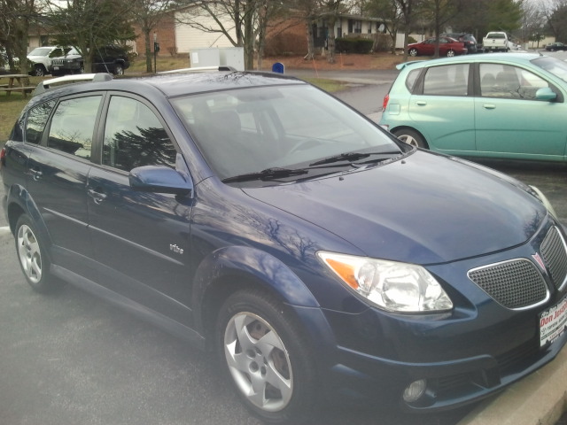

Hi again!
Here's my VIBE in all his glory. I haven't had the chance to take more photos yet. (It's too cold and rainy here!!)
2013-01-12 16.35.27.jpg (99.78 KiB) Viewed 2912 times
I have an automatic transmission, manual windows and locks. I'm not sure if it's front or rear wheel drive, but I also don't know if that's important or not? It has overdrive. It's really a very basic model from what I understand, since I have the CD/radio combo and that's the most advanced tech in the car. I'm getting (unless my math is incorrect) 21mpg thereabouts, it seems. I travel 54 miles per day, round trip, four times a week to and from school. Add in the 20 miles or so around town daily, and that brings me to a total of 74 miles per day, four days a week. That's 296 miles in four days. The weekends are easier on me, at maybe 30 for the three days in my weekend. That is about 326 miles in one week. Gas is ABOUT 3.84 a gallon (2/28/13 3pm ish) So, is my math wrong? Or do I just drive a ton?

Nice Neptune blue Vibe, and welcome to the club! Winter in Kent, OH, so you won't be getting great MPG with any car. Don't know how much snow you've been driving on, or what kind of tires you have, or your driving style.
Automatic Vibes normally get 30 to 35 MPG in Summer conditions. Your car is front wheel drive... something that will come in pretty handy in snow. Try to do all the normal checks to optimize your gas mileage, after all even without many miles on the car, it's still 7 years old.
