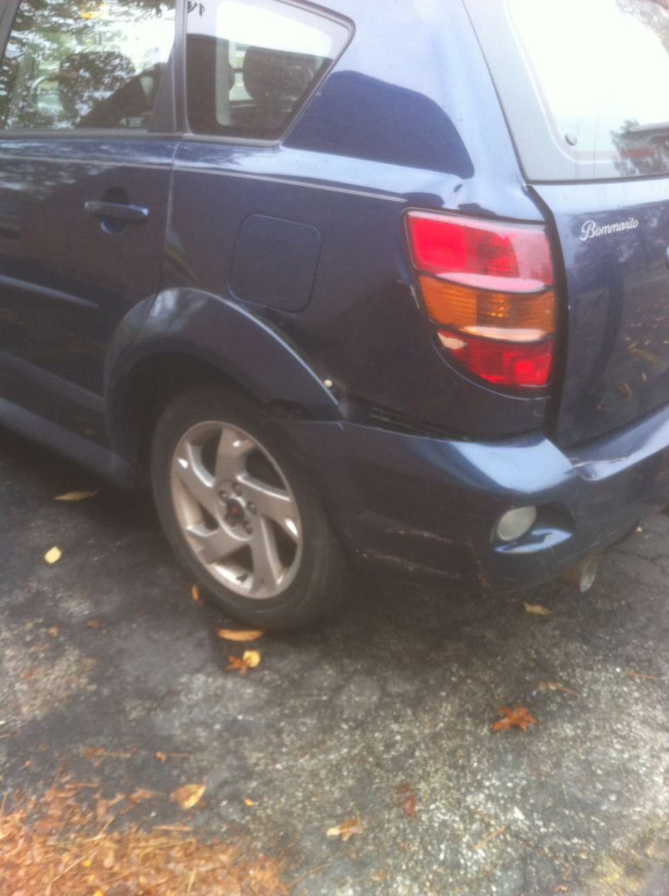

I've attached photos. Thanks for the replies. I took it to have a shop look at the car - They would work directly with the insurance company - said they'd need the care at least 2 weeks. I'm hoping they don't total the car, but I'm not sure.
IMG_1333 small.jpg (82.26 KiB) Viewed 5161 times
IMG_1332 small.jpg (87.58 KiB) Viewed 5161 times

mbergen wrote:I've attached photos. Thanks for the replies. I took it to have a shop look at the car - They would work directly with the insurance company - said they'd need the care at least 2 weeks. I'm hoping they don't total the car, but I'm not sure.
Since it and the brand have discontinued, they probably will.

Seeing as the car is most likely 5 yrs old or older, since you didn't say what year it is, they will probably total it out if it does have too much damage. But if they do, since it drives just fine and if you want to keep it, you can buy the car back from the insurance company (usually for 10-20% of the value) and have it repaired by your shop. Hopefully it is paid off and then you can just use the insurance check to pay for the repairs. Hopefully that would cover it. I know a couple of people that have done this and it worked out for them, but you do get a salvage title so you take a loss when you sell it later on.

Thanks - the mechanic looked at the car and thinks they will total it. $7500 to fix. I'll have to make a decision on what to do. Really too bad - I like my car.

Yep it's totaled. They are taking it away tomorrow. I ended up buying another used ford escape on Sat.. I'll be sorry to see it go, but decided to go something different, since it's been 6 years and I felt like a change since I had decided to get a different car. The mechanic said frame damage, so I didn't really feel safe continuing to drive it. Strangely enough, after I got it back from the mechanics, the door ajar light was off.
