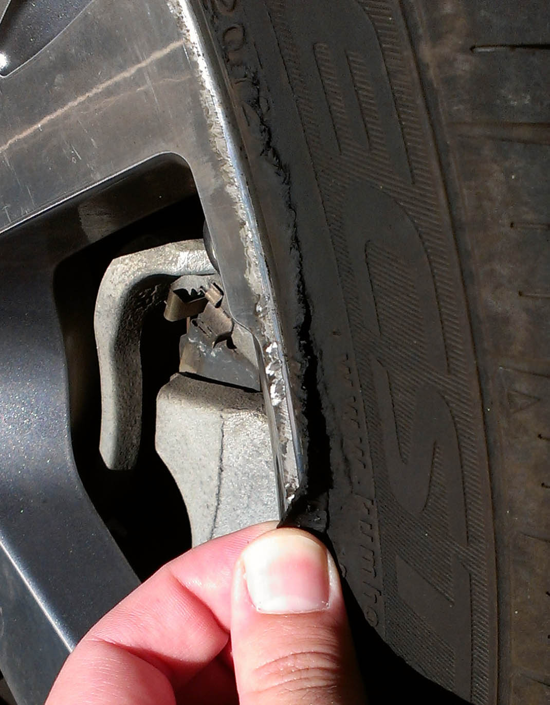

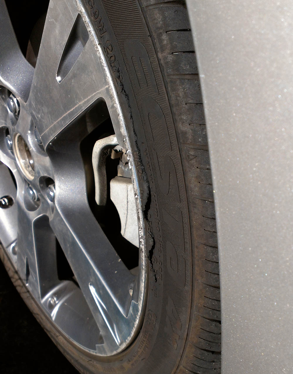

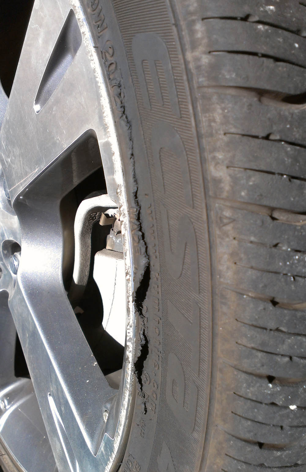

My wife ran the front tire up against the curb the other day and I'm trying to decide if this is a serious gash or not.
I've never had low-profile tires before, so I'm not really sure if that changes things.
I've attached some pictures. The actual thickness of the rubber that's coming apart from the edge seems pretty thin to me, but I'm not experienced with tire damage. I can probably get a better shot of under the flap if that would help.
The tires are newish (probably 2,500 mi at most) and have a road hazard warranty on them from Sears, but if I'm not even sure if that covers this and I'd like to avoid the hassle if it's just cosmetic.

Tires are safety critical. Don't risk what you can't afford to lose.
That being said it might be fine or it might be unsafe, its hard to know from the picture. If you decide to keep using it then it might be prudent to rotate it to a rear spot. A front tire blowout can be a lot worse than a rear one.

Personally, I'd take it back to Sears and see what they have to say. As joatmon said, it's not worth getting in an accident over.

That pic doesn't look serious at all to me, but I agree it is wise to take it to a shop for an opinion. If the tire guy said it was dangerous, I'd probably take it to another shop for a second, or even third opinion. Difficult to trust a shop that stands to benefit by selling you a tire.

Well, you've got your Road Hazard, and you have some kind of side wall damage. I'd go in there and tell them you hit something on the road (and not mention that it was the curb ;) ) and ask them if the tire is still safe. If they jump at the chance to tell you the tire has to be replaced, *then* I would mention the Road Hazard coverage. Your tires are almost new, if I read correctly, so Sears should still be able to get the exact tire, after 2500 miles your wear should not be significant enough that one new tire would cause a problem (altho I'd put the new one on the read for the next 5000 mi or so).

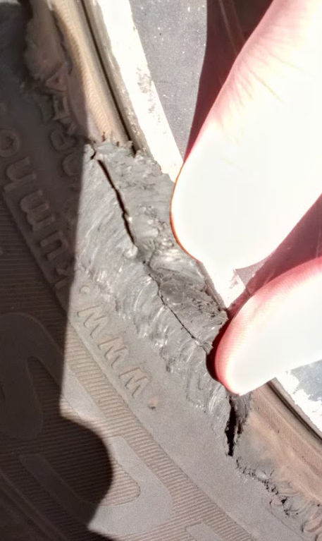

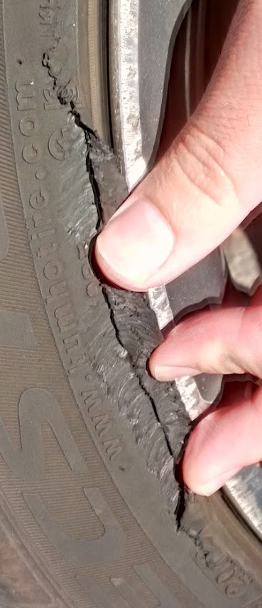

I did get some better pictures of how deep the cut went:

I've worked as an aftermarket wheel and tire product developement tech and also in a high end specialty wheel and tire shop. Any cut in the sidewall ofa tire is dangerous. The sidewall of a passenger car tire is only one or maybe two plys of nylon or polyester cloth and a thin layer of rubber on each side. Looks like you have cut through the rubber and abraded the cords. One good impact or sudden flex of the tire cornering at that spot could cause the sidewall to blow out or even zipper without warning. In addition in many states/prov. it is illegal to drive with a tire with a damaged sidewall.
Based on years of experience dealing with damaged wheels and tires if there is a road hazzard warranty I do see any issue why they wouldn't honor a claim for this tire.

Thanks for all the advice, guys! I did take it into Sears and they said they couldn't see the cords or anything - just a cosmetic thing.
I think I'm going to get a second opinion anyways just for safety's sake. Thanks again for all the feedback!
