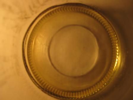

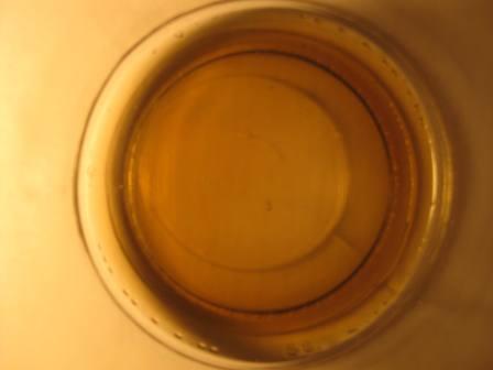

by biodieselrabbit
Thought others might appreciate this little comparative view. Note that the lines are due to the jar I placed the fluid in, not something in the fluid itself.
Brand new manual transmission fluid (Valvoline 75W-90 GL5)

Same fluid after being in the transmission for approximately 4,000 miles of a mix of city/highway driving. Slightly darker in color. Seems to be one or two blackish specks in it which you cannot see from the picture.
TransmissionFluid 005.jpg (13.47 KiB) Viewed 15912 times

Just to clarify, the two pictures are the same fluid (Valvoline 75W-90) before and after being in my transmission. I couldn't say whether the Redline MT-90 is a different color but it definitely seemed to be thinner (i.e. less viscous) than the Valvoline stuff.
