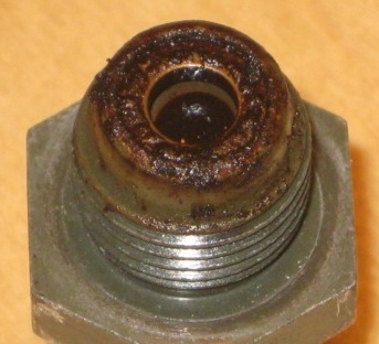

Just replaced mine today. Bought a used 2003 Vibe a couple months ago with around 150,000 miles on it and figured the PCV valve had never been replaced ... or thought about for that matter. Below is a picture of the grimy old one for reference.
PCVvalve 001.jpg (36.84 KiB) Viewed 9925 times

It has been nearly a month now since I replaced my PCV valve. I have not observed any noticeable difference in idling quality or fuel economy but as others have said, my old one still moved back and forth when shook. Figure I will replace it again in another 150,000 miles, probably sooner since it was so easy.
