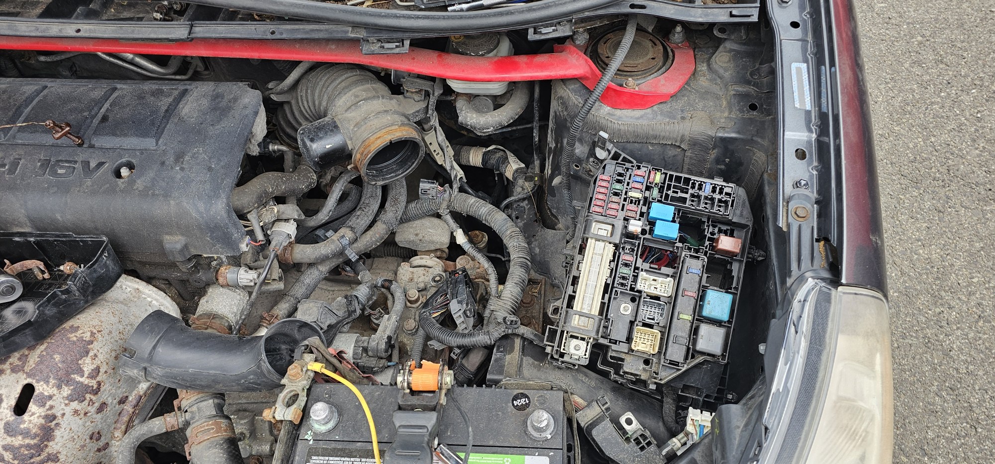

The AC and blower fan stopped working on my vibe.
The first thing I thought to try was the fusible link block. This part contains a 50 amp fuse for the hvac circuit. I thought that replacing this may energize the AC controls. this ended up not working. My blower fan controls and AC still wouldn't turn on. To be specific, not only does the blower fan control not work but also the indicator light on the AC control doesn't illuminate when pressed. The two switches appear to not be receiving power. The left most switch is mechanical only. It controls the flaps the redirect air.
20250601_151847 (1).jpg (695.05 KiB) Viewed 36440 times
Whelp. That was a bug waste of time and $35
on the fusible link block wasted..
My second try was replacing the blower control switch in the center console. What a peice of cake this one was. This popped into the dash in under 10 minuets.
My AC is now fixed!! Yay! Replacing this single center switch also restored power to the right AC switch.. I was then able to turn on AC.
So the culprit has been found. The AC blower switch was $30 used on ebay. Only the center switch was replaced.
One thing I forgot: its probably a good idea to disconnect the battery when changing this. The light indicator to the passenger airbag scale is connected to the front panel and needs to be unplugged. Since this is connected to the airbag circuit its probably a good idea to disconnect the battery. I forgot this! Luckily my airbags didnt go off.. :shock:
Im glad about this as I just had the AC recharged two years ago.. but that one i didnt diy. It still blows nice cold AC.
I'll need it this summer :D

Heres some other fun stuff as I'm bored. It seems like I'm always fixing stuff lately. I own a rather cool hot rod. This is a 1995 nissan 300zx twin turbo with manual transmission. Ive had this car for a long time. I bought it before my vibe.. I want to say I purchased this nissan in 2004.. this car is super clean and I try to keep it that way. Right now it has about 74k miles.
I pulled the exhaust out for some work. It was kinda too loud so I made some tweaks. It sounds awesome now. Not too loud. Aside from that exhaust system its essentially stock. Its fun. We take it for weekend getaways. ;)
Lasty, my lawn mower is broken. The engine doesnt crank and it immediately blows fuses whenever I attempt to start the engine. The cause? I'm not entierly sure but its likely there is a short within the electrical system. The problem is, I thoroughly looked over its wiring harness and can't find any defects. It is my hope that this $15 mower blade engagement switch is the culprit. The clue? This was the last control I touched on the mower before its malfunction started. I'll find out soon if that's the fix. I hope this fixes it as my yard is beginning to look like Jumanji.
