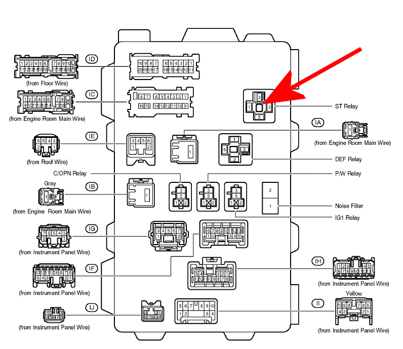

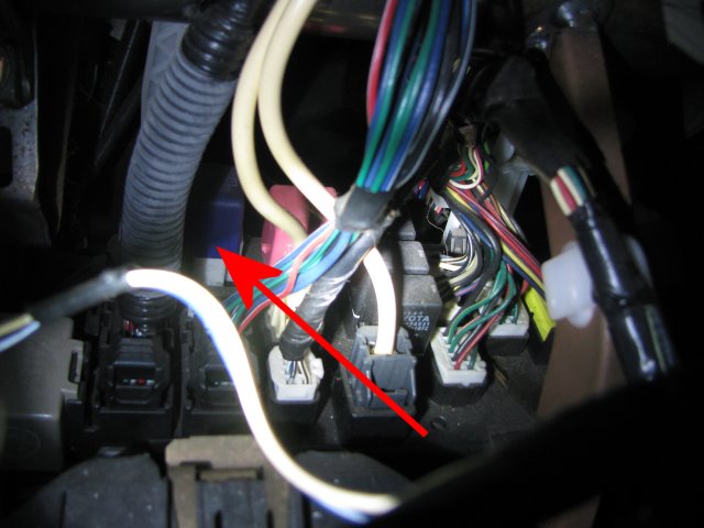

The starter relay in on the top side of the under dash fuse block, you should be able to access it by pulling out that small storage bin left of the steering wheel (below the mirror/dimmer control)
- starterrelay.gif (44.86 KiB) Viewed 1572 times
- starterrelay.jpg (49.61 KiB) Viewed 1572 times
