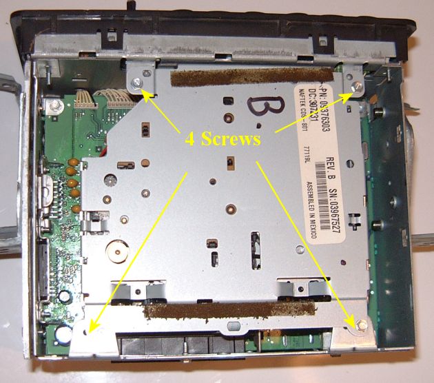

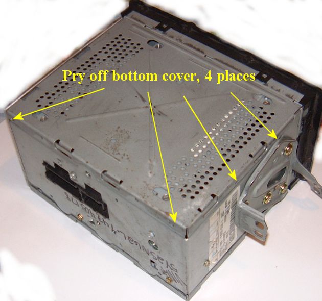

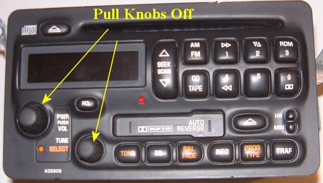

Noticed pics disappeared, so editing these posts to reupload them
Re: Radio lights going out (joatmon)
Posted: Mon Jun 02, 2008 9:08 am
by joatmon
Next you have to pry off the bottom cover. There are four places where you have to budge the cover over a bump. The one on the side closest to the front can be harder because of the mounting bracket.

I have a CD/Cassette unit from a Matrix, you probably don't, so for you this step doesn't apply, but for me, I had to remove four screws to move the cassette deck out of the way. I've taken apart a Vibe cd unit (no tape deck, and the rest applies

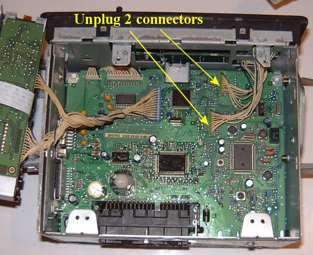

There are two wire bundles that connect the face plate to the motherboard. Remove these two by gently pulling up the wires to remove the connectors from the motherboard.The connectors are different sizes, so you can't get them crossed when you put it back together. You can see in the picture that there are two holes in the chassis front, one wire bundle comes through each hole. When you put it back together, it will be obvious which goes through which(since mine is a CD/tape, there are other wires in there, but for the Vibe's 1CD unit, there are just the two marked wire bundles)

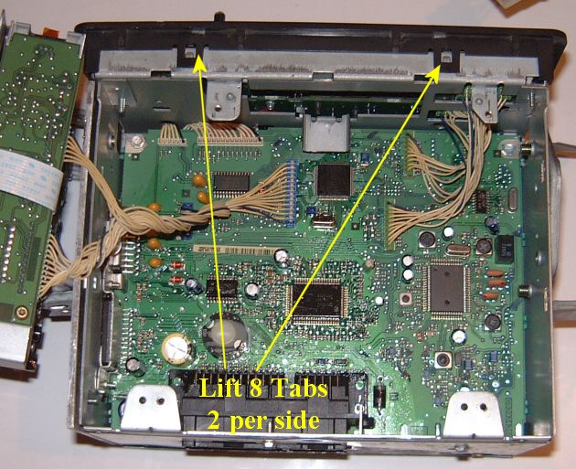

The face plate is attached to the main chassis by eight clips, Two on each side. To separate the faceplate from the chassis, you have to gently pry one a little while pulling the face plate gently, then move on to the next tab, work your way around as you inch the tabs over the bumps, sooner (or later) you'll get all 8 freed up at the same time and can pull the face plate off. You definitely want to be careful prying the tabs, you do not want to break them. Just lift them a little, while pulling on the face plate. I guess you might be able to use eight toothpicks or some such thing, wedge one under each clip, but I didn't do that

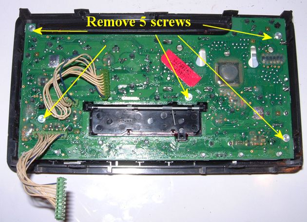

The face plate is a plastic cover and a circuit board. There are five small screws on the back of the circuit board that hold the two parts together. Remove the five screws, but when you go to separate the two, have the face plate down, or else all the buttons will fall out of the face plate.
Posted: Mon Jun 02, 2008 9:16 am
by joatmon

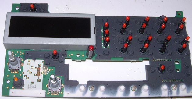

This shows the front of the circuit board with the cover removed. You can see all the lights for each of the buttons, but the LCD backlights are still hidden behind the LCD. (On mine a couple of the little white bulbs along the bottom row are burned out, but I'm not sure what bulb to put in there.)

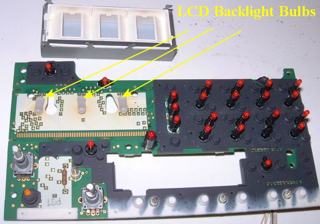

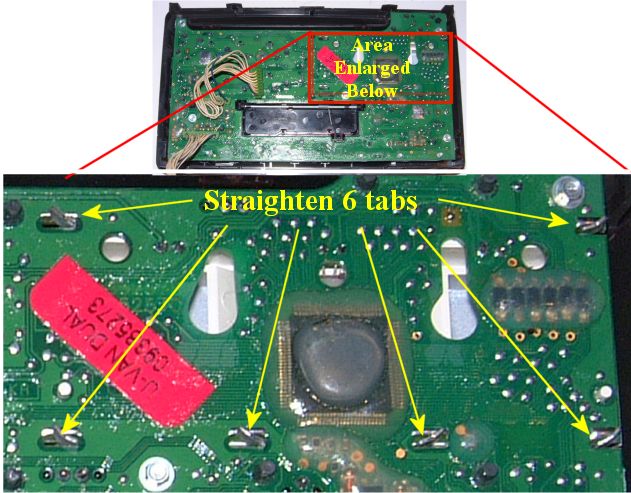

To get to the LCD backlight bulbs, you have to remove the LCD. In the previous picture you can see a metal housing around the LCD, it has six tabs that fit through the circuit board and are bent to lock them in place. In order to remove the LCD to access the backlight bulbs, you have to straighten the six tabs as best as possible. They have to be straight enough to slide through the small slots int he circuit board.Once you have the tabs bent straight, you have to pry the LCD and metal cover off, pulling these six metal tabs through the circuit board, so the better you can straighten them, the easier it will be. I used a pair of needle nose pliers.This pic shows the back of the circuit board small with a red box on it, and below that is a larger view of the area in the red box, with the six tabs indicated
Posted: Mon Jun 02, 2008 9:19 am
by joatmon
After you get those six tabs straight, then gently pry the LCD up and off from the front. Do it in little steps, working around. This pic shows the front of the circuit board, after the LCD has been removed. There are three bulbs, each soldered to the circuit board. The bulbs themselves are clear glass, but each has a tiny white rubber condom over it. Mine has a small amount of heat discoloration on the circuit board around the bulbs.-

- push the knobs back on the front. They are keyed, so line them up- reinstall the radio in the car
