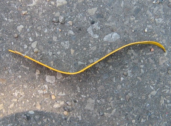

I didn't really notice any significant performance/power gains. At least not as much as I did when I put in my Cosmo CAI.I probably should have taken it to a shop. I can't cut straight to save my life. Note for anyone who wants to use a reciprical saw you can rent one from Home Depot. I rented one, $11.00CAN for four hours.Second note, if you've never used one before, buy at least two blades, and maybe some scrap pipe to practice on.I managed to make a bit of a mess of mine so I lost about 1/2" on the pipe.Look at what happened to the blade!

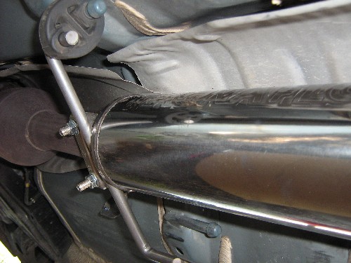

A shot of the resonator. I know one of the insulators is gone. I lost that a few years back when I ran over a rubber wheel chock on the highway.I've ordered one from a dealer, but he said it'll be 2 weeks. I guess I should have tried a Toyota dealership.

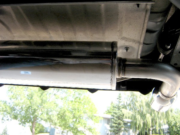

A view of the muffler from below

WOW......... I have no ideal how you did that, but i do have a suggestion. The longer blades are not the greatest to use, you should have gotten one of the shorter blades.When you say that you lost a 1/2" on the pipe. Is that on the stock pipe or the new pipe?

That was the shortest blade they had. They had one half the width thoughThe length I lost was on the stock pipe. The Magnaflow pipe does overlap by quite a bit, but has slots to allow for compression when using the clamp.When I have it at proper length, I can see a gap in the slot of the new pipe.I think welding the slots would solve the problem.Quote, originally posted by 02csnow »WOW......... I have no ideal how you did that, but i do have a suggestion. The longer blades are not the greatest to use, you should have gotten one of the shorter blades.When you say that you lost a 1/2" on the pipe. Is that on the stock pipe or the new pipe?

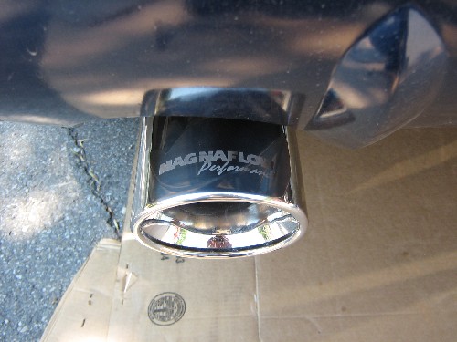

A shot of the exhaust tip
Yeah, I know it's not centered. I'll play around with adjustments after I get the replacement insulator. That and I'll probably have to get a sleeve made or get it welded to make up for the lost length. One of the bends near the axle is about 1/8" from the heat shield so I definately could use the extra length.

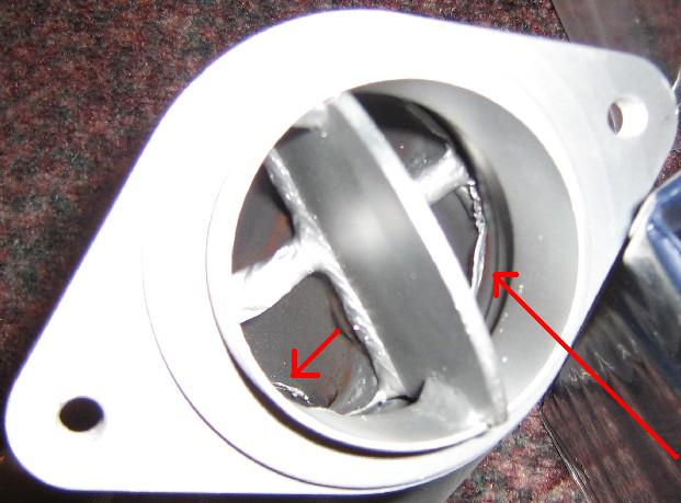

I have it on hand already. I don't think I'll be tackling it myself though.I did look at the inside of it and I'm a bit concerned. The ends of the pipes where they come together in the larger opening has bits that are roughly cut and sticking out at bit. I would tend to think that'll affect the flow, and possibly cause some turbulance. I'm wondering if I shouldn't use a Dremel to grind it down a bit.

Quote, originally posted by Petrucci914 »Now you just need the DC Sports Header. It's the one mod that'll give you the best performance per buck.

I would say either use a dremel or just a file and try to get it as smooth as possible. To me that just does'nt look good.

Yeah, I'm a bit disappointed considering how much it costs, especially since it's supposed to be a higher end performance part.Quote, originally posted by 02csnow »I would say either use a dremel or just a file and try to get it as smooth as possible. To me that just does'nt look good.

I don't remember if mine was like that or not. Regardless, your performance gain will be from the improved piping and following flow. The stock manifold is horrendous.
