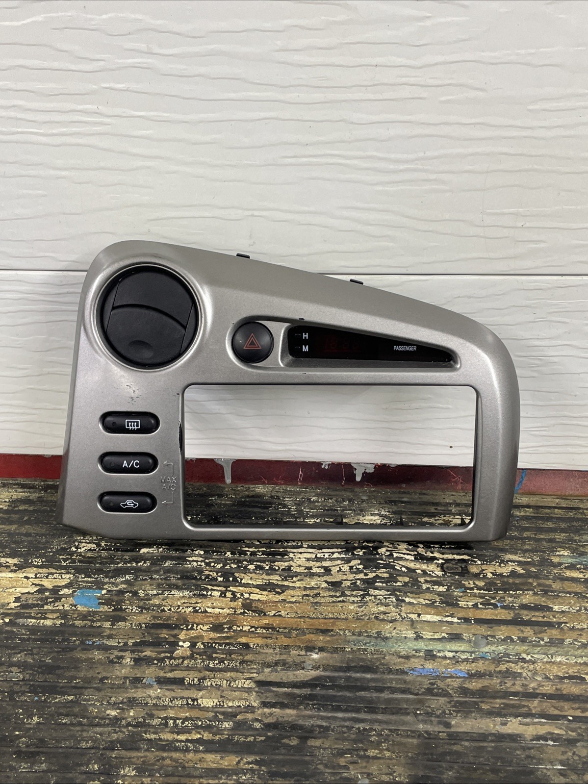

I was browsing for Vibe parts on eBay, and I came across this listing for a Matrix bezel (the one with the clock), but notice the buttons:
The third button is used for the rear defroster!
Apparently, for the Vibe GM decided to use a separate button located up by the hazard button instead, so the third button was left unimplemented for whatever reason.
So if it really bothers people, it might be possible to modify the Vibe's bezel to accept the Matrix's buttons and adapt them to work with the Vibe's systems.
Or, one could simply use the Matrix bezel and gain a neat (and somewhat redundant) clock, which one would have to figure out a way to wire up.

Re: What's behind the 3rd button (A/C, Recirc, ?)
Posted: Fri Jun 19, 2026 1:07 pm
by joatmon
I once bought one of those bezels. Turns out to not really be interchangeable on a Vibe.
The radio hole is a little bit too short for the Vibe radio, and leaves a big gap on the side of the radio. You can kind of get it to fit by trimming off some of the back side bottom of the bezel.
The switch assembly does not have the same physical shape as the Vibe's, so you can't just move the Matrix switch into a Vibe bezel. I think the electrical connector is different between the two. Also, on the 03-08 Vibe, the AC switch is a mechanical locking type, like a click pen, while that Matrix AC switch is just a momentary switch, the toggling happens somewhere else in the Matrix. You could use it in a Vibe, but you'd have to hold the switch in all the time you wanted AC.
So I gave up.
