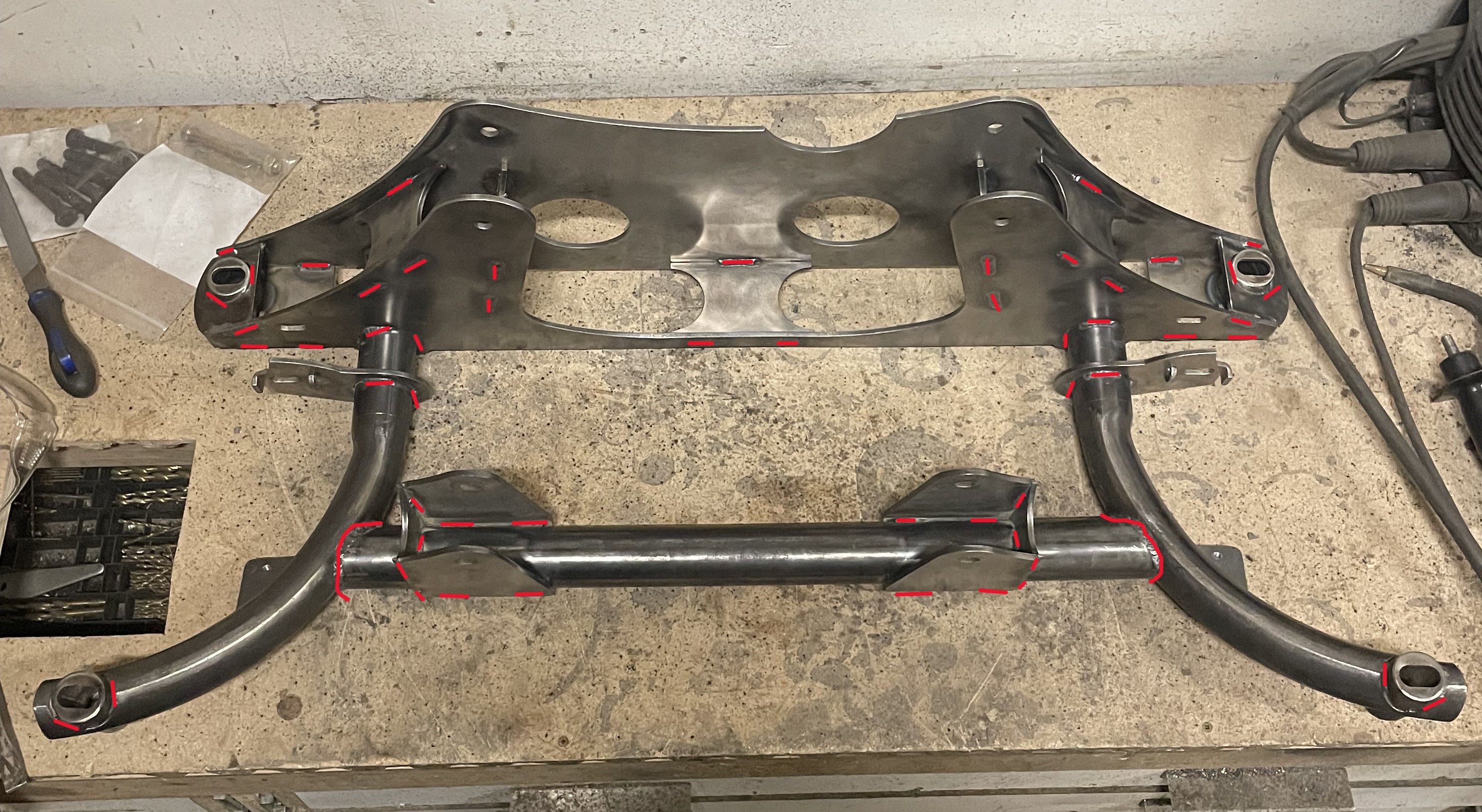

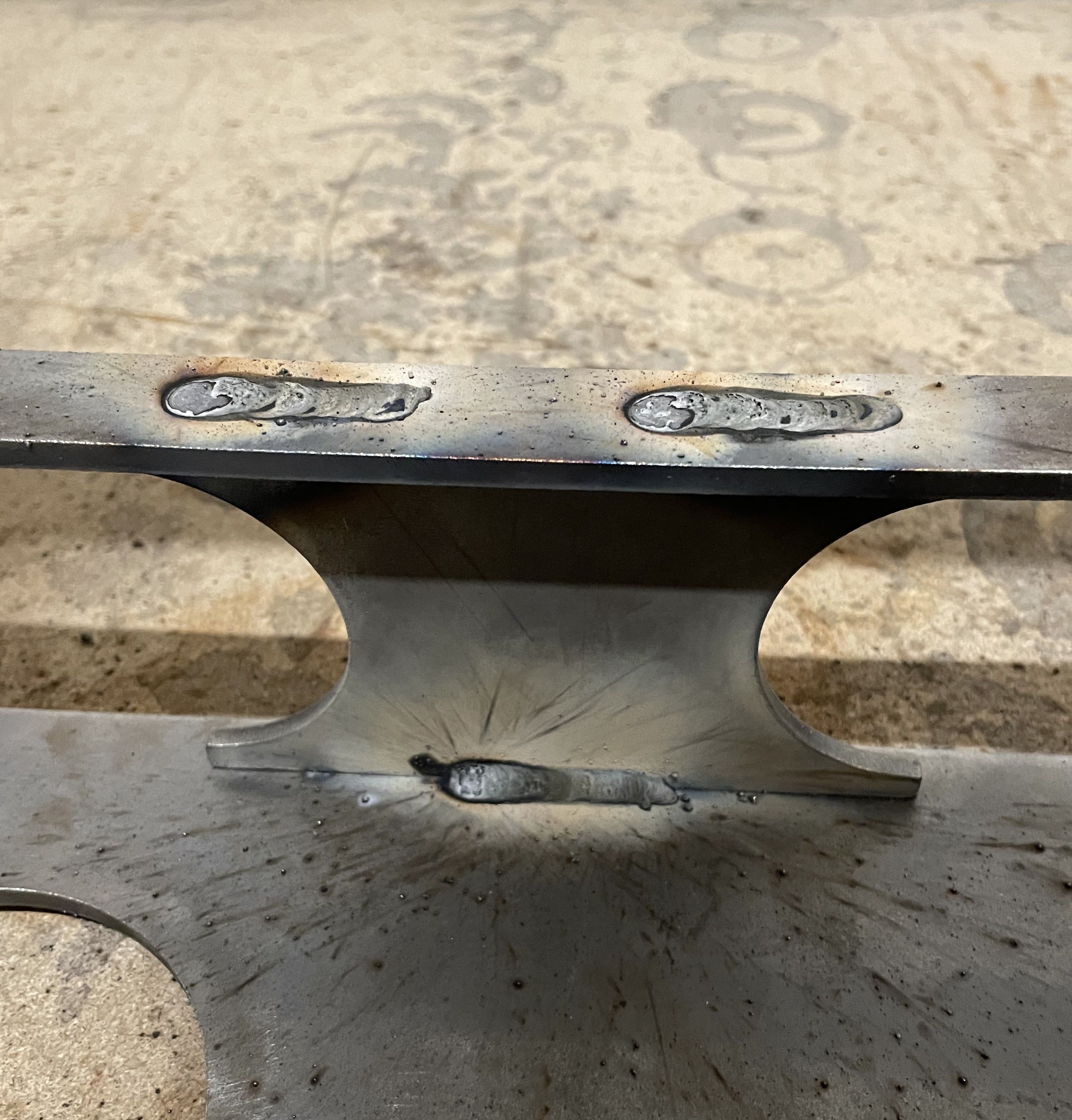

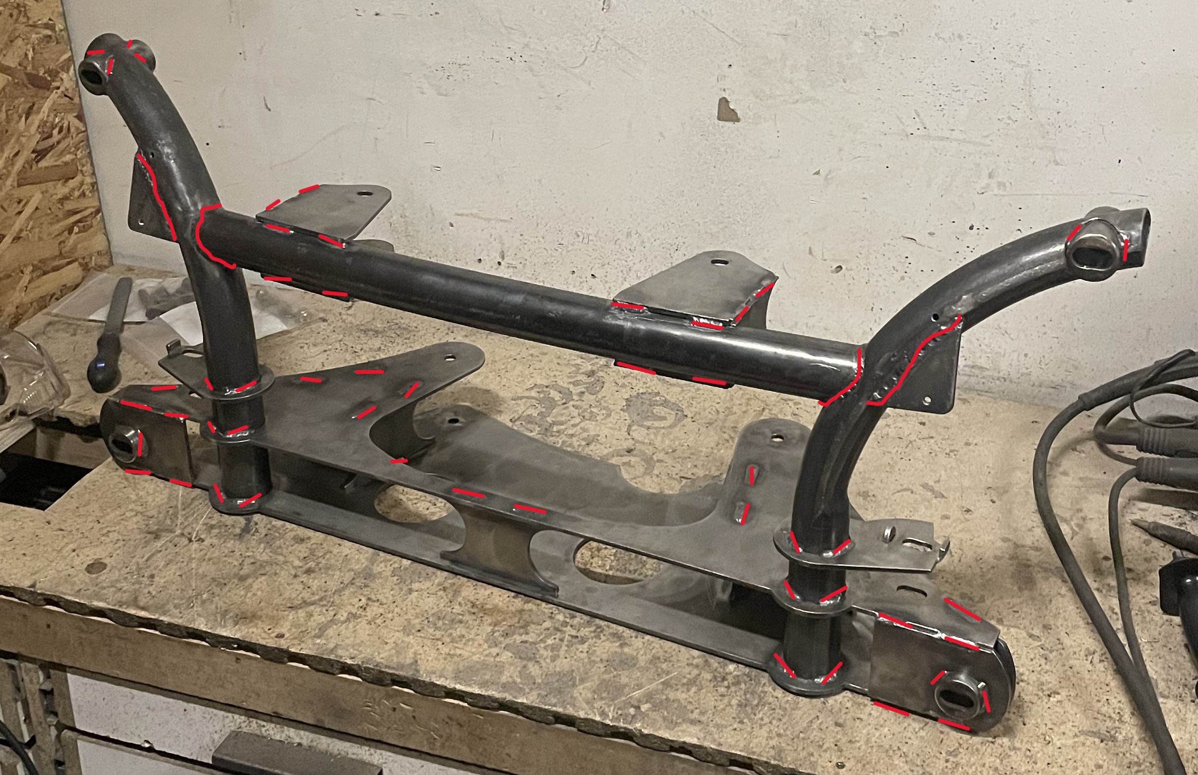

Next step: WELD EVERYTHING
I started by filling in all of the pass-through joints in the front and rear plates, adding a bead on the inside faces each time
No shame in using flux core, guys. Don't let anybody tell you different.
As a rule, I made sure everywhere that two pieces joined was either fully welded or had 3 welds minimum.
To give you an idea:
I only drew on the welds that were visible in the pictures, so you know, extrapolate.

aaaaand the unedited weld photos

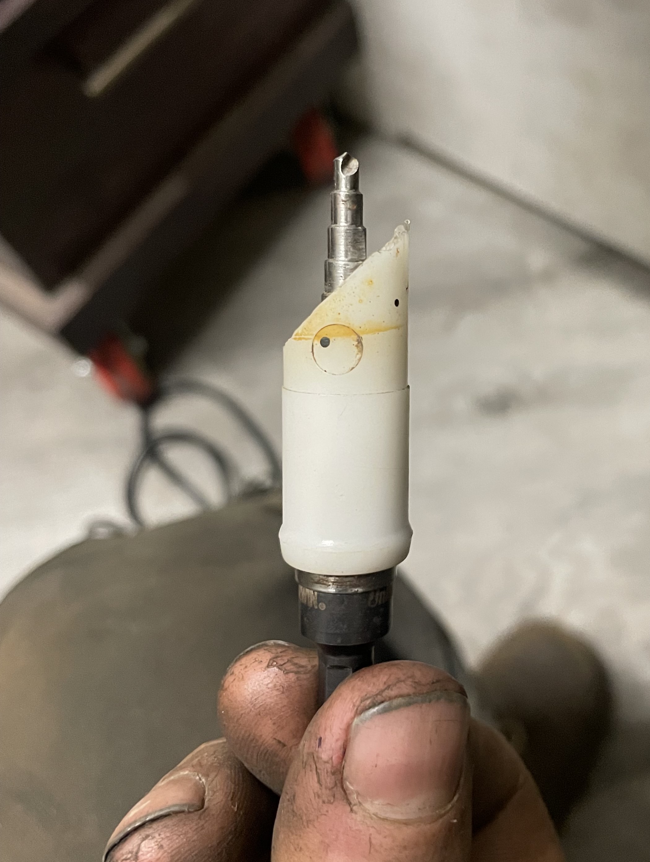

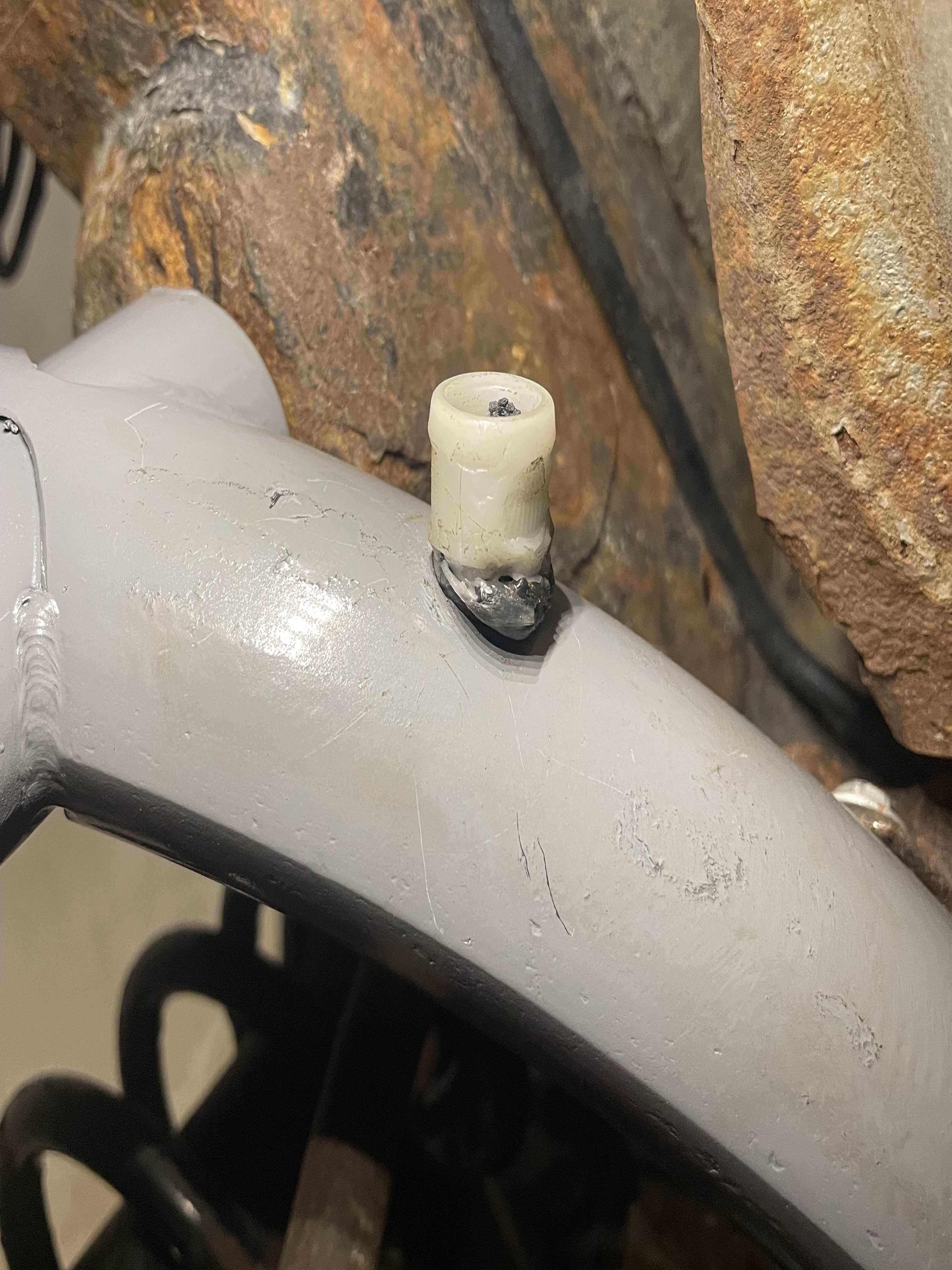

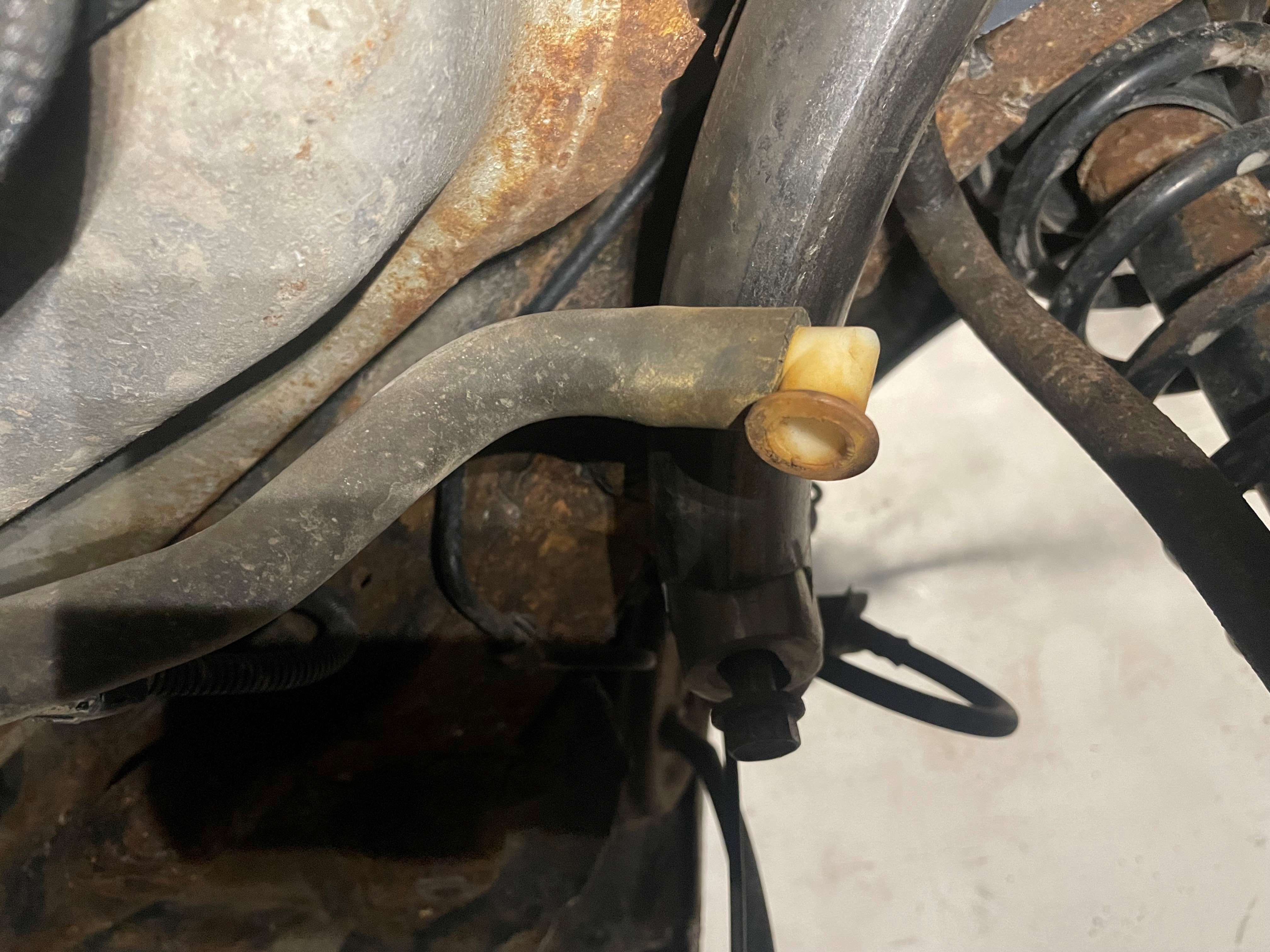

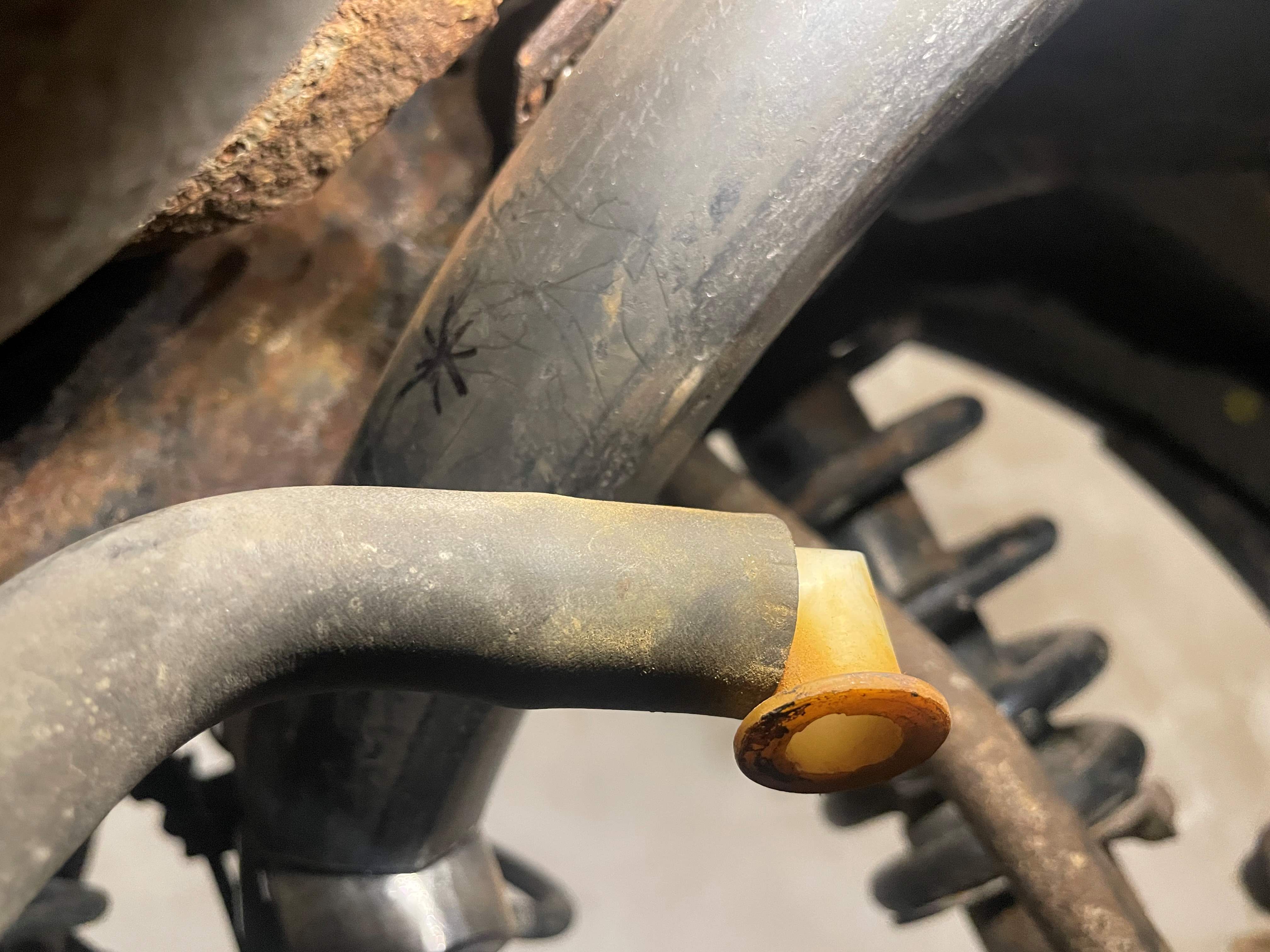

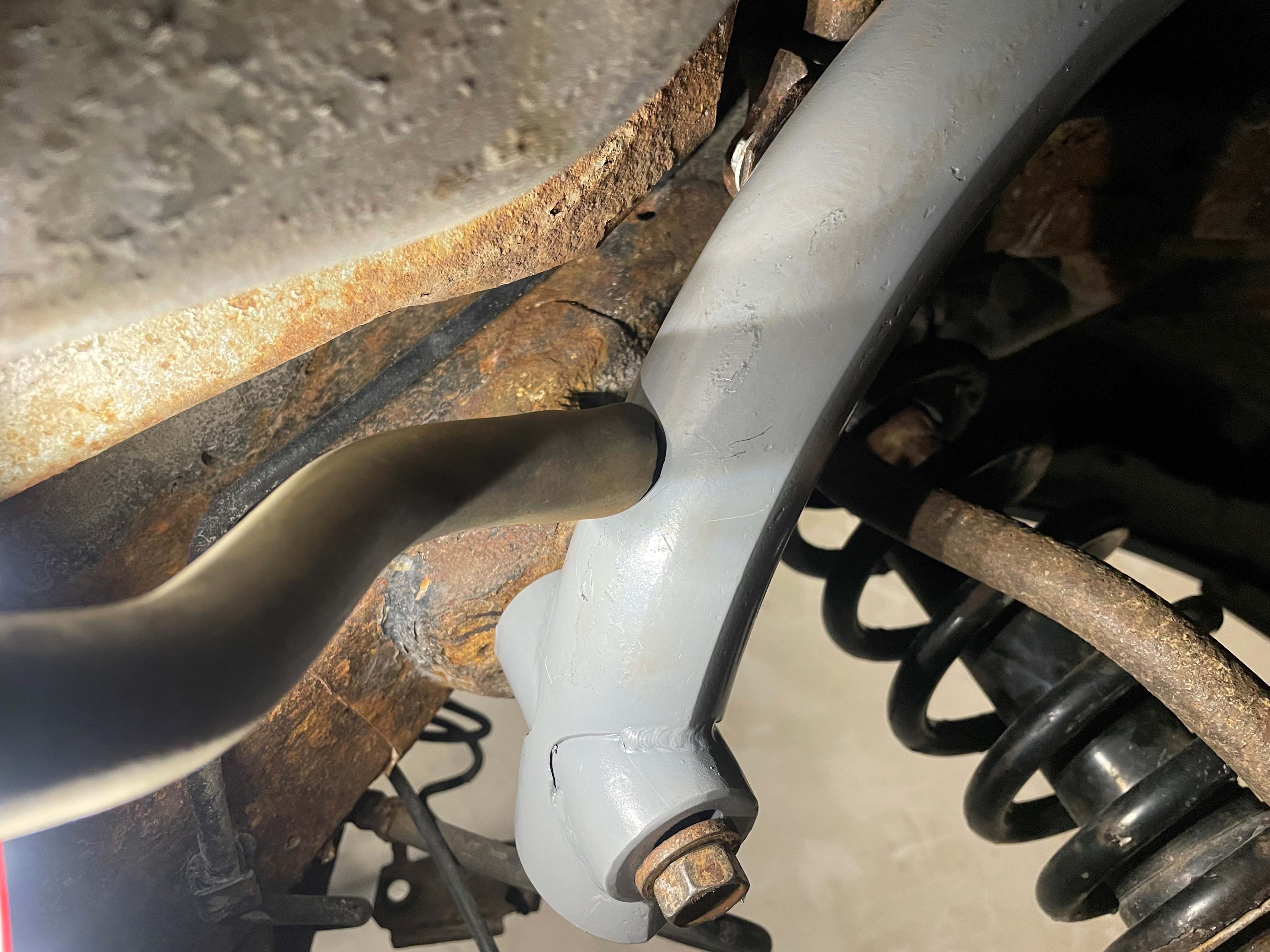

Weird hose:
So there's this weird hose that connected into the original subframe. Anybody know what it is? It runs back to the vapor canister, but for what? Does it suck? Does it blow?
Whatever it does, I marked where it seemed naturally to go
aaaand forgot all about it until after I had painted and done the final install.
So I drilled as big a hole as I could with a step bit (limited access), cut the 90deg elbow straight
softened up the plastic with a heat gun, and stuck it into the hole
I recommend that you not forget this hose and drill an appropriately sized hole before the subframe is in the car.

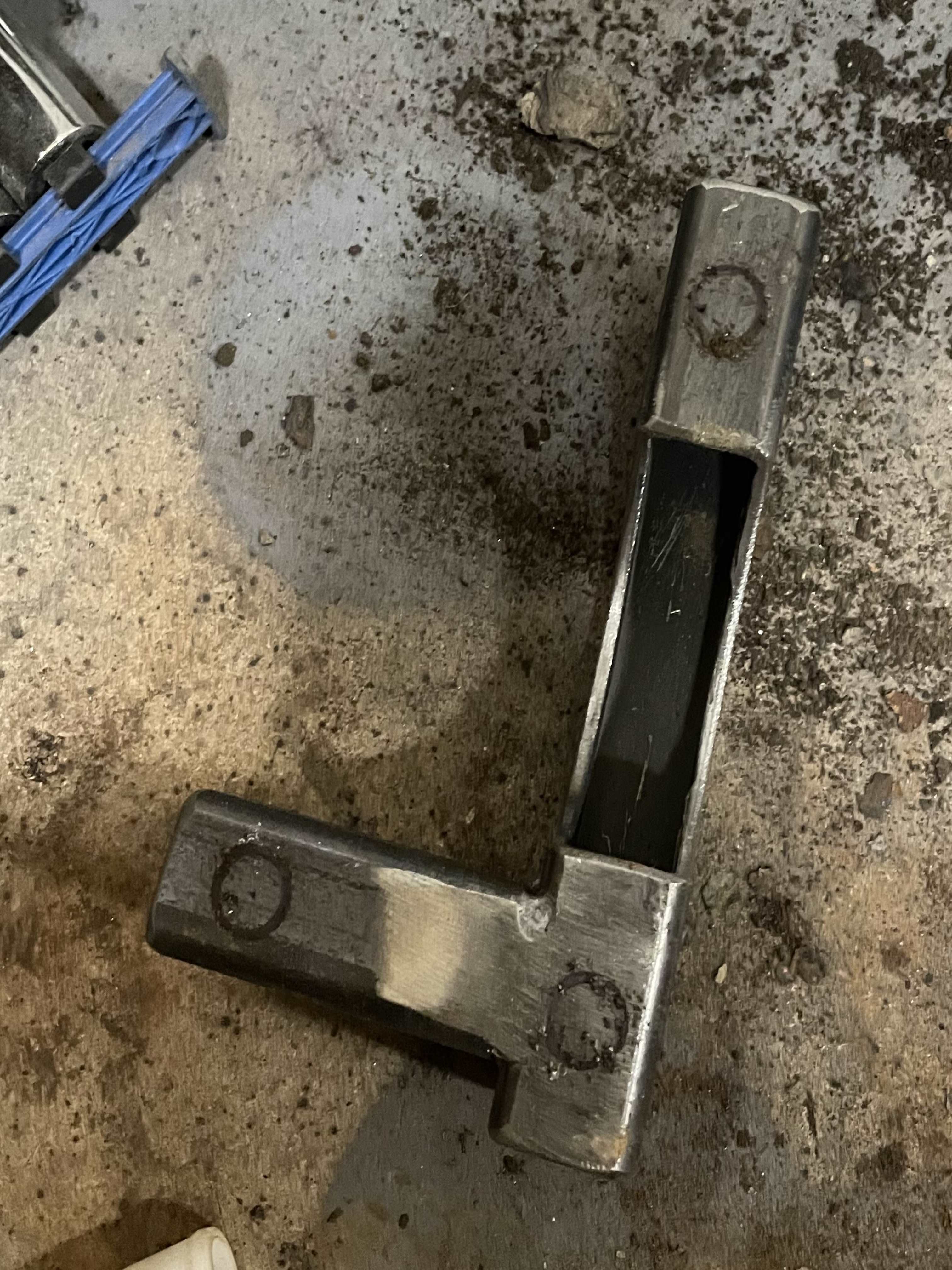

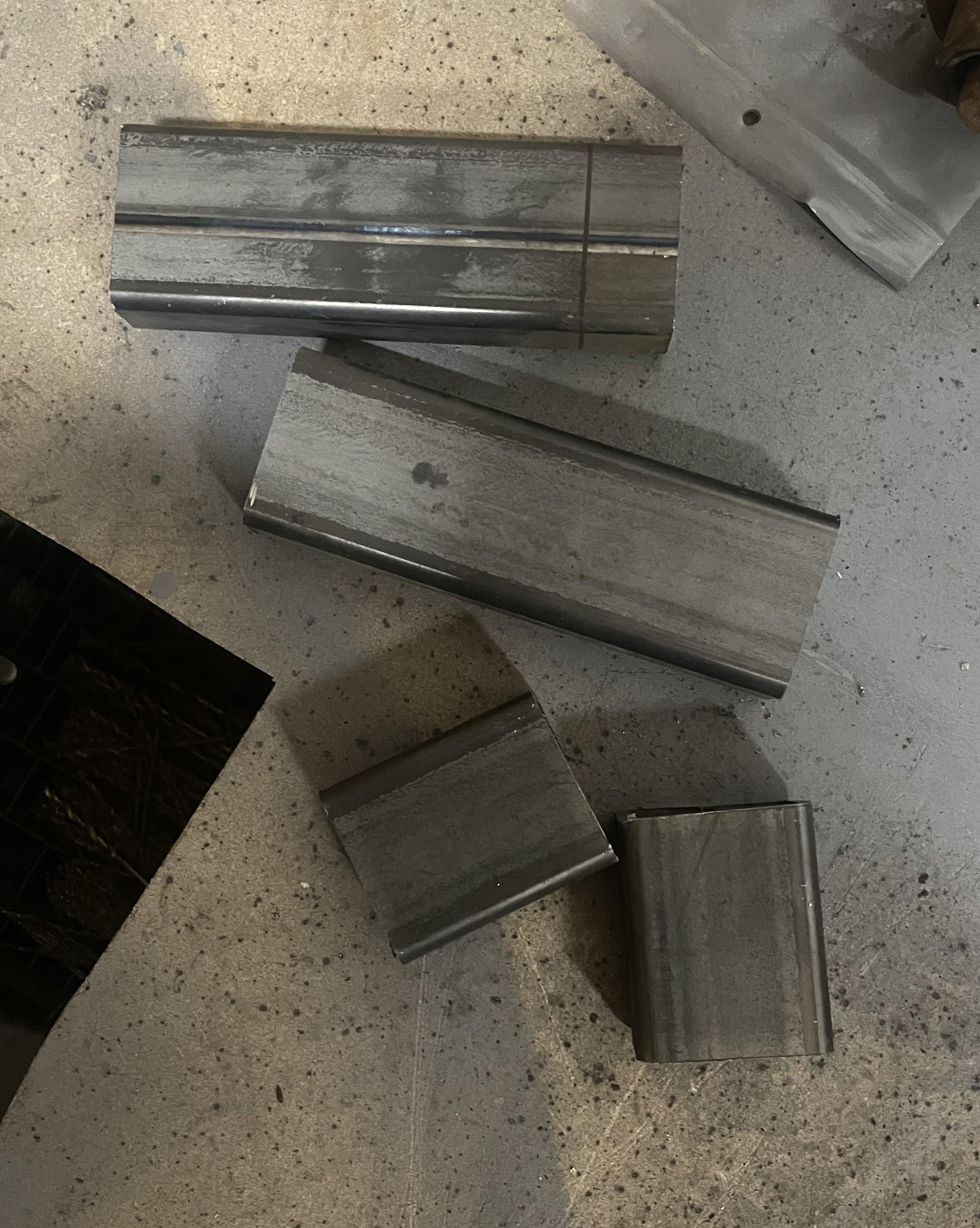

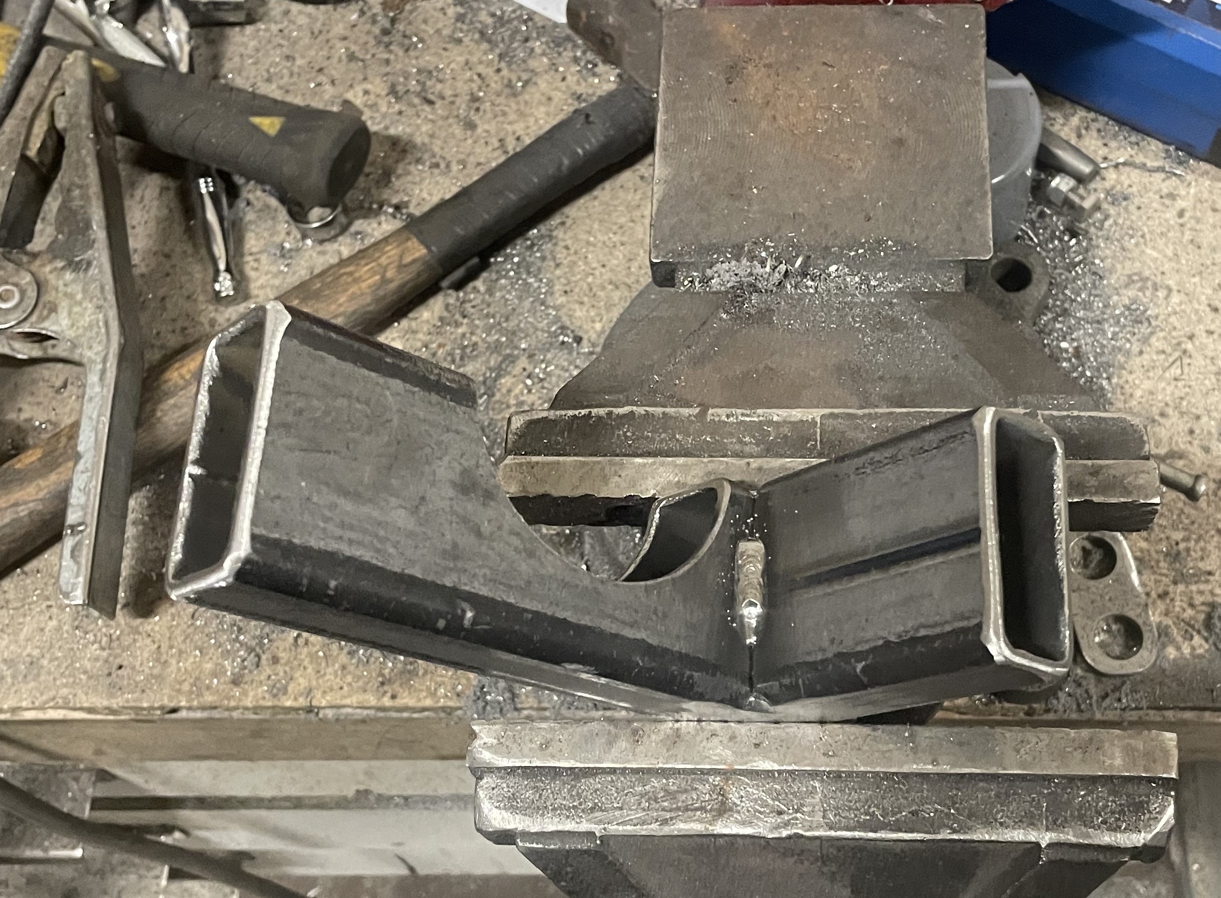

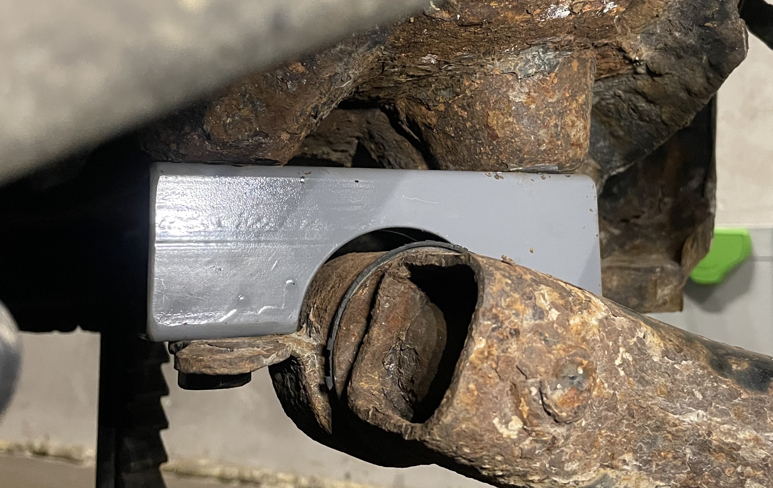

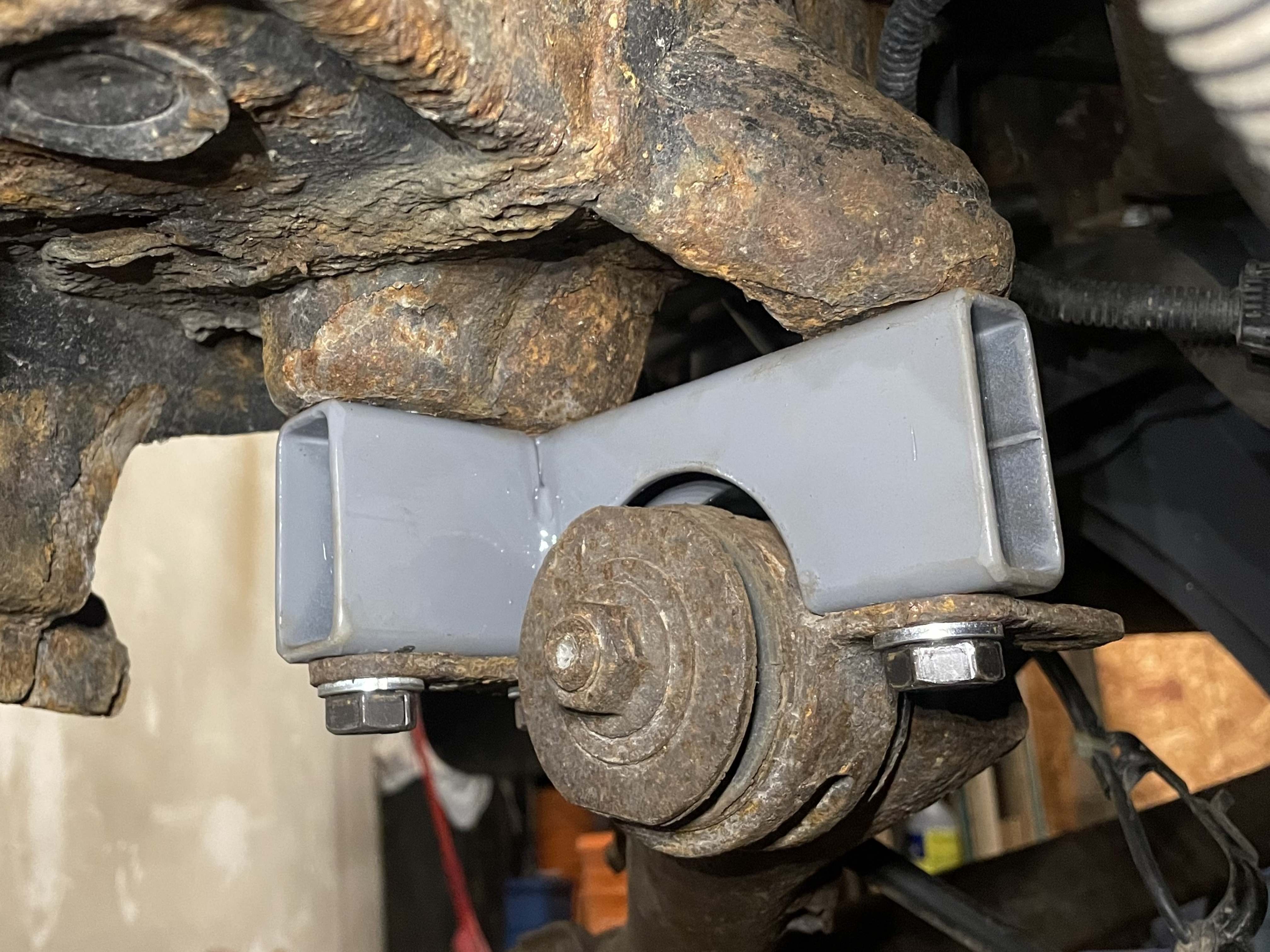

Lift blocks:

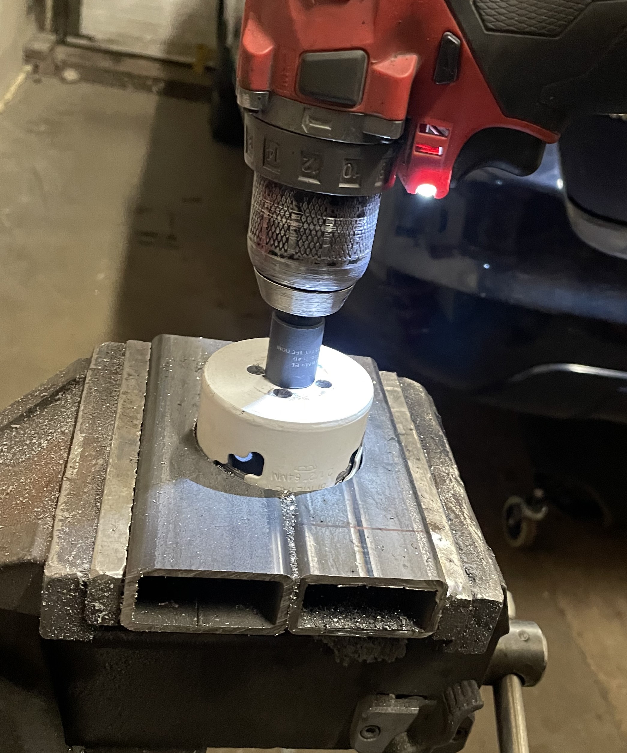

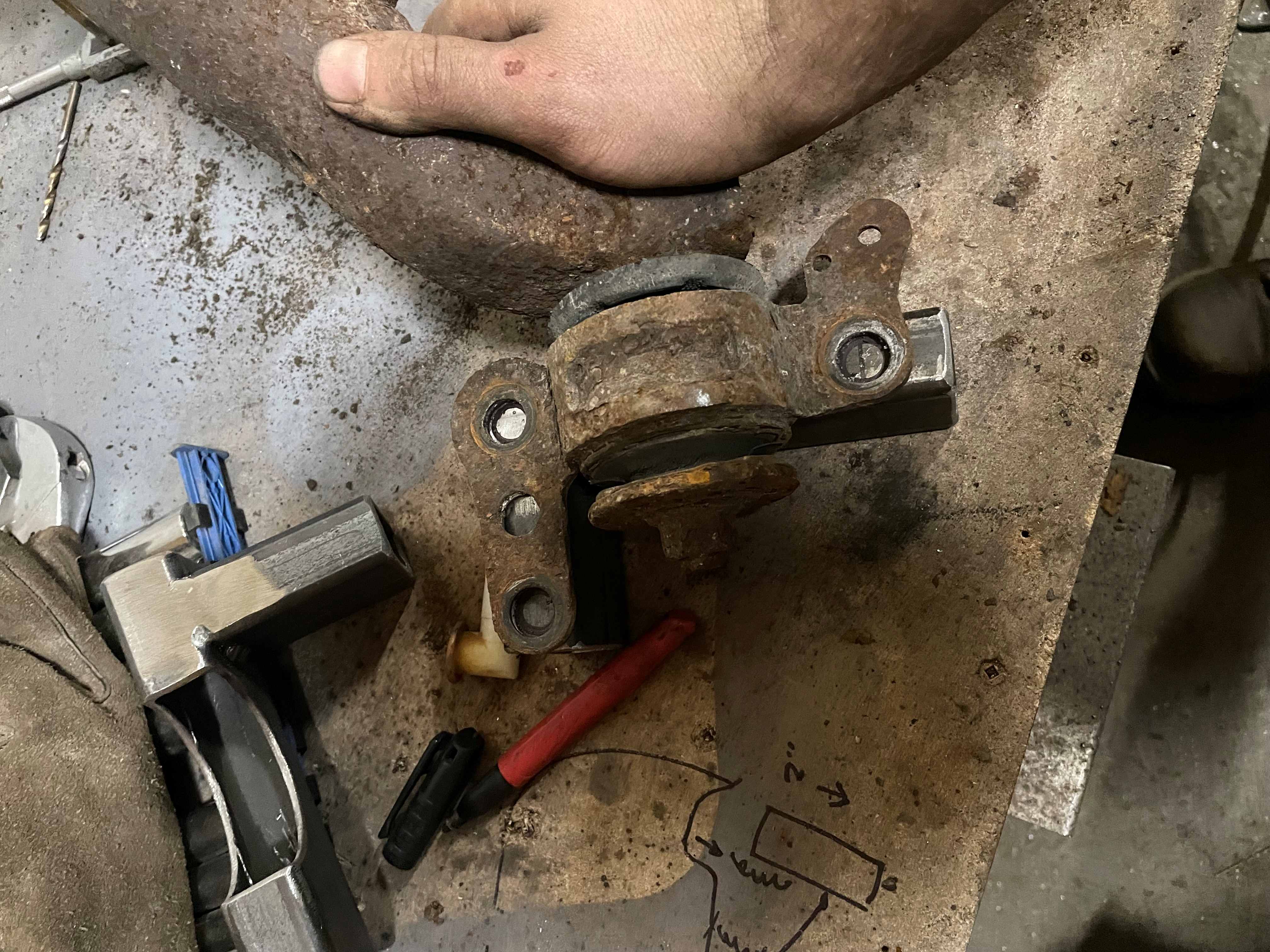

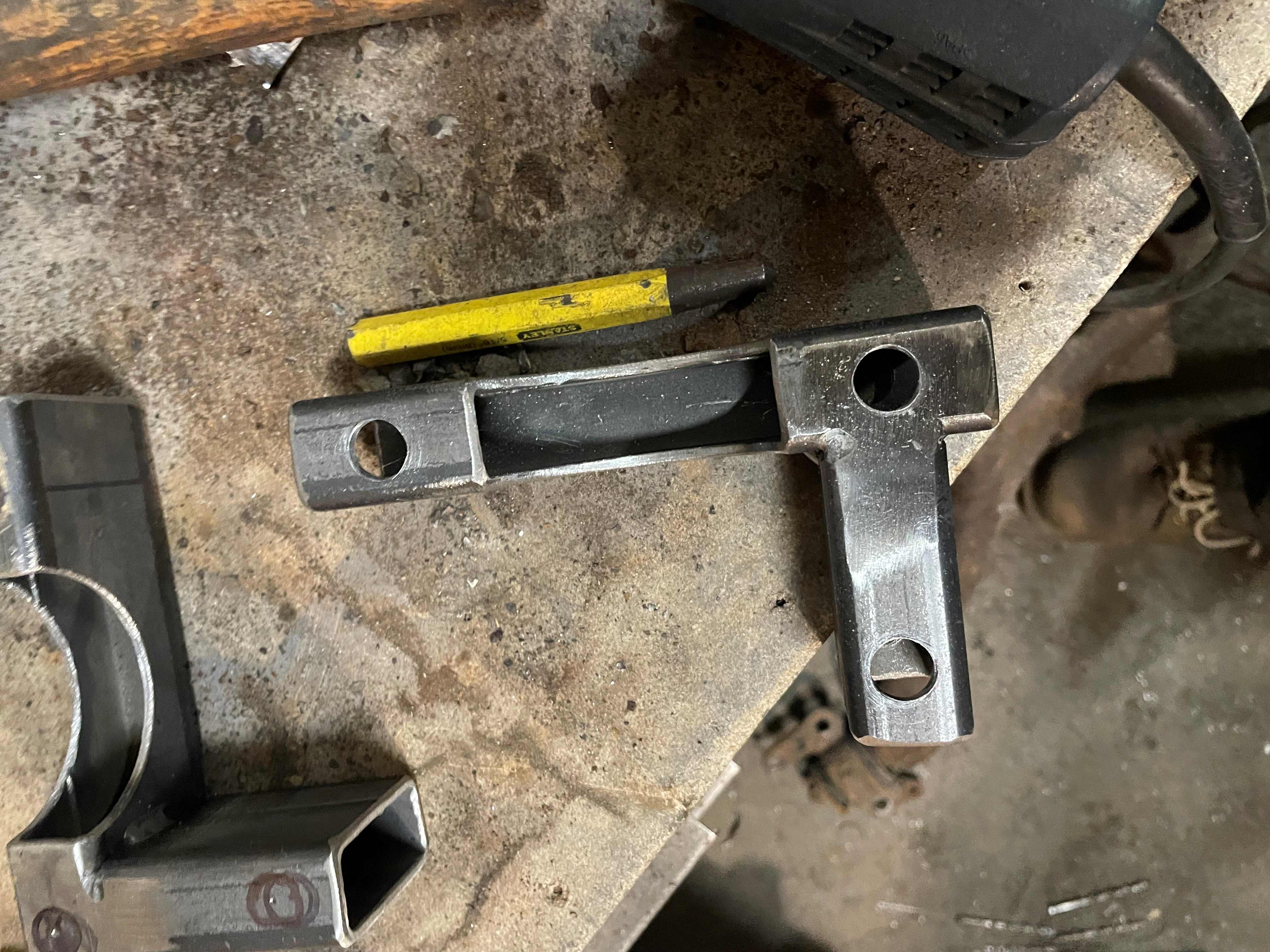

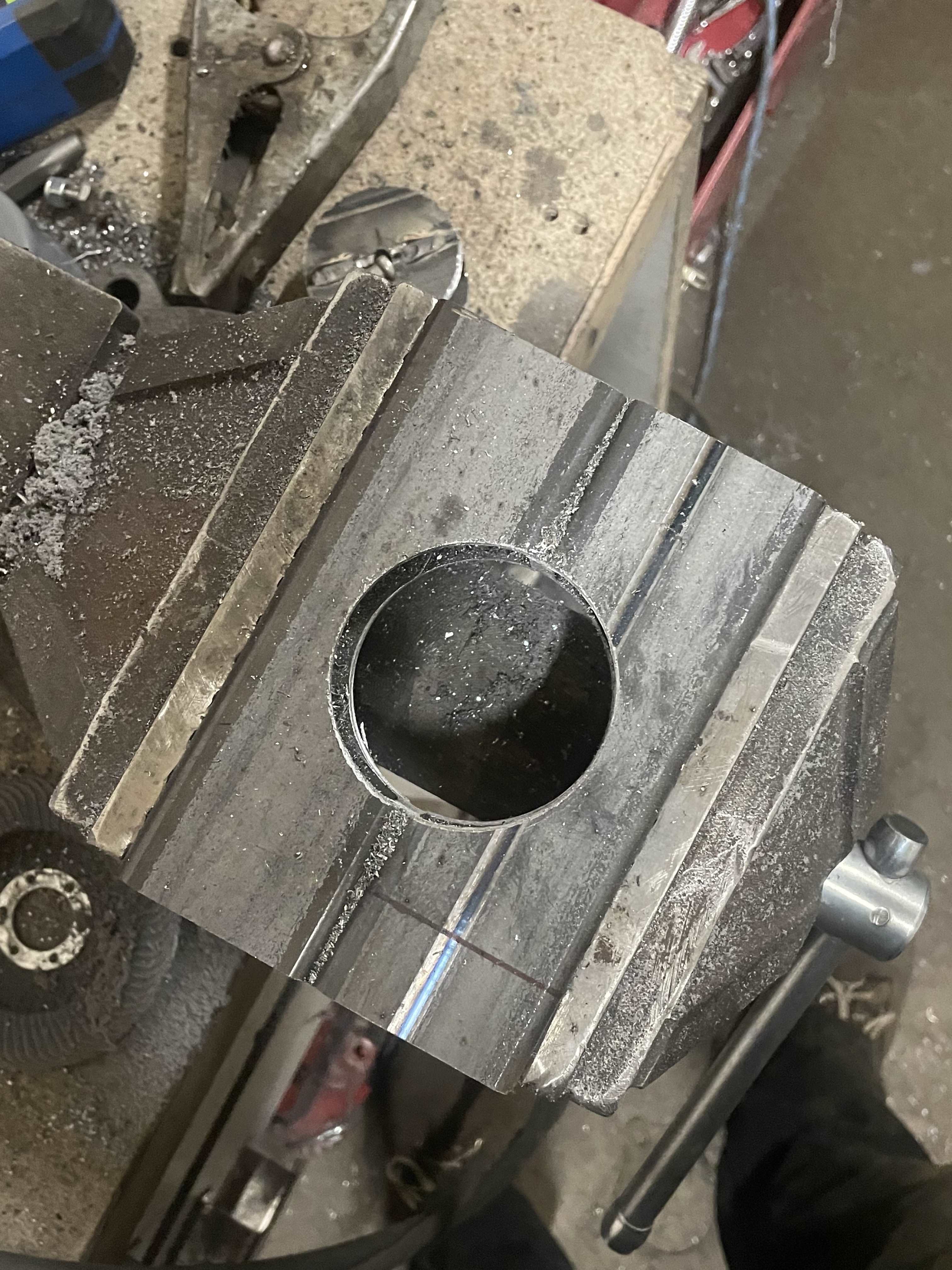

Because my Matrix is lifted and the new subframe corrects the suspension geometry by moving the upper and lower control arm mounts down by 2" relative to the car, I need to make some 2" lift blocks for the front mounting location of the lower control arm too, otherwise my rear caster angle would be horribly wrong. I tried designing a version of these that would use laser cut 3/16" plate, but making them out of 1" x 2" tube is just so easy that it wasn't worth the trouble. I don't have the measurements written down anywhere, so I'll have to come back and edit this post to add them (Don't forget this, future me)
I started with these
drilled a 2.5" hole in the center
and welded them together--mirrored, of course
There's really nothing to it.

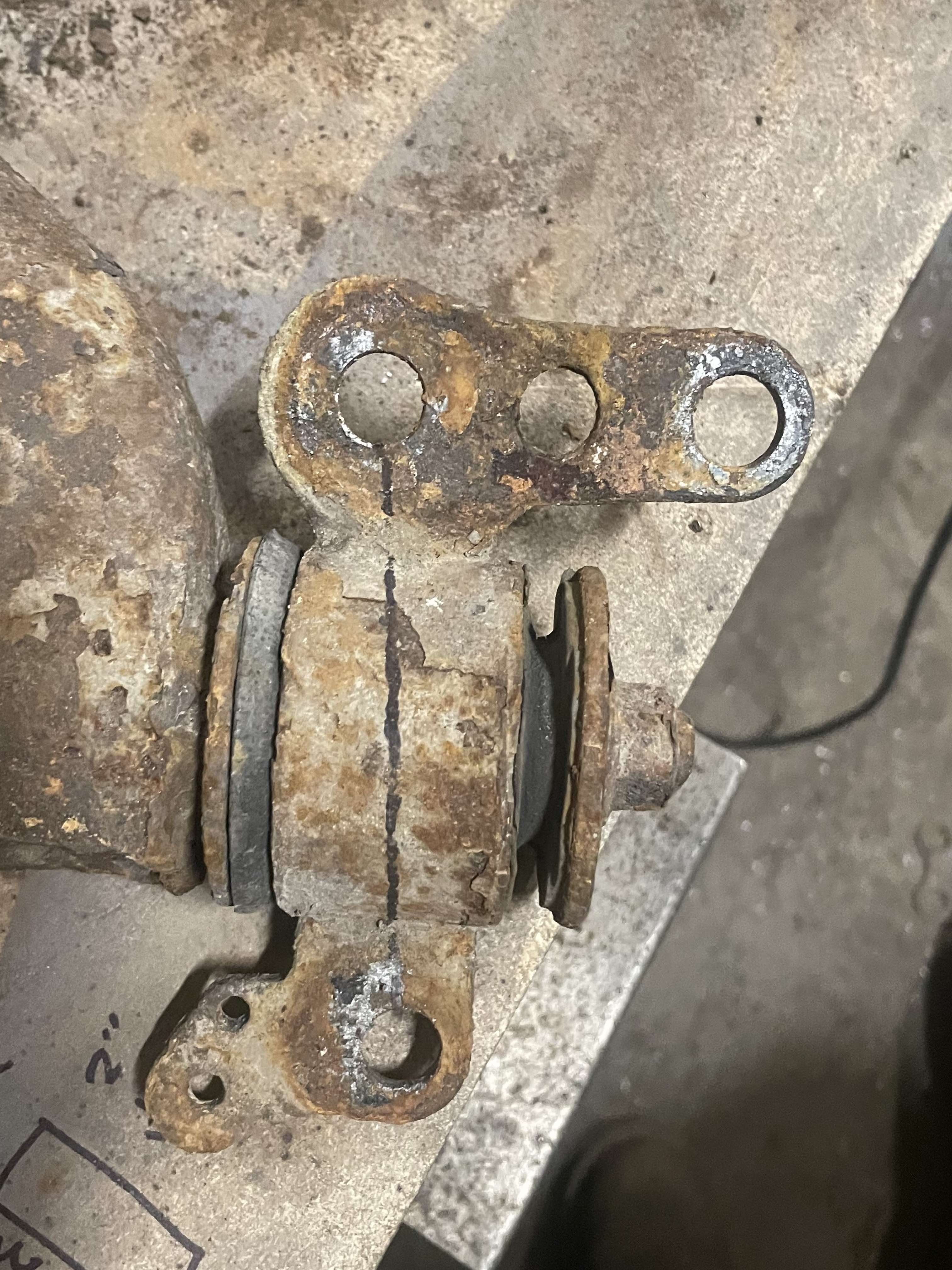

As you can see, the bolt holes aren't exactly 90 degrees to each other
but a slight twist when tracing the factory holes makes them fit quite nicely on our 90 degree block

Drill
paint and install
Like I said, nothing to it.
