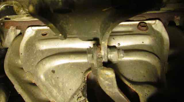

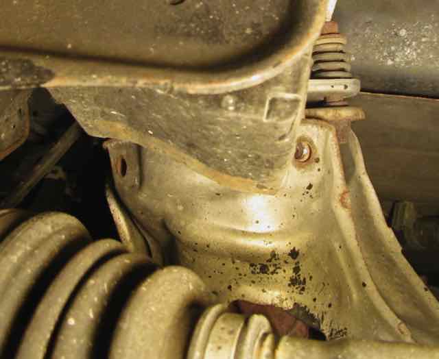

Back to summer mode at 202360 miles. Only issue over the winter, started to notice buzzing from engine area. Figured would need to check the heat shields next time car was in the air. Sure enough the heat shield was loose, but not in the way I expected. Not loose tabs or loose mounts... instead Missing Bolts...
This shows two of the open holes left by the mounting bolt near the manifold and catalytic coupler
Show missing bolt near head on the exhaust manifold.
Their are four bolts that hold the exhaust shied to the exhaust manifold bottom. 3 of the 4 mounting bolts are missing. Does not appear the bolt heads rusted off, the entire bolts are gone, leaving open holes in the exhaust manifold. Tried to retap one of the holes for replacement bolt, to far gone. Would have to remove exhaust manifold to retap the other two holes, making replacement a better option.

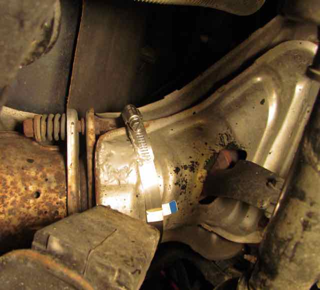

For the short term, resorted to large hose clamp (102-152mm Stainless clamp worked fine) to secure the shield. Plugging open bolt holes with exhaust repair compound, used Permatex MTK-1 Item 80335 (used before on several other projects holds up well).
Felt around the top heat shield, appears those bolts are still in place.
Not sure if you had enough bolts missing, enough exhaust gas could escape to create O2 sensing or other issues.

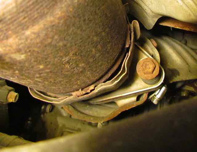

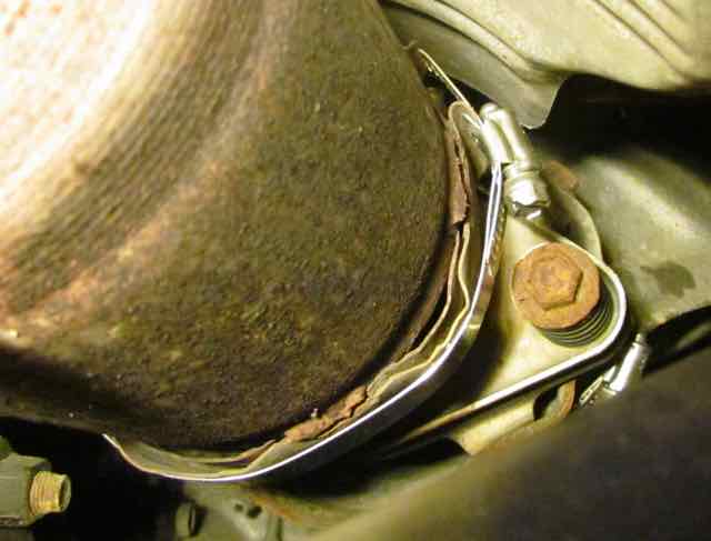

After making the repair noted above, started the car and more buzzing... Figuring I did not have something adjust correctly went back under the car... and found another heat shield was broken free :evil: . This one is the heat shield welded to the front of the first catalytic convertor. Two of the three welds were broken allowing to vibrate against the catalytic convertor and forward facing flange. Grabbed another hose clamp this time 76-127mm size (3-5 inch) and placed around the wider part of the heat shield above the welds. The tab on the hose clamp locked into the bent tab on the heat shield which made keeping the clamp in position really easy. Good thing I bought several sizes of hose clamps for the previous repair. Most farm supply stores will have stainless hose clamps up to 205mm 8 inch. So far two hose clamps under $2 each and a tube of exhaust fix compound $6, for a repair total of $10. Last car I had the Stainless clamps outlasted the heat shield and exhaust system.
Vibe_cat_heat2 - 1.jpg (26.1 KiB) Viewed 13724 times
Completed repair, shield and weld marks lined up fairly close, did not want to over tighten clamp.

Any guess on what happened to the bolts that are missing? Did they just somehow loosen up over the years and dropped out - or do you think there would be some other reason? I've never seen something like this to have happened before so I am a bit puzzled.
Thanks for posting so we can be alert to check this area.
Re: Derf 2005 Moon and Tunes Deluxe
Posted: Tue Apr 26, 2016 12:40 pm
by Derf
I am completely puzzled by the missing manifold heat shield bolts. Only found one other post on the forum from 2012 mentioning similar issue on a 2004 base Vibe. Looking at the three bolt holes, appears the bolts spun out. There were no rub marks on the heat shield or rusted stubs left behind. The bolt holes were so rusted I was not able to re-thread, they must have been missing for a while. I do not know of any previous work on the vehicle were those bolts were removed, the most major repair documented, was timing chain replacement.

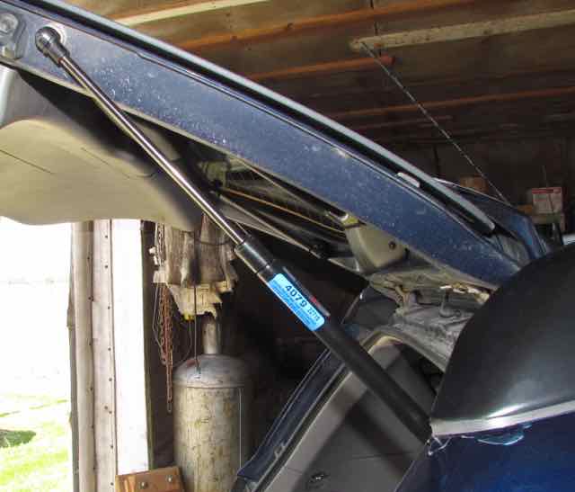

Another minor repair. Last fall noticed the rear lift gate struts were getting weak, 11 years old, normal wear item. Looking at various sources went with the following: Qty (2) StrongArm 4079 Rear Liftgate Hatch Tailgate Lift Supports Struts Shocks
Purchased off eBay, made in USA from US seller http://www.liftsupportdepot.com Perfect match, plenty of lift and smooth operation. Seller included helpful install tips and discount on future purchase. So far, so good. For a clean look the stickers easily peel off, can put on the back of your service manual for easy reference.
Looking at the old lift struts appears OEM had a left and right part number
Left 8025PB 0585N 68960-01010-A
Right 8028PN 0585N 68950-01030-A
Both made by Stabilus Lift-O-Mat

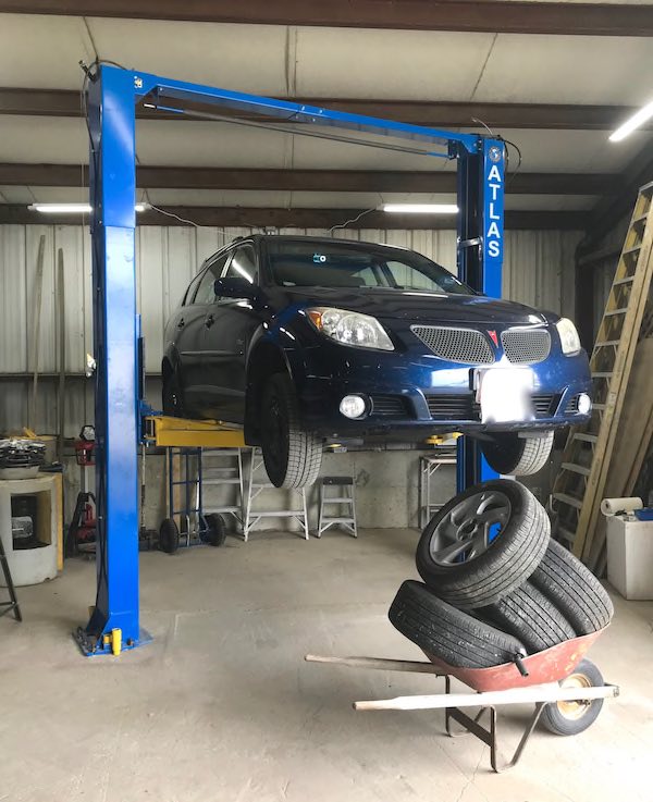

Wheel barrel full of rubber. Back to summer mode at 211,877 Upgraded shop over winter. Can now complete tire swap without jack stands. While on the lift noticed two rust spots. Will address once weather gets warmer. Vibe needs a good washing.
