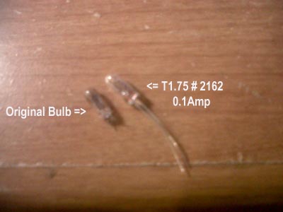

I ended up ordering the 2162 bulbs, I like the 10,000 hour rating. Our theory on why these display bulbs have burned out is this, those little white rubber things that were on the original bulbs caused them to run too hot leading to premature failure. Just my thoughts. We left them off the new bulbs.
Also, the 5 screws on the back of the metal panel were 1/8 " . This is a really small socket. We only had a metric, it is between a 3 mm and 3.5 mm. We ended up finding a micro driver set at Lowe's that had a 1/8 in it.

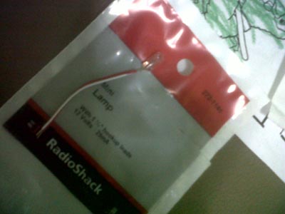

The Bulbs I used were bought at Radio Shack. They are Krypton Gas 12v - 50ma Bi-Pin Lamps. Similar in size but slightly smaller than the originals. (The part # at Radio Shack is 272-1154) I re installed the little rubber light diffusers on the new bulbs and just rolled them back alittle since the new bulbs are shorter than the old ones. Seems to be working fine and the new bulbs, despite the size difference, seem to appear to have the same brightness as the old bulbs. My soldering skills were not the best, so hopefully the new bulbs will stay attached to the board for a long time. :D

I first changed mine using the RadioShack mini lamp 272-1141 ($1.69 each). These are 12V 25mA (0.025Amp) (Sorry for the bad quality pictures).
I did not like the results. 0.025Amps were too little Amps to light up the screen with the right brightness. So I ordered some T1.75 Miniature Automotive Light Bulbs #2162 on eBay ($1.05 each + $0.99 + Free additional bulb shipment). These are the actual size to fit the white bulb rubbers with the right brightness. They are 14V 0.1Amp (100mA) but they light up just with the correct brightness (I compared my radio screen with my sister's Vibe's). I think that the fact that these are meant for 14V instead of 12V, it will give the light bulbs a longer life. :-)

you misread the label 272-1141 is 25mA milliamps not .25 Amps(250 mA) that's a factor of times 10 difference. Thus it's dim

jasonvibe wrote:you misread the label 272-1141 is 25mA milliamps not .25 Amps(250 mA) that's a factor of times 10 difference. Thus it's dim
Yes, you are right. 25mA is equals to 0.025 amps. I already made the corrections. Thanks!

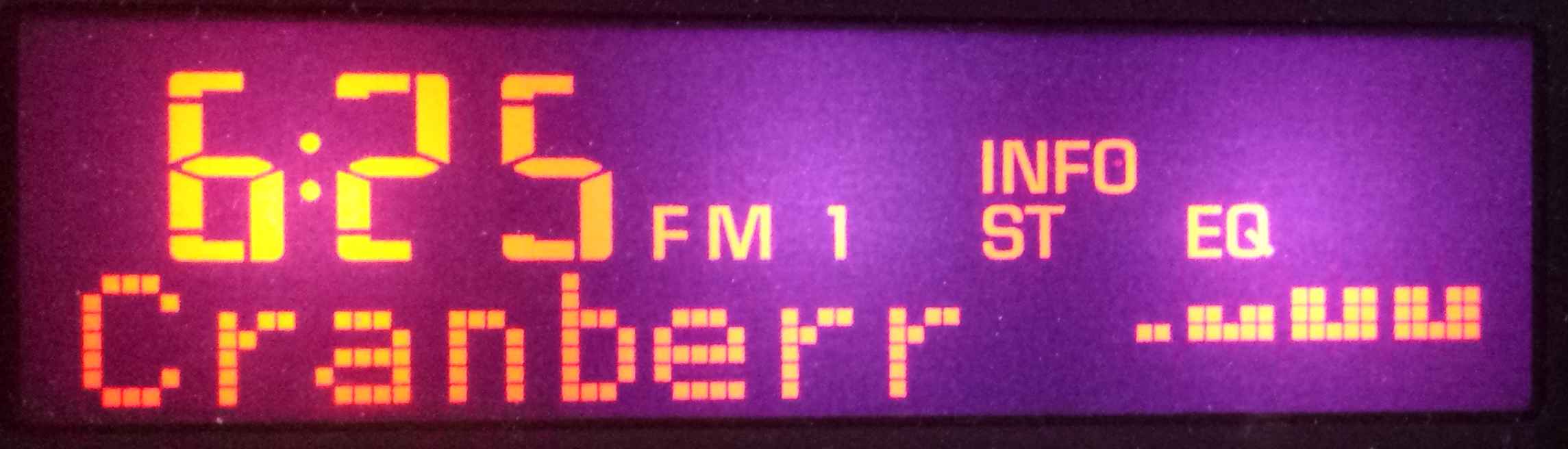

Anyone know if there is a way to remove the red from the LCD display while it is off to change the bulbs behind it? I have such a hard time seeing red and black together, infact I hate all Pontiac and now new GMC gauges because of this color combo. was just curious if this was an option as I need to replace my back light bulbs on the 07.

My Radio lights completely went out, and I wanted to try LEDs instead of bulbs.
Here is the end result using Radio Shack High Brightness White LEDs #276-0024
Radio LEDs evening crop.jpg (80.1 KiB) Viewed 20340 times

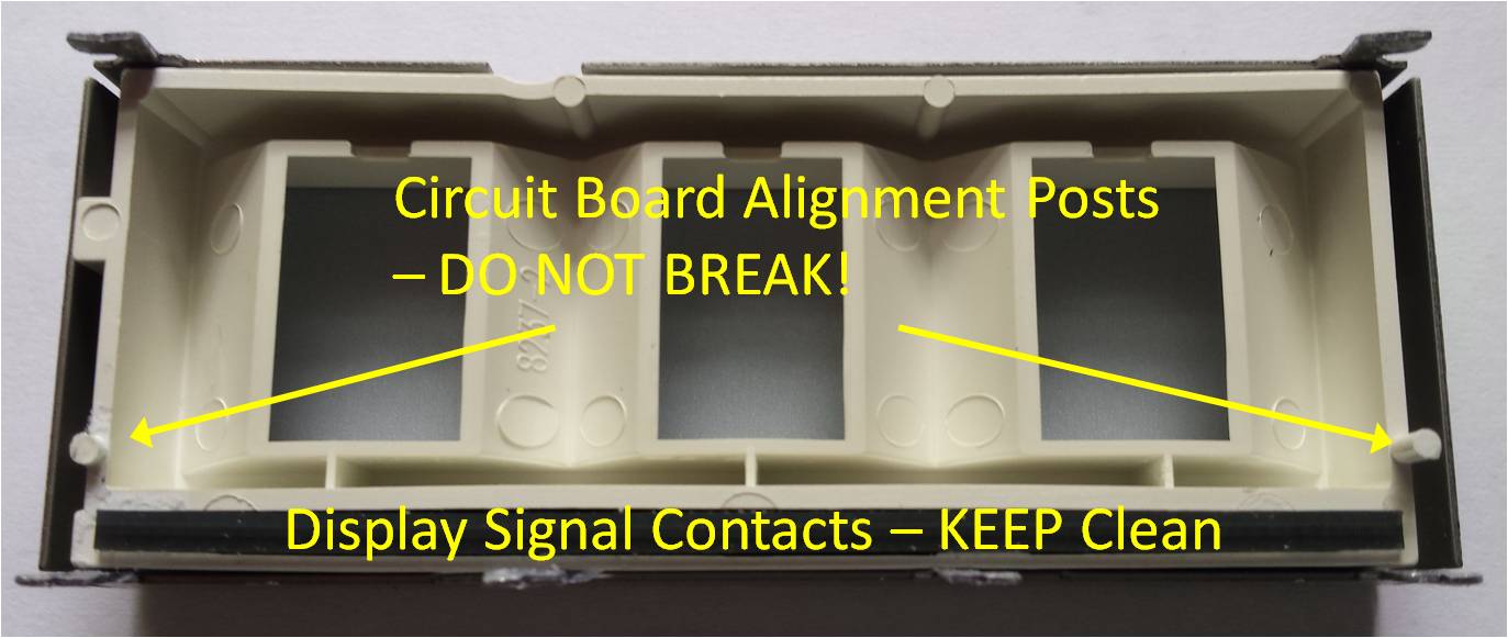

Another tip on disassembly - In removing display, after straightening metal tabs, pull display STRAIGHT out from circuit board. There are two plastic alignment posts on the display that you do not want to break! In my photo the post on the left is partially broken. When reassembling, make sure signal contact pads are clean, and apply pressure over the contact pads when bending the four metal tabs back.

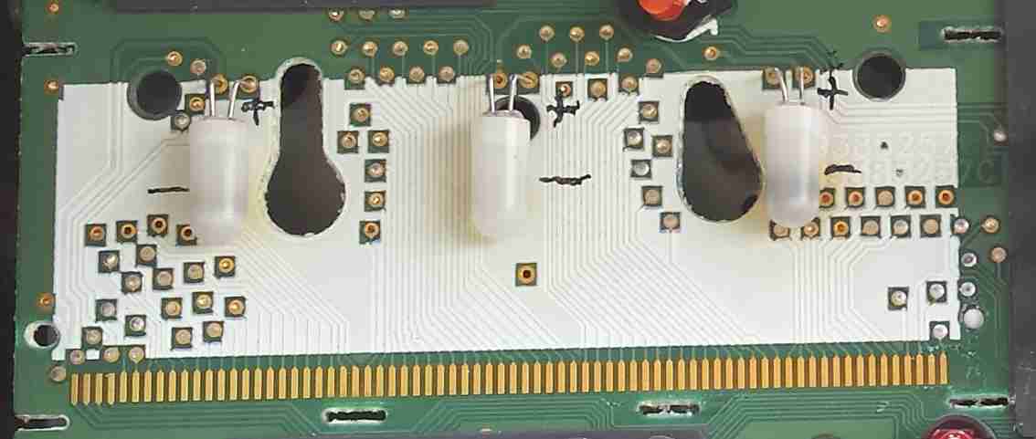

The first step in using LEDs is figuring out the polarity. Facing the front of the circuit board, the positive voltage hole is on the right, for all three bulbs. Positive marked "+" in the photo.

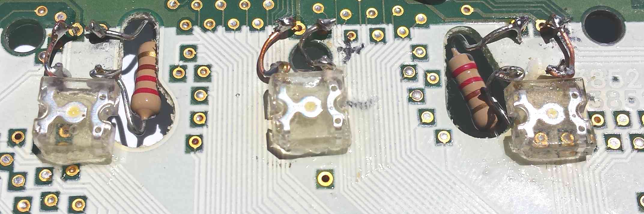

Here is the Circuit board with Radio Shack High Brightness White LEDs, PN 276-0024.
Each LED has a 1/2 Watt, 220 ohm resistor (power computes to about 1/4 Watt) in series with the LED. The resistor can be on either LED lead. The current in each LED measured 39mA. I used epoxy under each LED to conduct heat to the circuit board. Though in operation the LEDs do not get warm, the resistors dissipate the most heat.

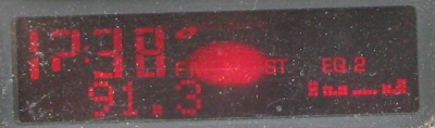

In the interest of full disclosure, I need to report that I'm having an issue with the LCD in my radio, one of the segments in the hour position is gone, and I'm getting a large bloom in the center.
I've had this unit in my car for about 330K miles, since June '03. looks like I put the #74 bulbs in in June '08, about 170K vibe miles ago.
Is my developing LCD issue a result of using a different bulb, perhaps brighter/hotter, or is it just the kind of thing that happens after a third of a million miles of on time? I don't know, and honestly at this point I don't particularly care, but I thought it responsible to mention it

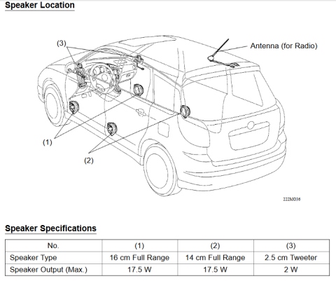

Off topic: but does anyone know the Peak Output and RMS Power of the stereo on a 2008 Vibe (base) without the Monsoon system? I can't really do all the fine work because of arthritis, so I just want to replace the stereo. I'm trying to match it as close as possible in output.
Re: Radio lights going out
Posted: Thu Nov 12, 2020 12:37 pm
by joatmon
Welcome to genvibe (late, but your first post)
y0himba wrote: ↑Wed Nov 11, 2020 8:08 am Off topic: but does anyone know the Peak Output and RMS Power of the stereo on a 2008 Vibe (base) without the Monsoon system? I can't really do all the fine work because of arthritis, so I just want to replace the stereo. I'm trying to match it as close as possible in output.
No idea. At one point genvibe had a member who might have had insight into the technical characteristics of the radio, but I can't remember who that was. Probably a safe bet would be to go to a site like crutchfield and put in your year/make/model and see what they say is compatible. Those who have put in aftermarket radios in 03-08 VIbes with the sunroof, and therefore the additional amplifier under the front passenger seat have had to put in some sort of level converter between the new radio and the amp to cut down on loud pops.
An alternative would be to look for some sort of electronics repair shop in your area and see if they could do the bulb replacement, or a longer shot, post up your city and maybe someone here who's nearby can help you out.
Edit 11/14
Found this in an 03 Matrix manual, gives max power ratings for factory speakers, I guess that gives a ballpark on the radio output level
