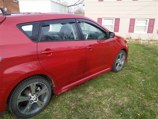

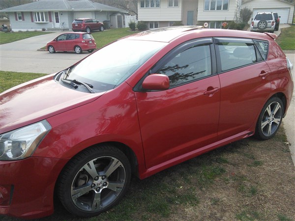

Installed window deflectors this afternoon. Thanks for the parts, Nancy (jazzvibe)!

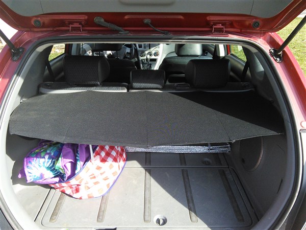

Also put in the cargo cover. Thanks again to Nancy (jazzvibe)!

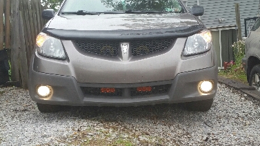

Did some mods with the fog lights and added some behind the scenes aftermarket fog lights....
As in the regular setup on the vibe, you can turn your regular fogs on, only after you switch on the headlights, but made the cut and now I can turn them on when I have my parking lights on only and of course with headlights on too....
The aftermarket fogs I drilled the holes on that square metal bracket behind the bumper (looks like a long square towel holder...lol) and got bolts long enough to fit thru the holes and hooked everything up.....currently I have 1 of the power wires hooked up to 1 of the headlight fuses but I think I might leave it alone...The aftermarket fogs definitely put out good light and got them on ebay for about $70.00 for the pair....
Forgot to mention that in the upper grill area, took out the factory horn and replaced it with the Hella Sharp Tone set M26s....Woooo Hooooo!!!!!

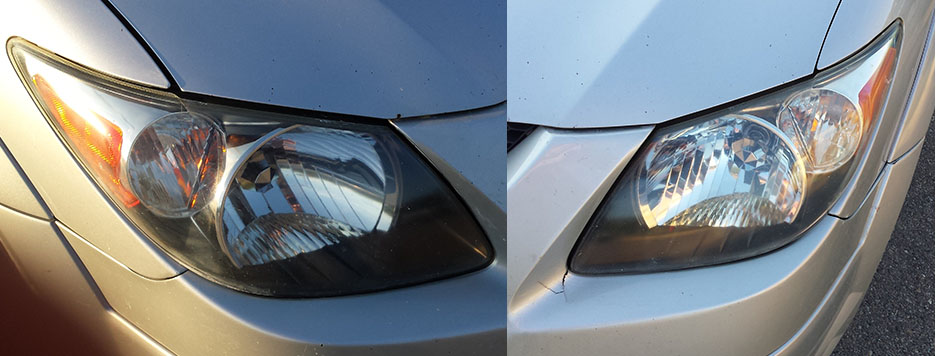

I also polished the headlights using a 3M headlight polishing cream. Mother swears by it, but although my headlights are more clear than before, when they're on at night I can still see the pits in the clear cover. So, sandpaper it is.

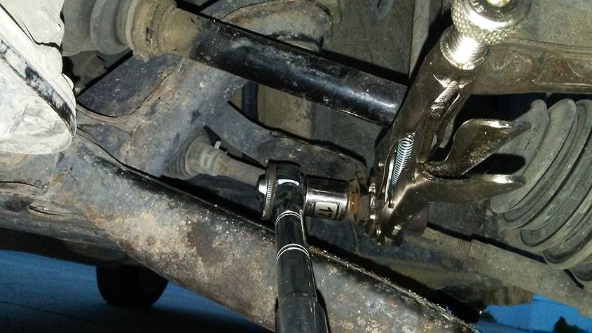

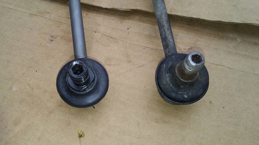

Also, anyone else have trouble getting stock front sway bars off? I feel like I'm likely not alone here.
I hear this noise up front, and everything feels tight except sway bar ball joints have boots completely torn open. Might as well replace them. I tend to replace them with one side lifted up at a time, this keeps the sway bar and link tight as I'm loosening nuts. Then I either lift the other side of the car to release sway bar tension, or lift up the steering knuckle on that side.

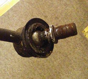

Well, on one side, the ball joint stud on the bottom was rusted to the sway bar end and hammer blows didn't seem to loosen it. I left the nut slightly loose on that one and drove it a short distance, it broke loose pretty fast. I tightened the nut back up until I could remove it properly.
The other side was worse. I'm sure everyone's had this problem where the ball joint and shaft rotate with the nut, and that allen key/hex key hole on the end of the shaft is worthless because it's rusted, right? Aftermarket sway bars have flats on the ball joint to put a wrench on, the stock one was perfectly round.
I ended up removing the entire rubber boot for it, using a small dremel tool to rough up and flatten the side of the ball joint shaft, and then put a vice grip wrench so tight on the shaft I almost had to use another wrench to close the vice grip. The nut finally came free, as shown in the second photo.

Sounds like an adventure on the ball joints. Often repairs go like that for me. Read the procedure, one small step that sounds easy doesn't go as planned, rummaging around the garage to try to match the tools I own to what might work. You solution was creative.

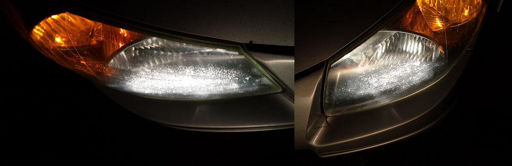

As I mentioned I recently tried using this 3M cream that my mother had on my own headlights. I think at best it removed the dust on the headlights. I hand rubbed it in, so maybe using power tools would have been more efficient?
Here's the headlights during the day. Clear and brand new, right?
Here's the same headlights at night. Still pitted. Nothing's changed.

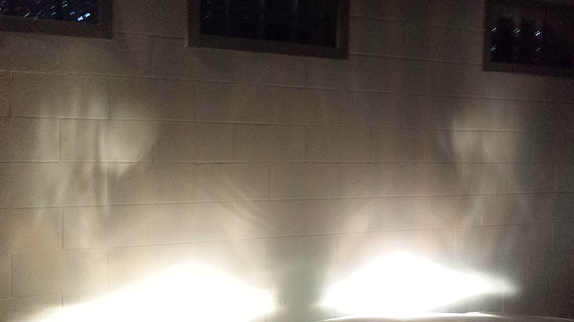

And, here's the headlight pattern on the side of my work's building. It never did that before. Sure I'm not smoking something, I'm seeing pretty sparkly lights!
Going to have to do a more in-depth polishing, maybe with sandpaper. Anyone here figure out a good way? I know I saw a thread where someone polished their lights with sandpaper.

[quote="bigdoug"]As I mentioned I recently tried using this 3M cream that my mother had on my own headlights. I think at best it removed the dust on the headlights. I hand rubbed it in, so maybe using power tools would have been more efficient?
I used the 3M to clear my headlights.The package comes with a 3000 sandpaper that you use with the 3M "rubbing compound". It did take a lot of haze out on my headlights but there is still some tiny pits in them even after treating them twice. Maybe someone has had better results with some other brand.

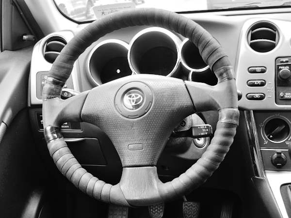

Bicycle handlebar tape:
2006 Matrix 5-sp
cptnsolo77
Posts: 1645
Post by cptnsolo77 »
That's a great idea ! Wouldn't have thought of that one 8-)
