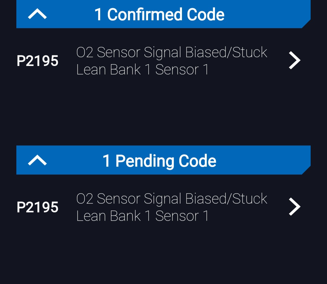

Well, the latest thing is that yesterday, for the first time since this all started, my check engine came back on with the info shown in the attached screenshot. The initial repair was for P0171 so this latest code is a bit different. This happened after taking a 40 minute drive, the longest since this started. Only one shop did a full diagnosis and he didn't find anything with the transmission. What's interesting is the surge stops when the MAF sensor isn't being used and yesterday when the check engine came on it says one or more o2 sensors might be faulty, yet the o2 sensors and MAF were all replaced with new Densos to try to fix this issue. Can it be something as simple as the connection being perhaps lose, corroded or such? Oh and as of the latest check engine it's not surging anymore or at least if it is it's not as much for me to notice.

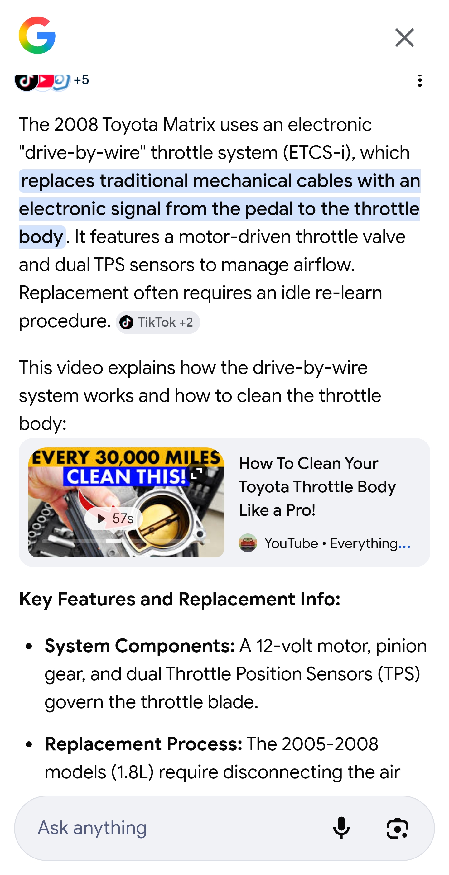

I jist asked a google Ai about drive by wire throttle system on our cars. I wonder if you have a poor commection to ykur throttle body.
As cars age the wires weaken. Corrosion can form and causes resistance which restricts current. Perhaps theres a way to perform a diagnostic between your gas pedal and throttle body. If you could measure the voltage of going to the throttle body while pressing the gas pedal with the engine running... make sure its in neutral. I suppose it should be receiving 12v all the time. A voltage drop occuring as the throttle body control flap is moving could indicate trouble.
The car is all computer controlled. Some weak signals between your gas pedal and throttle body may be causimg some glitchy behavior..
All that said, I'm really just taking some educated guesses.

vibedrivermatt wrote: ↑Sun Apr 26, 2026 3:09 pm Screenshot_20260426_185517_Chrome.jpg
I appreciate it. I'll run this by the new mechanic when I have the funds. I've been suspecting something purely electrical at this point, as everything else under the sun has been ruled out.
