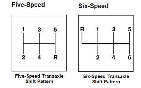

When you walk through the gears (say with engine off) which shift pattern matches your car? (ignore the diagram on the shift lever if you still have the one for the 5 speed)

Thanks for responding. When the engine is off, the shifter goes like the first pic you have (5 spd original). So, I’m just confused because there’s a stamp of c60 on the tranny casing when I bought it. What do think that happened or done wrong? Thanks again. 🙏🏼🙏🏼

Trix04 wrote: ↑Thu Apr 02, 2026 5:35 am Hi Joatmon,
Trix04
Just to confirm, reverse is to the right and down?
It sounds like you got a 5 speed, which might be best anyway. The 6 speed is geared lower with an extra intermediate gear to help the 2Z engine to rev high enough to hit lift more easily, but since it's geared lower, cruising down the highway the engine will rev higher than in a 5 sped, so there's be a small hit to gas mileage.
The 5 speeds in Vibes and I assume Matrixes also had a higher rate of bearing failures, but I haven't heard that continued into the later years, so an 07 5 speed might be more reliable than your original 04.
I know that Pontiac dropped the 2ZZ 6 speed Vibe GT in 2007, the last ones were 2006 models. It is likely that Toyota did the same thing, and perhaps there were no 2ZZ 6 speed Matrix XRS's. Doesn't explain how you got a 5 speed C60 out of an 07 Matrix though.

My question really is, the new tranny swap it has c60 stamp on the casing, but it is only shifted like 5 spd ( your first pic pattern). Do you think there’s something wrong during the installation since I don’t do it myself? Do I need to change the shifter mechanism inside the console with 6 spd one? That’s where I’m confused.
Thanks again.
Trix04
Re: Tranny swap 5 to 6 questions.
The shifter is free floating. It has two cables attached, effectively one that controls left to right, and another that controls forward and back, limited in movement only by the levers on the tranny. If the shifter was disconnected from the tranny, you could swing it in a circle.
There is nothing an installer could do to change a 6 speed to a 5 speed. It would require swapping a bunch of transmission internals, which, if possible, would be a ludicrous amount of parts and labor. Might be an interesting project for someone with too much time and money on their hands.
