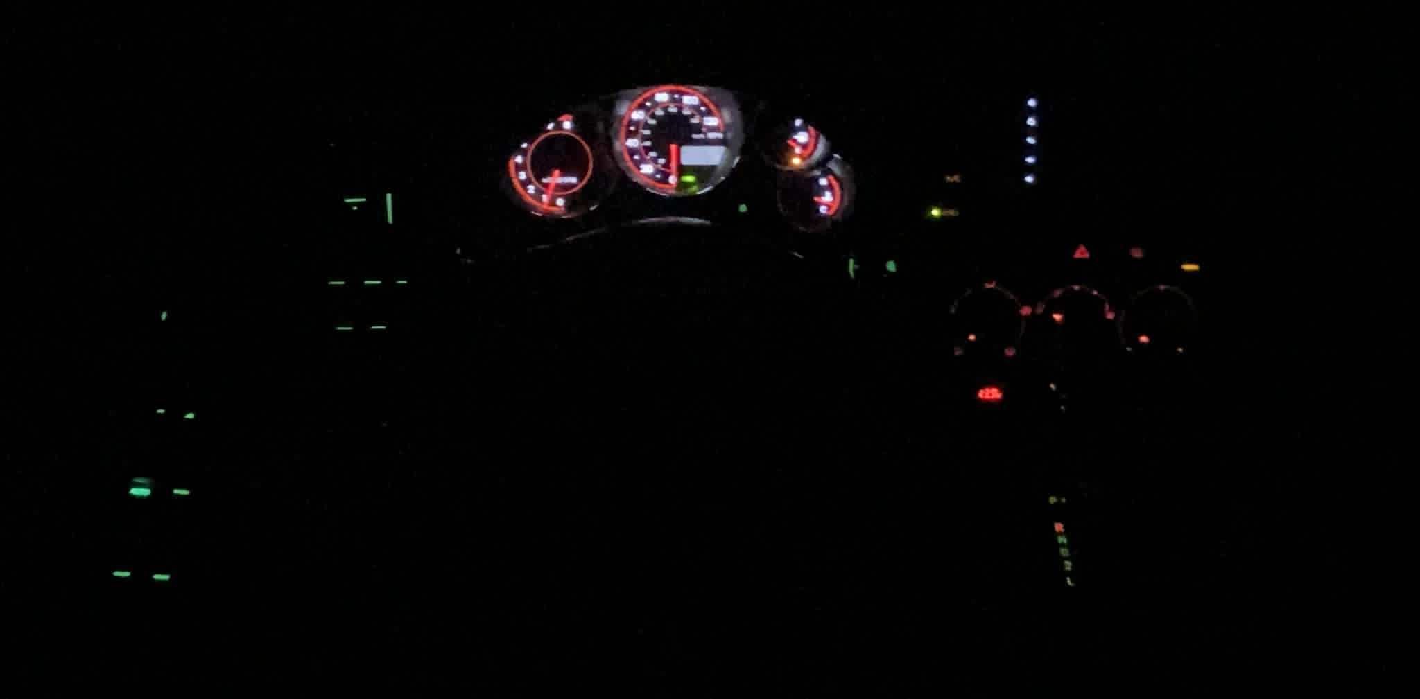

Here is a pic of an 04 cluster and an 03 cluster
The 05-08 are similar, but the wiring is somewhat different. You could make one work, all things are possible, but I wouldn't count on it being direct swap interchangeable.
If you swap clusters, then remember that the odometer reading is stored in a chip on the cluster. There are ways to deal with that, but that's a write up I've been putting off for several years.

the later cluster is quite an improvement over the red one you show, which looks exactly like mine. did you do the work yourself? you mention the odometer issue. for folks like me who are not exceptionally handy I would probably have the job done by an experienced mechanic. any ball park estimate on what the newer cluster cost, and any guess on how much a mechanic might charge for the work, including correctly calibrating the odometer?
thanks.

runningslow wrote:I've experienced the same thing with my '06. I at least have the revised version with the white numbers that are clearly visible, but I have a hard time distinguishing the increments between them in the bright sunlight. I might have to track down a second gauge cluster and experiment with swapping out the LEDs.
I think the newer cluster shown, compared to the red 2003 cluster which looks like mine is quite an improvement. I really like the way the odometer window shows up. on a sunny day I can't read mine at all.
I am totally unfamiliar with the innards of the instrumentation, save for the excellent pictures sent by forum members responding to this thread. my question is; how do you get to the led's. does this mean you would have to disassemble the speedometer, etc. to get to them? how big of a job is that?

If anyone is also having trouble seeing other things on the dash, I added some GITD lighting to assist seeing all the other buttons and things at night. Submitting this as a modification idea.. ;)
This is an old Porsche 911 trick they used on their door pulls. Glow in the dark tape.. Works great.
Night Lighting on Vibe Mods...jpg (21.53 KiB) Viewed 10251 times
