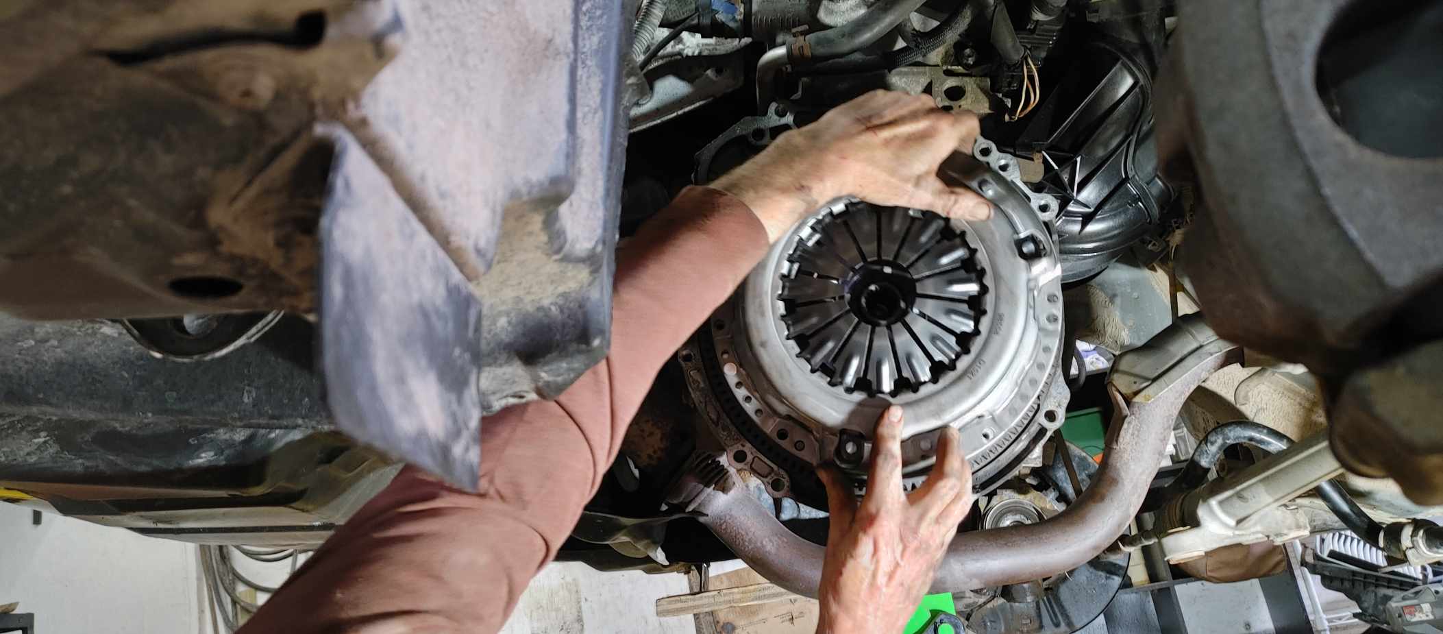

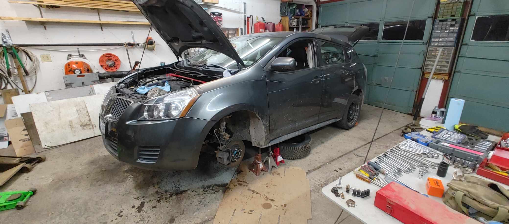

Hello, I found some pics from the clutch install we did on my 09 24.l vibe. This wasn't a fun. It's really tight underneath the 2.4l vibe. There's wasn't a lot of room for our wrenches. We also did this laying on our backs as it was a diy situation with stands stands. Heres the pics!
Jackstands
Jackstands

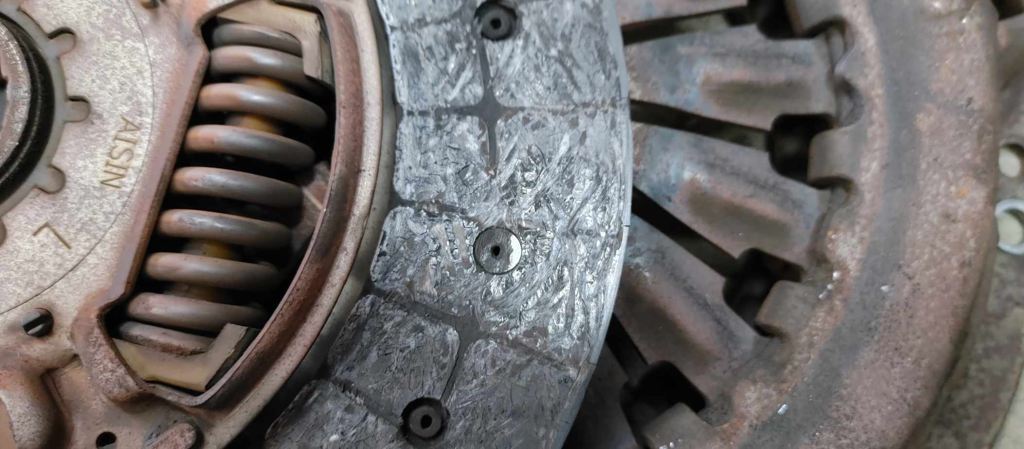

Here you can see my original clutch disk it was worn down to the rivets.

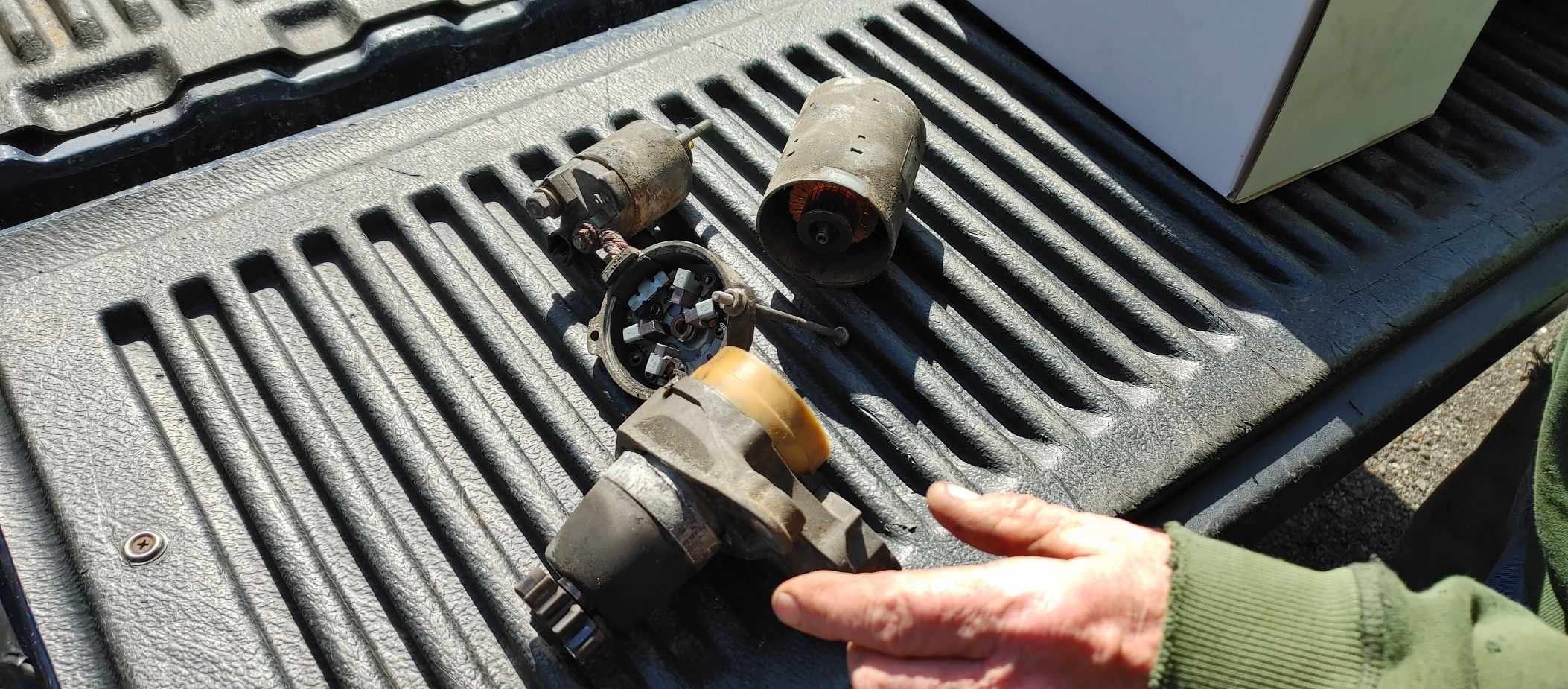

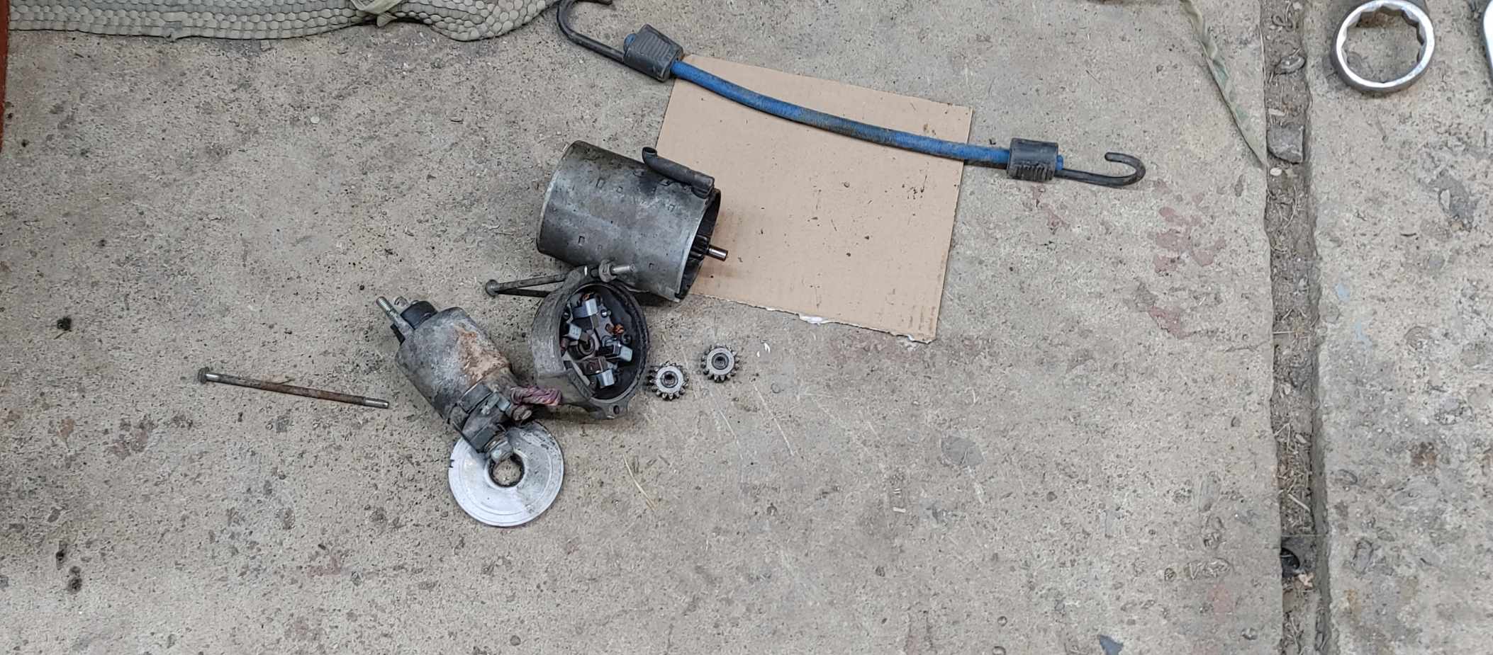

Right at the start we ran into issues. One of the first steps is to remove the starter. It was majorly frozen into the transmission case. We were prying at it and doing everything we could to get it out. It ended up coming out in chunks. We were nervous about cracking the tranmission case in our attempts to remove the starer.
If you ever change the starter on your vibe, I highly recommend to apply a layer of anti-seize where it mates into the transmission.
The starter on the 2.4l is designed with a rounded shape which is inserted into the transmission. Well, mine sure as heck didn't want to come out. We weren't able to fully remove it until the transmission was out of the car.
Chunks-o-starter
Chunks-o-starter

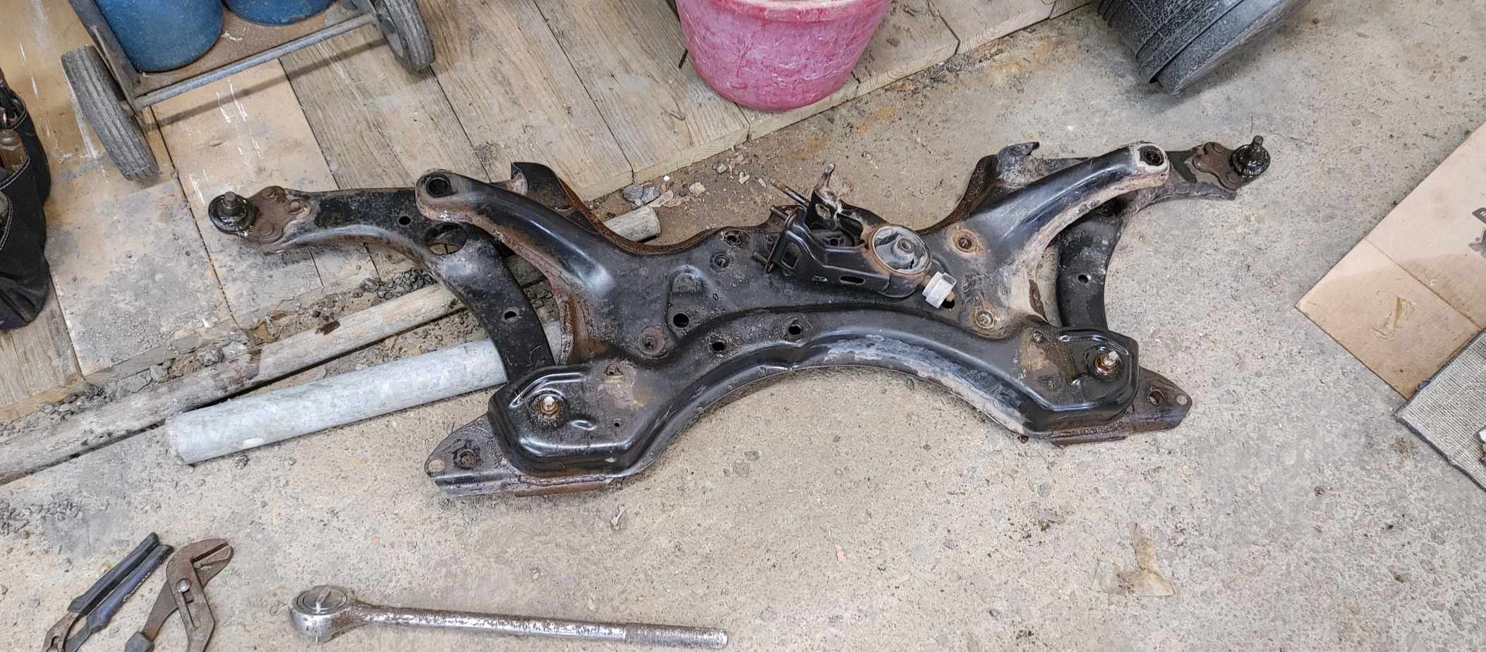

As you can see, this big subframe cross came off. We has to disconnect the steering rack from that. Fitting our wrenches under there was TOUGH..
One big ouchi occurred as we were removing the large bolts which hold the cross member to the bottom of the car. A large bolt near the wheel well snapped off into the frame of the car. :shock: I had the pleasure of snapping that one off myself. At this point I was pretty sure we could just send my car out to the junkyard.
My friend had to upside down weld a nut onto the broken off bolt. The heat probably loosened it too. Then he was able to back it out.. whew.
Out it goes!
Out it goes!

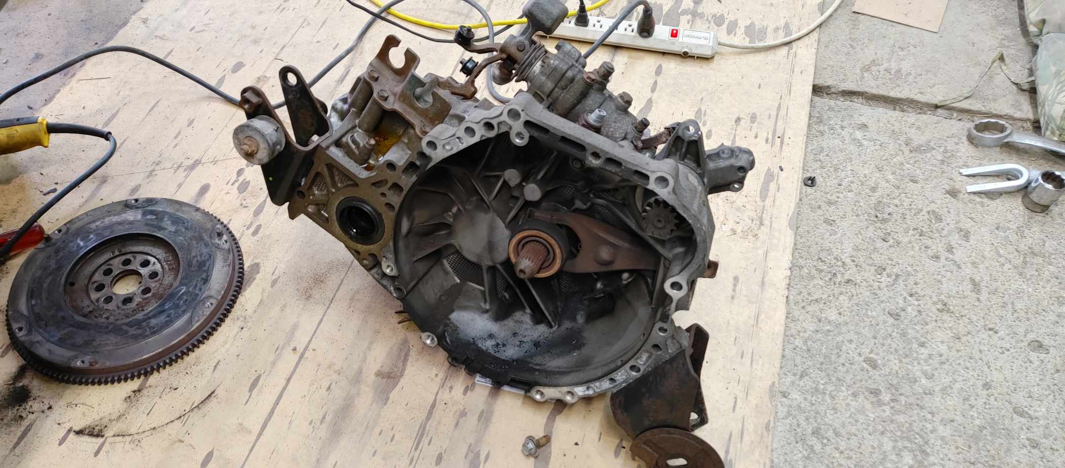

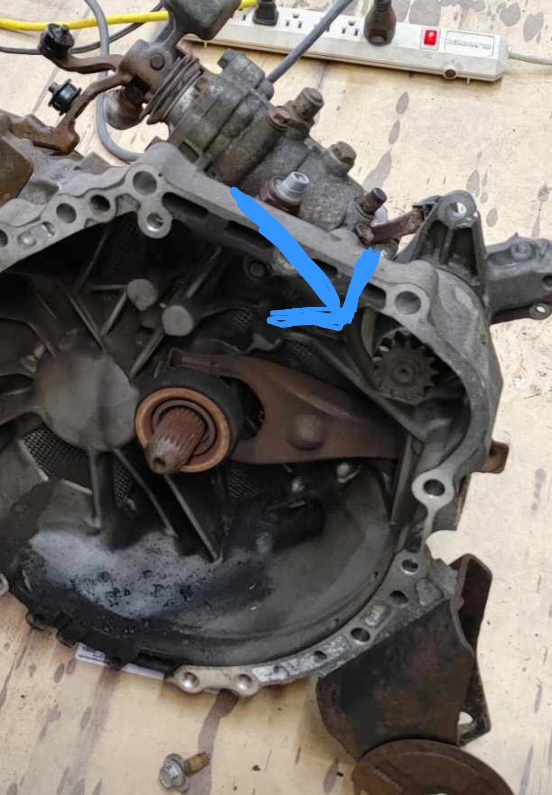

Here's closer pic of the transmission. There still one peice of the starter in there! We had to gently pop that out with a hammer.. I ordered a new starter off Amazon for $80.
Last chunk-o-starter

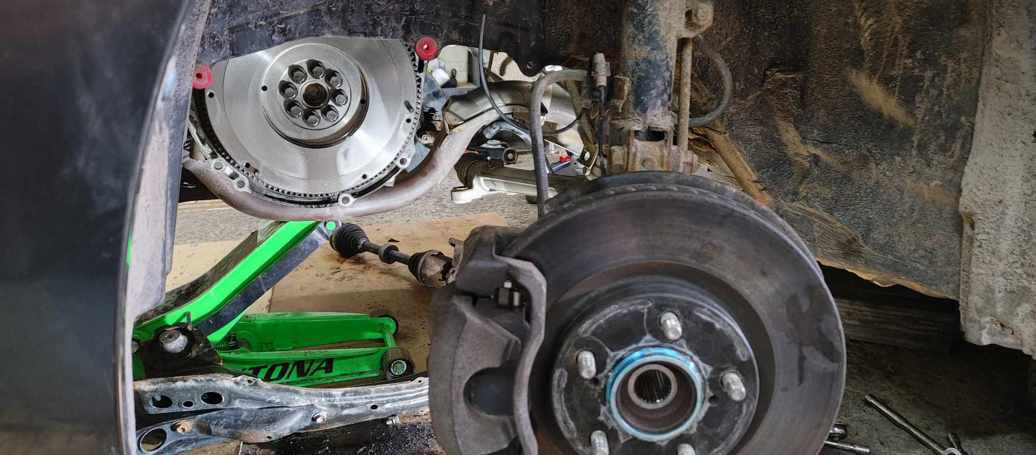

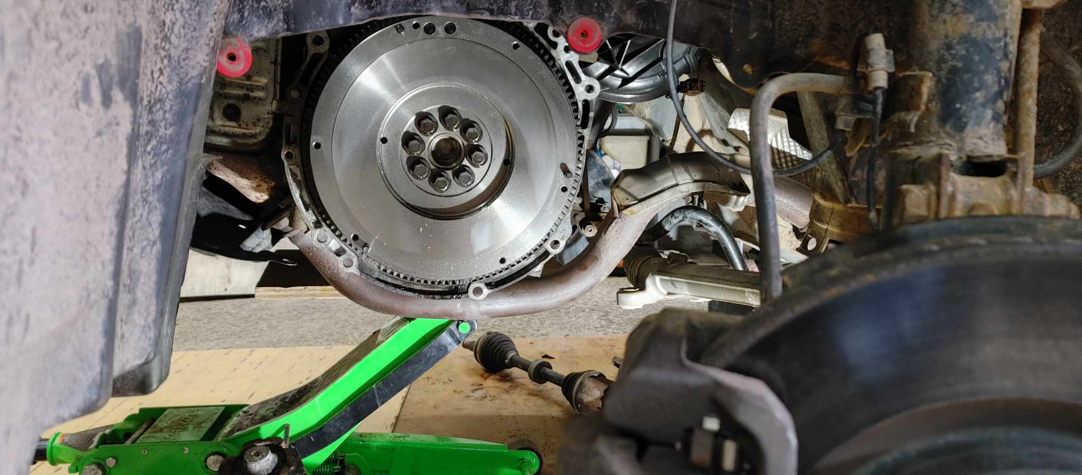

Things started going more in our favor at this point. Here's the new flywheel and pressure plate. I torqued the flywheel on nice and evenly with my electronic torque wrench and gave a good blast to brake clean to wipe the packaging residue off with a towel.
The one pic shows the green jack which we used to temporarily hold the engine up. Later I believe we supported it from above. I'm not remembering all the finer details. We did this a couple years ago.
I believe the cost for the parts was about $500 and for the job that was free as we did diy. I thought about replacing the rear main seal and even bought one.. we opted to leave the original in place.

The car is back to running great now. I'll finish off with pic of starter chunks. That was fun. :roll:
