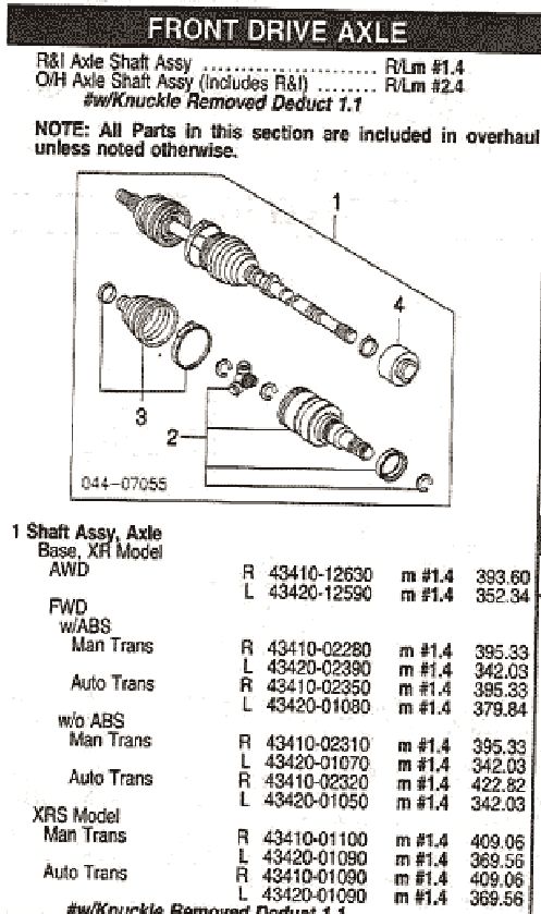

according to this excerpt from the 03 Matrix parts pdf
seems like the toyota part number is 43410-02320 but I don't know if toyota still stocks them

All I see is it is an obsolete number and I don't see any replacement numbers given or cross references, etc.
Same with the GM PN

I use this Toyota parts site: http://www.japan-parts.eu/toyota/us/200 ... ft/1#43410 and it agrees with the above.
