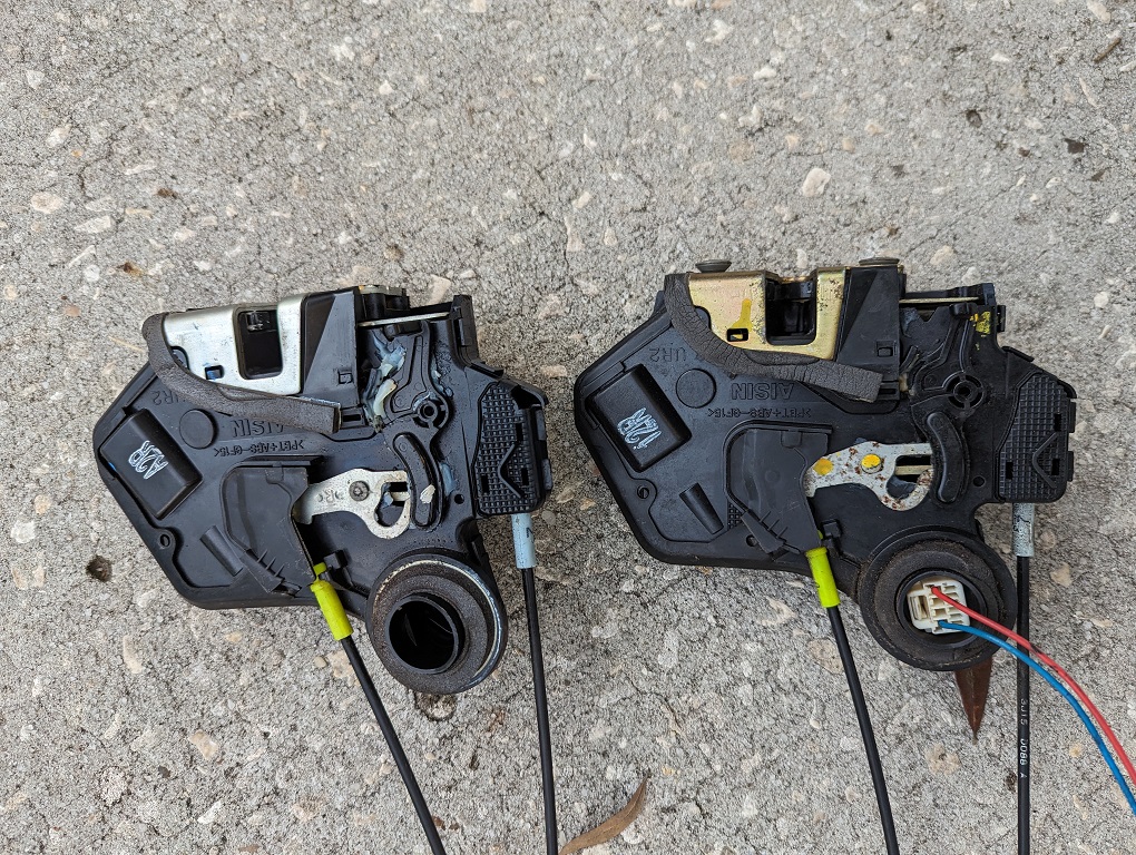

What I found out along the way and to be honest, I felt stupid for not realizing this before even starting: The OEM power door actuators WILL work with the kit!
After you install the driver side door actuator and the "brain" box as well as run the wires to the other 3 doors, you can install the power door lock actuators from a donor car and boom, you're done!
Installing these universal actuators is a PAIN because they are not rods but rather cables so you have to be careful, but this way you only need to do that with a single actuator, the rest is all plug and play.
