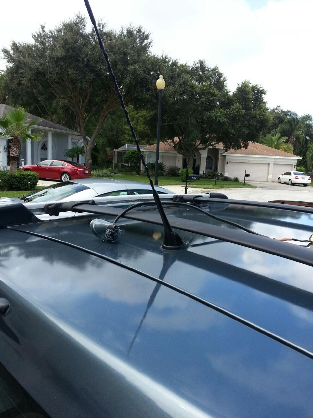

Ugh, sorry for bumping a 6 year old thread, I think I just broke my antenna base. Someone tried to steal my antenna but it was rusted on so they broke the antenna mast trying to unscrew and left this on the base (see pic) I tried to remove it but it wouldn't turn so I pulled it out. It is still stuck solid. How different is the base for the 2010 from the previous gen? The above instructions seem extremely confusing without photos. Did a search, but couldn't find anything. Has anyone tried this on a second gen? Any help or service manual pics would be very helpful. Not too happy right now..

Just going to leave a quick update on my broken antenna base. Had to get it done, the radio stations were simply impossible to listen to with constant interference of even small buildings and short tunnels.
Showed it to my mechanic when I was in for an oil change. Told me to buy a new base and bring it in. Picked up part number 19184460 $52.75 (which I was told has been discontinued) and brought it in. All I can say is it took my tech about 40-45 minutes start to finish. It is not as complicated as listed above as I watched the hole thing since he did outside the shop. The instructions above scared me away.
First off were the 2 button on the roof liner, he just pull down enough to see the nut holding the base to the roof. Then the rear courtesy light came off, with a plastic trim removal tool, 2 clips hold it together to pull down the roof liner even further down for more room. Then the trim panel, on the right rear quarter, 2 bolts holding the panel and grocery bag hooks to remove. Then pry off both trim parts top and bottom exposing the connector. He then removed the old base, plugged the new base into it's connector on the top of the quarter panel trim and bolted it down. The trickiest part was getting the nut that holds the base to grab and not cross thread, as there is not a lot of room to get proper grip and leverage, but eventually it hooked up. He then reattached and cleaned everything up and I now have my radio back.
